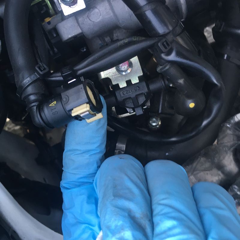

Started as a spark plug post; now down the rabbit hole we go
I tried the starter fluid, both in the air filter (where it just kind of poured out onto the garage floor) and more directly where the air feeds into the throttle body (?) by removing the hose. It did not start either way (it turned over as before).
Then, I think I found where the fuel hose leads into the throttle body. It had little white tabs, so I removed it (see photo). With it removed, I turned the ignition to run the fuel pump... Lots of gasoline (more than an ounce per second) came out - luckily I had a bottle ready to catch it. Is the fuel pump supposed to push out that much gas? I put the hose back on... It's not really a hose, but some plastic thingy with white tabs (I believe plastic thingy is the technical term). Anyway, once I re-assembled, I tried to start it again... Same deal - lots of turning over and no starting.
One poster said maybe my spark plug was cross-threaded, so I slowly took my spark plug out and then put it back in by hand. It seemed to go in nicely, so I'm hoping it's not cross-threaded.
I replaced the battery this weekend, so I thought I'd check to make sure I didn't get a faulty battery and bought a multimeter. If I can figure out how to use the multimeter, I'll test the battery tomorrow.
In terms of spark, does the "power" of the spark matter? I will check the battery (see above), but does the spark plug wire also need to be checked/replaced? I have visually confirmed spark, but I have no idea if the spark is adequate to fire the engine... How does that work?
Thanks again forum members. I've learned a lot, and I'm trying to look at this as a learning opportunity instead of lost riding time!

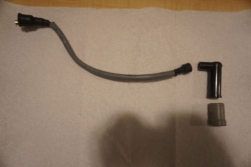

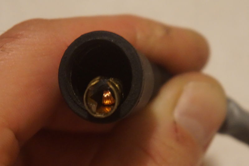

Update from September 5 @ 5:15pm EST - Battery is good and reading 12.8 at rest and 11.7 when trying to start. Next, I'm going to take Stromrider's suggestion to replace the spark plug cap/wire. When the scoot first started having the frequent starting issues, wiggling the spark plug cap could usually get it to start... Until it couldn't. Perhaps this is indicative of a problem with the cap/wire? I'm going to order from ScooterWest:
https://www.scooterwest.com/gts-spark-plug-wire-high-perfromance-080341r.html
Thanks again, forum members.
Posts: 45093
Posts: 45093
Not just indicative - it's confirmation!

Update and question from September 7 @ 5:15pm EST - The USPS misplaced the package sent from ScooterWest with the spark plug wire/cap. . I had it sent 2-day mail, but it never made it... USPS opened a case number, but I don't know when I'll have the parts. Question: Are these generic parts, or are they Vespa specific? If they are generic, can I get them someplace else? No Vespa dealers in CT (Vernon or New Haven) have them in stock...
@bluecloud avatar
2018 GTS Super
Posts: 2349
Location: Googleville
@bluecloud avatar
2018 GTS Super
Posts: 2349
Cap is nothing special, NGK branded part. When I ordered a new one from my multi-line local dealer parts guy offered one he had on hand from BMW parts bin. Pull it off the bike and see if a local shop can match it, auto parts store might even have it. Same for the wire.

He sprayed starter fluid into the intake and it did not start, this is NOT a fuel issue guys.
Ok, see that was figured out before I posted this.
But this is a reminder, don''t guess test. Much faster, easier and lees expensive.

OldSchooot wrote:
While waiting for the parts....might I suggest that you unscrew the spark plug cap from the wire lead. Then cut 1/4" of the lead for a fresh end, then rescrew cap back onto wire lead. See if that works for you?
Update and more question from September 8 @ 11:00pm EST - USPS called me. They said the parts were still in San Diego, but all they did was look up the tracking number, which I had already done. They were going to "put a BOLO"(?) into Springfield, MA.
I managed to get the wire and cap off without taking off the foot rest. It was a family affair, as my hands are gigantic and none-too-dextrous. See photos below. The wire connects to a black box near the battery; I think this black box is an ignition coil (or something) and not a voice recorder (like the "black box" on an airplane). I tried OldSchooot's suggestion and clipped of a portion of the wire lead and rescrewed the cap back on and then reassembled as best I could (see below). Still lots of cranking and no starting.
Of course, I do have questions. Without taking off the foot rest, it was not possible for me to crimp the non-spark plug end of the HT wire to the connection in the black box (ignition coil?). I got the fitting to slide on, and I pushed the plastic/rubber boot over it, but I have no idea if the connection is "good enough". For testing purposes, how "tight" must everything be? Do I need to crimp the wire fitting at the bottom of the lead to the ignition coil (see photo)? Or is contact enough for my testing purposes? I'm not putting the battery holder back on top of the battery. And I'm assuming the grey rubber spark plug boot (I think they come in green, too) is non-essential for testing. I don't put the HT wire through the clip harness that holds the HT wire to the frame. I'm assuming all that would be overkill. What do I need to do to make secure connections to ensure I'm testing everything appropriately?
Thanks again Vespa Forum.

For testing purposes, how secure must this fitting connecting the HT wire to the ignition coil be?
@jkj-fz6 avatar
Posts: 4561
@jkj-fz6 avatar
Posts: 4561
That looks good from here. The connector terminals just snap on to the spark plug and coil. They don't need to be crimped. You'll feel them click into place. And you shouldn't need to button everything up, just be sure any exposed wires don't touch anything.

Update and questions - 9/11/18 @ 6:00pm EST - I removed the fuel injector and mostly removed the throttle body (I'm not too clear on how to remove the throttle body from the "gas command fitting"). There was lots of gas and gas smell. With the throttle body and injector removed (and the cylinder head exposed), would this be a good time to spray some starting fluid directly in the cylinder head and see if it runs? Or is that a bad idea? Is there anything else I should attempt while everything is opened up?
Thanks again.

I don't have starting fluid, but I did try squirting 10 ml of petrol into the plug hole and then replacing the plug. Didn't work. But I don't know how quickly the petrol would have leaked past the rings while I was battling to refit the plug.
For your experiment I would have thought spraying the fluid in through the air filter while starting was a better bet, but I have no experience with the stuff.
