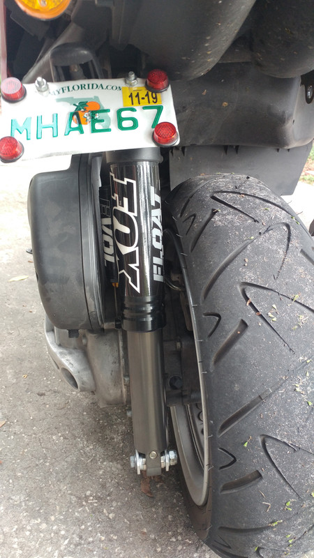

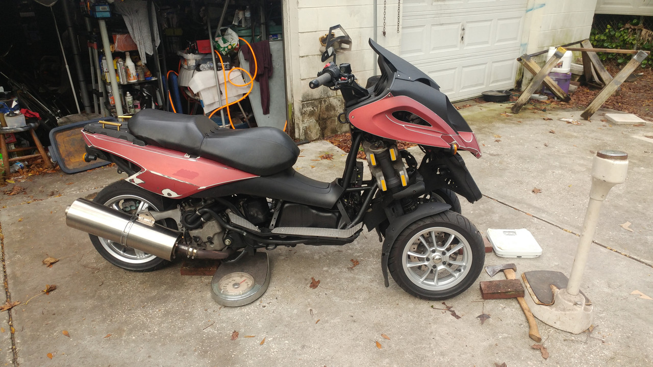

Mon, 23 Dec 2019 19:12:01 +0000 quote
I started with 90/55 psi (evol/main) and rebound at 10 clicks (middle)
It road stiff but after first few times lowering air pressure I was hopeful I could get by with just making more adjustments. but after a dozen such adjustments I realize I will indeed need to re-valve internally. I ended with 60/30 psi and rebound on its fastest setting. in about 80% of circumstances it rides about like the stock shocks. where it gets really stiff is when tire returns to ground quickly. like when driving slowly off two inch drop. second to that shock progression is much faster than the stock shock. on both ends. it starts out much softer, but with shock travel it progresses to stiffer than stock much faster than the stock shock. no fear I will get exactly the shock I am after with valving changes.
ride height. stocks shocks at 16 in. fox at 17 I figured I would need to drop my mount another inch. turns out ride height dropped two inches. and I already had one inch. so I am three inches lower than stock. love the lowered look, love being able flat foot finally, love new seat comfort. but there is huge problem with all that. head tube angle changes and I dont like the effect. steering response is more relaxed, too relaxed for me. and I also scrape over steep speed bumps where there was none before. so I will need to make final mount with less drop,
love the new look, so much cleaner looking. so much easier to wash rear wheel. cant go back to dual shocks, no way jose.
how to weigh an mp3. results 118 +122 + 240
update: made a bracket pattern to raise shock by 1.5 inches. but weather was too nice and went for a ride instead of cutting new bracket. it didnt take much ride time before I realized the benefits of relaxed steering angle. the biggest being a slow speed maneuvers are easier to execute especially a dead slow uturn is literally ten times easier. gotta say I could quite easily get used to this ride height.

still rockin my mp3. I did try the 110 tires on the front. didnt like them at first. made the bike ride firmer. but compensated by running less tire pressure. bike drives amazing. added new kickstand. the original stand wasnt welded at correct angle. so someimes the stand wouldnt lock. the hammer works great. if I forget to retract it does so automatically. and it locks every time now.

picked up a $300 project bike. this bike will be a serious naked effort. how light can I make it? I have been staring at my current mp3 and ask how can I shave another 75lbs off the bike? the answer was dont ruin this bike, start with one that can be operated on.
the plan. chop frame as much as possible. goal is 420lbs wet. lets see if It can get there.
