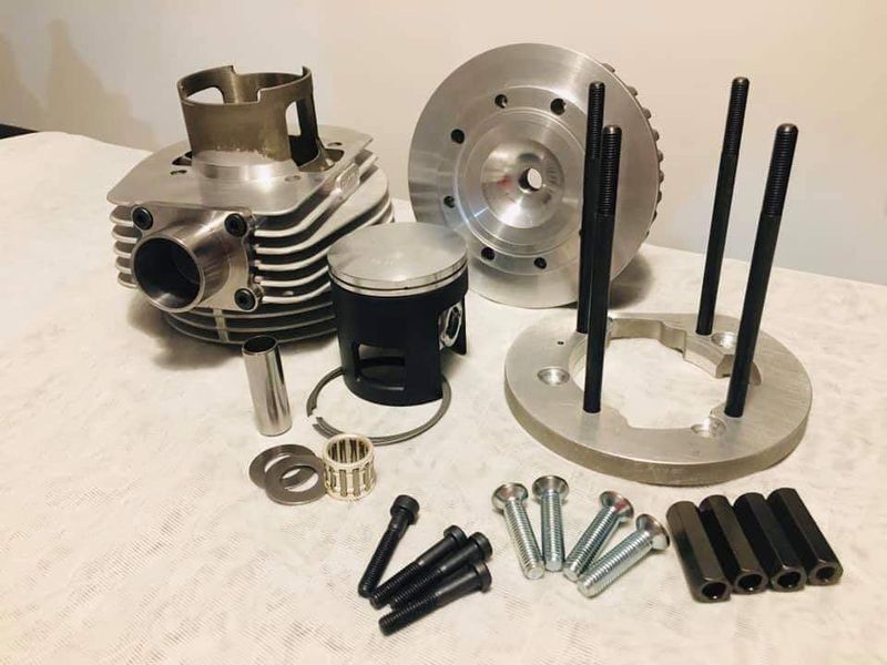

How about this?? A "newish" VMC 177 kit for the 200 cases...
Wow, that's weird. More info Chrys?

Struggling to see the benefit of that 177 kit for a 200. Ok, better crank and inlet and longer conrod, but why not just use a 210/221/215/225 kit if you have 200 cases?

I received a reply from http://www.avotecnica.com/ they recommend the aluminum due to shipping weight of cast iron to the US.
2 kit Stelvio alluminium, fusion head, 470 euros delivery included (NO VAT)
5 kit Stelvio alluminium, fusion head, 1070 euros delivery included (NO VAT)
$520.47 / 2 = $260.24 each US$
$1184.89 / 5 = $236.98 each US$
Shipping using a medium size USPS box is $15.00, even if I bought 5 to reduce shipping costs from a single unit, I would have to resell them for $252.00 to break even. That's a lot of work to save $40.00, if I bought one and paid full shipping.

Jimmyrs250 wrote:
I have this kit in aluminum with long stroke 187cc. Over a year now runs perfectly
Hello, i have the same setup , can i know what is your jetting?

Yes, i had ported the case. My setup is
VMC 177 SuperG
60mm Stroke Mazzi Crank
24/24E with 2mm drilled Passage
Main Gear - Cluth DRT 23 - Stock 68 tooth
BGM Fast Flow
Scootopia SR150 Big Box (i have a Malossi Pipe waiting his turn to be mount after a get the jetting right)
Currently using Idle 55/160 , screw 2.75 turns out , Main Stack AC140/BE3/Mj120 and i feel a little bog between 1/4 to half throttle. I didn't WOT yet. Spark plug is Just black
VMC 177 SuperG
BGM Fast Flow
Currently using Idle 55/160 , screw 2.75 turns out , Main Stack 140/BE3/120 and i feel a little bog between 1/4 to half throttle. I didn't WOT yet. Spark plug is Just black
I would think you are in the ballpark with your 140.
VMC 177 SuperG
BGM Fast Flow
I would be concerned that the hole in the float bowl at 2mm may be restricting a 140 main jet. To test this - you can put in a much larger jet - like a 150 or larger - and make sure that you can feel a lot of change at wide open throttle. There should be a size of main jet that is just so rich it is gurgling and wont rev out. This means your main jet is controlling the richness - not the 2mm hole.
Hmmm. CM - What should the carb (any carb for that matter) be drilled out to? I've been drilling mine (20/20's and 24/24s) to 2.0mm. What you're saying is questioning why I didn't go bigger..
it's AC140 - BE3 - MJ120 .... I'd changed the Air Corrector to 160 today. It's feels better. Now Main stack is AC160-BE3-MJ120 , Idle 55/160 Screw 2 1/2 turns out. Sparkplug still Black. I have another idle jet 45/140 but i don't know if is too lean to use it because i'm on Break-In period

Mendoza, can you post up a photo of your plug? Are you inspecting the plug after normal shut down or when at high RPM shut down?
The trend seems to be moving towards smaller air corrector to keep the WOT mixture as rich as possible I'm using a 120AC.
Next step is to find the sputter point with the main jet, find the largest main jet that causes sputter basically from 1/4 throttle then back down from there.
Once you have that somewhat good then fine tuning with atomiser and pilot jet.

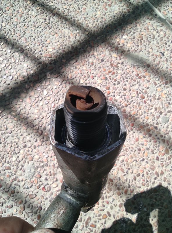

Tue, 29 Dec 2020 14:48:35 +0000 quote
Hmm
Is that a long reach spark plug? Is long reach plug required? What is the heat rating? What is your timing?
Plug looks as you described. How many miles are on the plug?
What is the squish gap?
Need to know what size main jet floods out and will not run clean. On my Pinasco 190cc seems 132 main jet is that point it can not pull past the sputter so I know this is the ceiling. I am currently testing with a 120AC-BE4-128MJ.
I started with BE3 atomiser then BE5 then BE4 to richen up the mid range.
Will need some plug chops at higher RPM to see plug condition.

Tis a puzzlement. That plug reads very rich but I don't think your jetting is rich at all for a 187. Might even be a bit lean. Only things I can think of are the spark plug might be too cold or you might be sucking some oil from the gearbox.

Tue, 29 Dec 2020 16:41:20 +0000 quote
hibbert wrote:
Hmm
VMC recommend B9ES, this one is B8ES, little hotter than B9. Timing is set @ 18°.
100 miles with this new Cylinder. Plug was used. I can put it a new one B8ES.
Temps here is around 26-30°C.
Squish is 1.5mm (VMC recommends 1.8mm)
Right now i'm with AC140-BE3-MJ120, and has a little bog trying WOT at 3rd. I didnt full WOT yet. Cylinder has only 80-100 Miles on it, maybe less than that. Today i change the idle jet from 55/160 to 45/140. I'll see the plug with a short ride on it

Tue, 29 Dec 2020 16:52:25 +0000 quote
Hi, sucking oil is discarted because everything was check when the case was splitted to Port.
I'm a little scared because i'm has seen people here with similar setups using mj125 or bigger.
This is the plug now with Idle Jet 45/140 , screw 3 turns out. My Exhaust is an Malossi Pipe

Tue, 29 Dec 2020 16:54:36 +0000 quote
Get a new plug in pronto so you can evaluate the new set up. 8 should be OK for now not sure on temp value until jetting is better. I don't see the crush washer are you using a CHT temp ring?
1.5mm seems good for squish.
Suggest richen up the main jet until you find the sputter, 120mj might be a bit weak looking at your porting and build spec. You need to know where that is, where is it?
Positive engine has no leaks? Port on fly side next to cylinder stud looks skinny.

I'm new with this "Art of Tunning" and i'm still confused with things like how is a sputter at wot or similar
https://youtu.be/fukhONP7z_U
I attached some plug pics after that ride. Normal shutdown.
⚠️ Last edited by mendozaram on Sat, 09 Jan 2021 20:54:42 +0000; edited 1 time
Sat, 09 Jan 2021 20:02:26 +0000
2005 Stellalossi 177 Fe
Joined: Sun, 14 Jun 2020 12:29:04 +0000
Posts: 415
Location: MA
Posts: 415
Location: MA
Sat, 09 Jan 2021 20:02:26 +0000 quote
mendozaram wrote:
Hello everyone. I'm waiting a set of Main jet but that will take a month. Right now i'm on IJ 55/160 2.25 turns out , Main Stack AC140 - E3 - MJ (Something between 120 & 130) remember i had to drill some MJ to test because is hard to find jets here in My country. I'd recorded a vídeo , let me read your comments about it.
I'm new with this tune art and i'm still confused with things like how is a sputter at wot or similar
Plug looks perfect. The video sounds good too, except you can hear splutter at WOT, so your main stack is rich.
Plan A would be to try a smaller main jet. In your case, though, you don't really know what you have now and it's hard to get more.
Plan B would be to try your AC160. That probably will get rid of the splutter, but needs to be monitored carefully to ensure it isn't so lean the motor overheats and seizes.
Plan C would be to try your BE3 mixer. That will make things a little leaner at WOT, but mostly it will make things leaner in the midrange, which may not be what you want.
I would order several main jets between 120 and 130 and then, carefully, go with Plan B until they are delivered.
