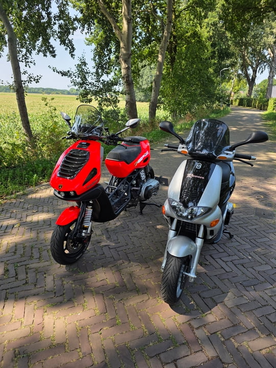

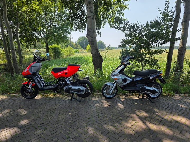

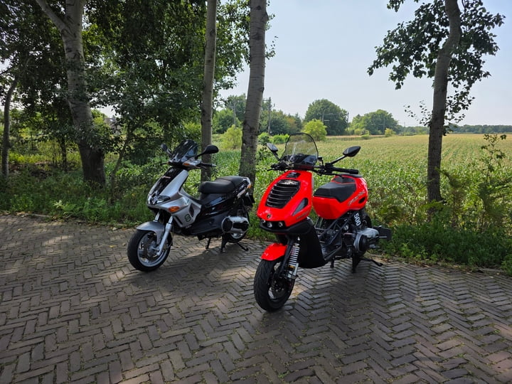

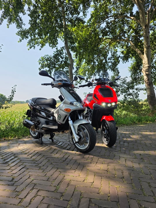

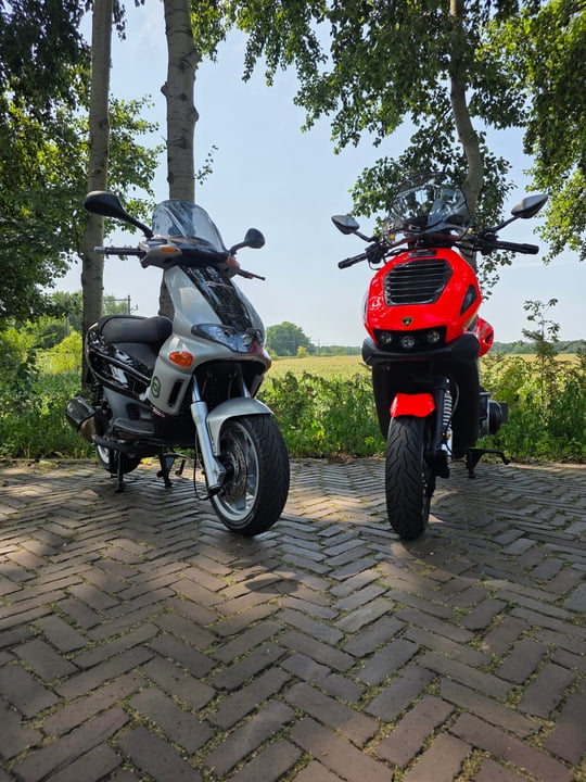

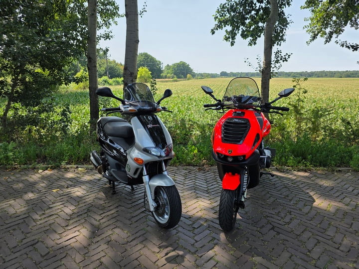

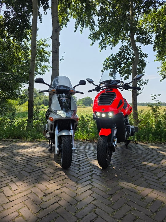

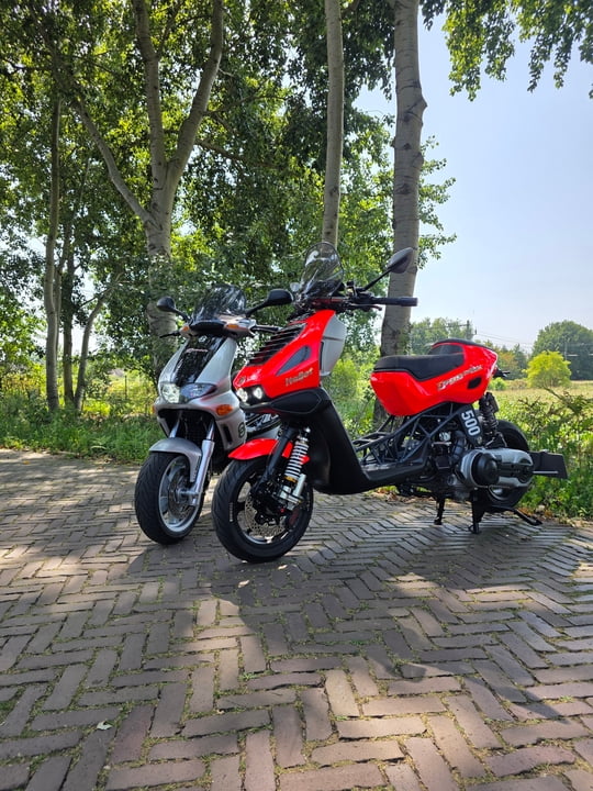

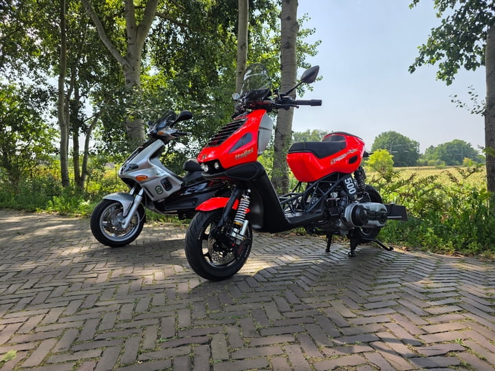

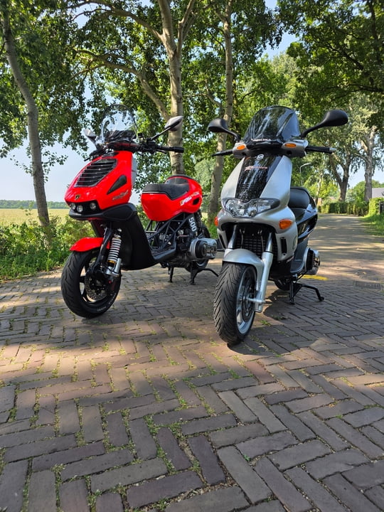

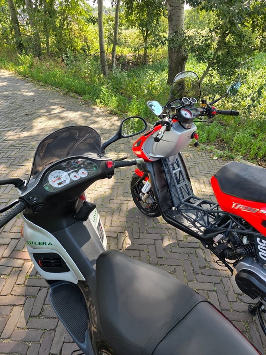

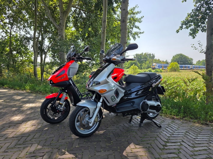

Today i had a meet and greet with a guy who built a road legal Italjet Dragster 500cc.
It suits him well!
Posts: 1004
Location: tampa
Posts: 1004
Location: tampa
I find it interesting the dragster 500 also abandoned the dragster front end. And if you ever driven one you would know why. Anti dive, oh yes. But also anti steer. I drove mine last week and just couldnt wait to get back on a bike with a real front suspension. The chassis just drives crappy. Even with Bitubos F/R.
