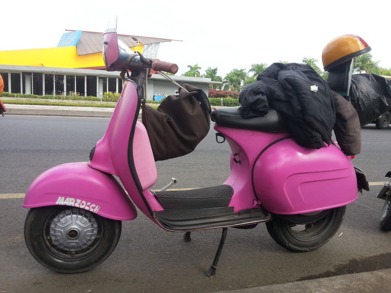

i like you mate, well i like everyone here as well so here's a inspiration.. dont tell folks i did this
it has the 12 inchi conversion rims by ebeth in the back
its not a gs 160 like ur, its.... what the hell just said its ebeth custum pink vespa
in case u wanna add a disc here's a what maybe look alike, and yes i use a p series engine in there
good luck with the bike and cheer mate
