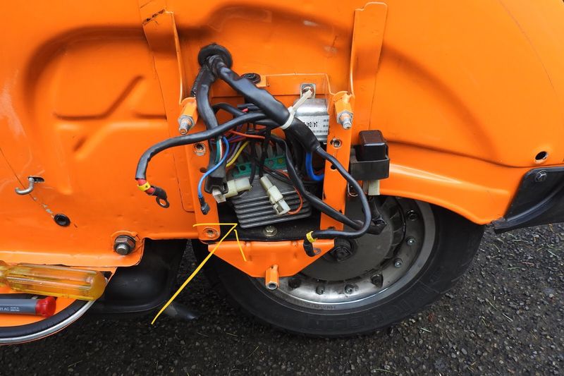

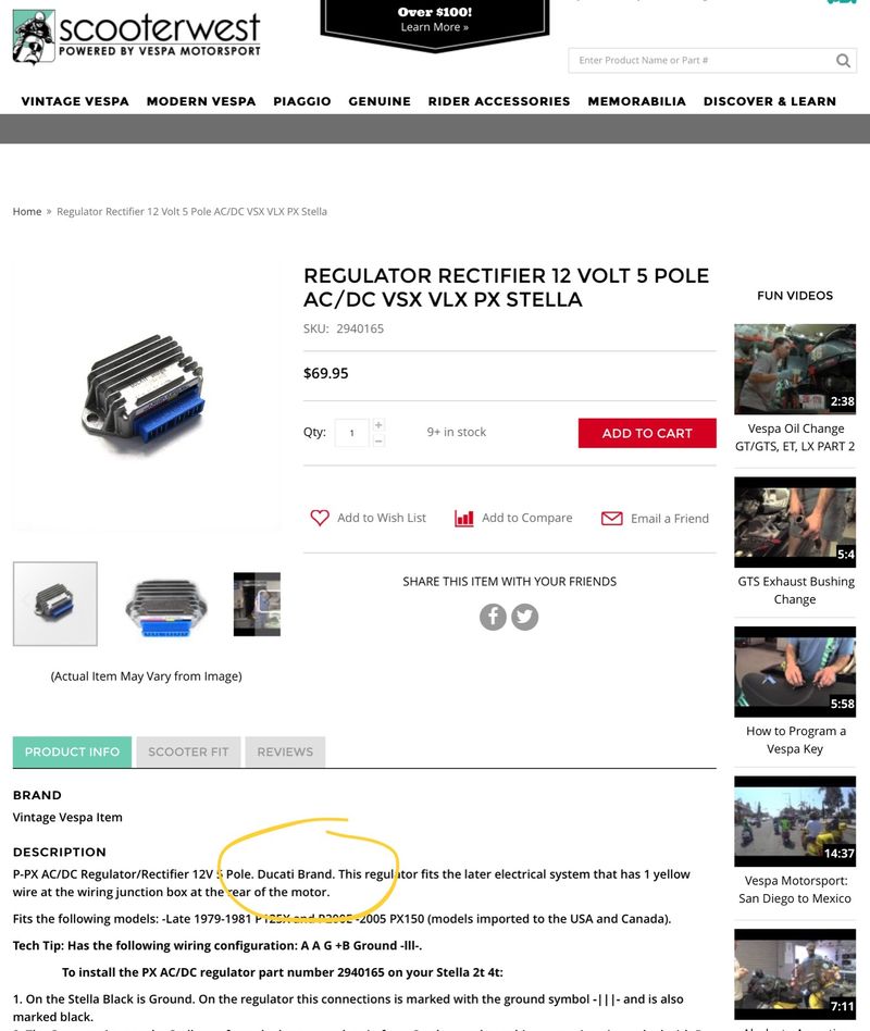

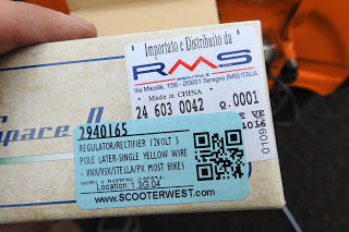

I replaced the regulator and now everything is back to normal.
I ordered a "Ducati" brand from Scooterwest and received an "RMS" brand made in China! No time to send it back - I need to get back on the road....
This was fairly easy to do after reading the instructions.
Her's some pics:

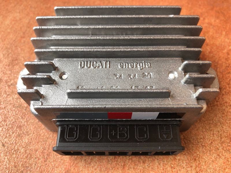

fishFingers: RMS is meh. I hope your regulator lasts but from experience that wasn't the case when a customer wanted something cheap (they go for 25EUR here). Ducati ones go for 55EUR...
waspmike wrote:
I doubt Ducati ever made their own although they did start as an electrical component manufacturer.
Would have been Magneti Marelli or .....
Ducati Energia is a subsidiary of the Ducati Group. They also have their own huge, "Ducati Energia Group". They build their stuff inhouse. Piaggio has stopped buying many of their regulators (especially for the P/PX series) and they have turned to the shitty Chinese (Kokusan) & Indian (Swiss) manufacturers.
https://www.ducatienergia.com/index.php?lang=en
My "supplier guy" buys directly from Ducati so we are still lucky to have quality electronic spares...
Not only did they send you a cheaper version of a reg/rec, I believe they've sent you the wrong type. Have you checked your battery charging with it fitted?

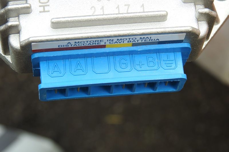

You know, this was also bugging me. Usually the regulators with the A-A terminals are for "floating" type of stators. The OP though is in the US so maybe their electrical circuit is also different...
That's correct it works with isolated charging coils.
However, the description of wiring it, to the Stella on the scooterwest site, suggests that they don't know how this reg/rec works
