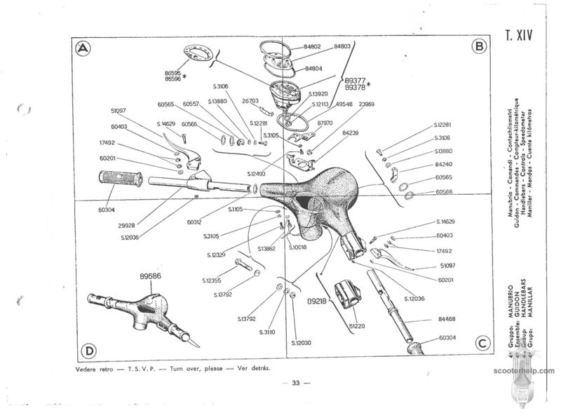

What Gick said. Item S12281 is the bolt.

Rowdyc where did you get that exploded diagram? I have the Haynes manual but it is not a detailed as this diagram
Thanks
Thanks
Scooter Help
http://www.scooterhelp.com/serial/VBB.parts.book.html

Thank you - just what I have been looking for
