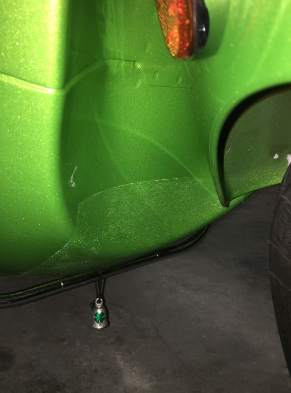

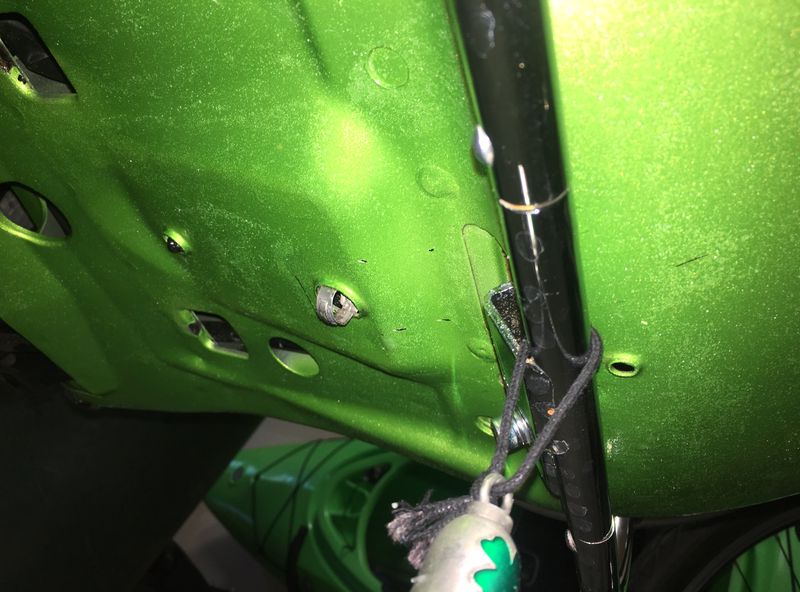

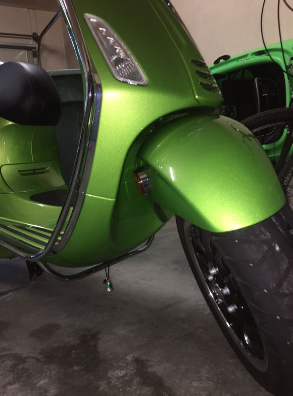

I see images online of Vespa rust on the underside. My sprint is 6 months old and I can see where scratches from pebbles and such would eventually wear at the under side. I was going to get a mud guard on the front to help prevent that but i couldn't pull the trigger. Instead I got a small roller and a couple brushes and painted the underside of my vespa with clear truck bed liner. I was afraid it would look awful but I don't think its bad at all. It was easy to do. I'm wondering if I should have painted any higher in the front? I took off the floorboard and its very tight in that compartment. I'm wondering if I should pull out the battery holder and paint the inside? Hope it looks good several years from now. Thoughts?

What a good idea. Wasn't aware there was such a thing as clear bed liner. Is it 2 part catalyzed?

Nope
Just one can. Stir and roll it on. Two coats. I also used a brush around my chrome. Had to be careful. It is textured and looks best when rolled. I hardly used any of the can. They also sell spray cans but I didn't have a shop to elevated the front end for spraying. It was simple to roll out. Can't roll it over and over and over. As it dries, extra rolling creates cotton candy little wisps of fiber that fall off.

That looks like good stuff, I've never heard of it either but I'm in the UK so maybe it's not around here. A front mud flap is a great idea, I had one on my Vespa GTS and it does stop a lot of crud hitting the paint, plus it said VESPA on it!

Looks Great
I'm hoping it lasts years but time will tell. Seems to be tough stuff. I'm not very handy at all and I had no issues. If I can do it ... . Still wondering if I should pull the battery and battery holder so I can do the inside. Its very tight in there on my 150 sprint. I pulled all the rubber plugs from the bottom of the scoot before applying the bed liner. I didn't want to roll over them and cement them in. Its cold in my garage. Its been a few days. I just put a hair dryer on the rubber bits to warm them up and popped them back in. No problems there either. Looks good.
