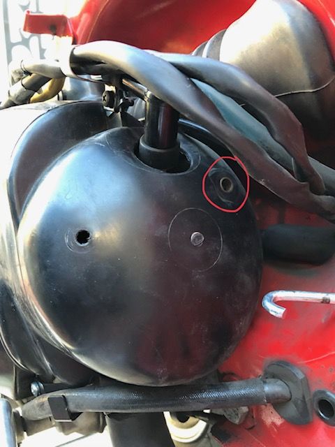

The hole in the airbox would concern me, because these things are sensitive to too much air, and that can make it seize.

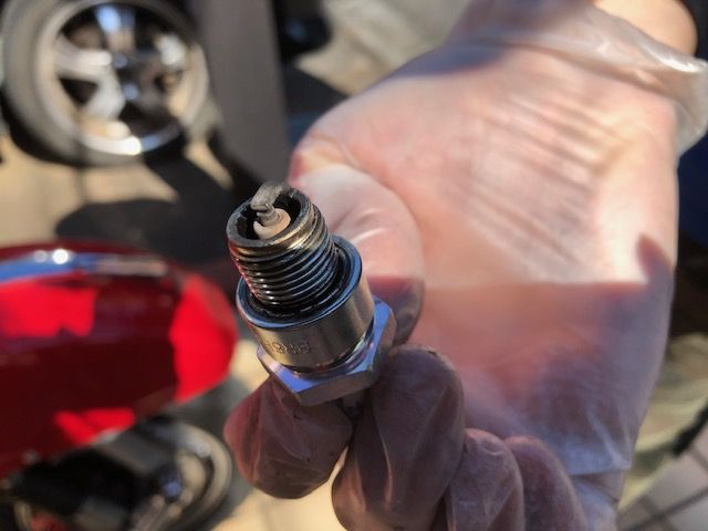

Since my last post, my PX had stalled 2 times. The last time it didn't want to start at all, so I checked the plug & was covered in oil? fuel? Anyway, I cleaned, installed it back and ran it for 2 days (50km) I took it out and took a picture yesterday.
too lean? rich? optimal? The new plug they installed for me is NGK R BR6HS
Oh and this morning it stalled again when I was warming it up for a minute or two. You can hear the plug just soaked and he said I dont need to warm up any 2 stroke engines. Just start, listen to the idle to calm and ride....is that true? I thought you need to warm up everything?!! Even my wife needs warm-up!!

Hey Nicky - Welcome to the forum, and nice ride! I look at it this way. Going from 125cc to 166cc and better exhaust is going to need more air and fuel, because its going to burn more air and fuel, and output more exhaust. Input-Process-Output. They all work together.
So for the Input (carb) and the Process (combustion chamber & spark plug) you have control over. The trick is to set up the idle jet and the main jet stack to allow the optimal air and fuel into the combustion chamber.
If you can pull the spark plug, you can check out the jets you're running. I don't know anything about your kit but a quick google search of "vespa jetting for 166" pulled up all kinds of sweet information, like this thread: Jetting and timing a Malossi 166 on a p125x.

The holes drilled in the air filter are there to allow greater airflow through the jets. More air - more fuel needed.

Thanks guys. I opened up the airbox and looked at the tiny 96 main jet and 20/20 carb, put everything back together. All to the help of some great advices here and hours on Youtube.

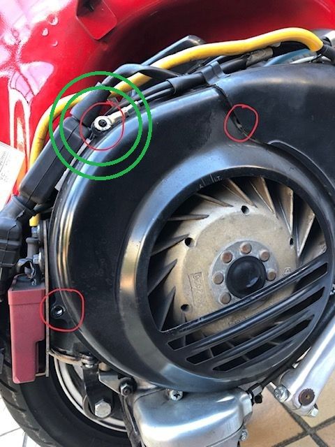

Another surprised I found today was when I opened up a few things, I noticed their mechanic missed putting back a few screws.... WTF!!!

Man, that's not right
Until you screw the ground wire (green circles) to the engine, DON'T use your starter. Because the starter is now not properly grounded, it now draws a lot of amps through the stator and it's harness. This could result to the wires melting or even catch fire...
