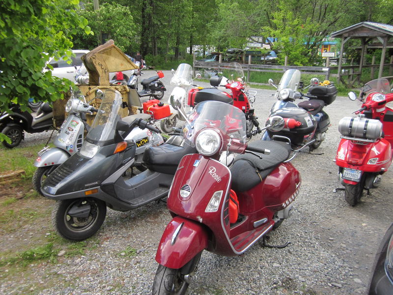

Try searching the site for "auxiliary tank". Many folk who do longer rides just have a spare plastic tank on the foot board - you can actually buy stands for them to make it safer. The problem with having the tank right at the back is it's a bad place to place weight and, if it's connected to your fuel line, some joker might cut it for a laugh. The cannonball riders do some interesting things to let them ride further. Me, I'm quite happy to stop and stretch my legs when the fuel gets low.

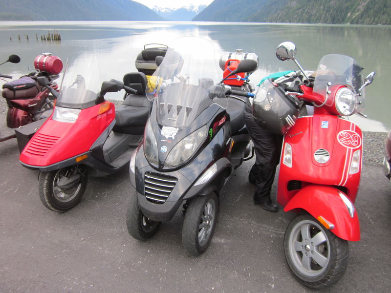

Several riders in the Cannonball use auxiliary tanks.
Here you can see a few in these photos from Hyder, Alaska at the start of the 2014 Run.
Bill

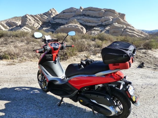

A while ago gogogordy posted a pic of his BV350 with a Rotopax tank on the back rack.

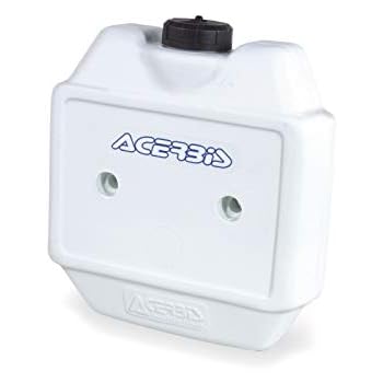

Acerbis makes an auxilliary fuel tank for motorcycles.
They come with a siphon kit that can connect to the fuel overflow.
As the fuel tank empties, the fuel runs through into the tank.
Just mount it in a suitable position close to the rear filler.

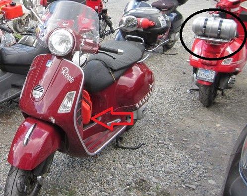

Personally, I would go the route of the tank secured to the floor panel over the battery (red arrow) as the large, high and far back position of the aluminum tanks (black oval) will change the handling characteristics a lot. Having the fuel can available means you could help your riding buddy who runs out. Notice also the extra MSN fuel bottle at the top case for that last pint of fuel...
