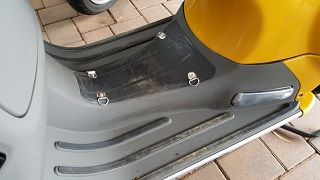

I have been looking for a rack to secure small luggage items in Sunny's foot well (my GTS) but all the standard options are costly, especially for South Africans.
So in typical Saffer character, I went looking for something else I could use instead... lo and behold - a POORATECH solution to the problem...
Four slightly longer screws and four stainless steel D-ring clamps.
Total cost... around US$5.
With minimal inconvenience I can use it to double the range on my GTS for my upcoming trip.

So do you attach a bungee cord to connect to the D-rings?
Bungee cords tend to come in two lengths...
too short and too long!
I use ROK straps - a combination of adjustable straps with a bungee end.
Otherwise I just use straps or nylon chord.

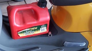

Not a new idea, I tried it on one of our scoots before the 2014 cannonball. I wasn't terribly pleased with it. While I appreciated the simplicity of the solution the D rings were under the edges of the can which man it hard to use without something to raise the can above the rings. YMMV
I'll stick with the raised Classic Rack footwell rack that doubles as a cup holder.

Enjoy, BTW I didn't think you were claiming your idea was new. I just wanted to point out the downside which is fastening straps/bungies through the Drings.
