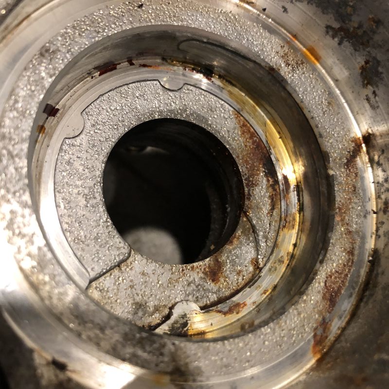

Sorry for the long pause. I had work to attend to and was waiting for the right tools to continue. I have now taken most of the stuff out. There has been no water in this engine other than in the crank cavity. Weird. I am having way too much fun rebuilding this engine. Here are some pictures of where I am now. I will try to split it open tomorrow. I am hoping to be able to take the bearings out and new ones put in without having to use temperature to shrink and expand parts. I don't want to take the wheel shaft out. Any thoughts on this?.

Ok. Couldn't wait and went ahead. Split it very easily. Here is the real damage. Glad to have gone ahead with it. Need to take one of the bearings off the case. There seems to be a rubber seal on one side.

Seal in one side of the bearing is pretty common. What bearing in the case do you need to replace? Flywheel side or drive pulley side? Pics cause theyre fun!
As far as the rear drive, did you drain the oil in it and if so, what color was the oil? Any water in it? Any noises that concern you?

I did drain the oil. Looked clear. No water. No weird sounds. I'm replacing crank shaft, both bearings and piston. Took seals out. Need to clean everything and place new bearings in. Hoping that freezing them will allow them to slide in easily into the case. Any suggestions to clean the space where the bearings will go?.
