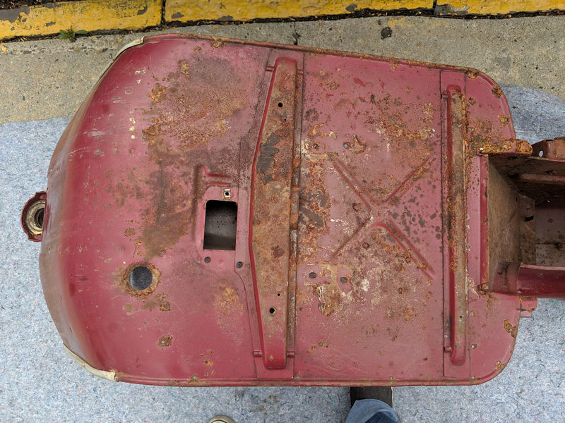

I have taken a few more pictures tonight to get details of the frame. I do think there is validity and importance to keeping the original paint as long as possible. With this frame, I am just not sure if the desire to keep the original paint is sacrificing the protection of the frame from rust. I have never done any of this stuff before so I just don't know how easy or how much rust inhibition can be done while keeping the original paint, given how much surface rust there is. I don't think the rust that exists is major, but again, I have never done this so I feel like it is surface rust that might be starting to go deeper with pitting in some spots. None of the metal feels fragile as if the rust has eaten away at its strength, still feels like there is still a lot of "meat" on the frame. But in a few spots it looks like there is risk of worse damage without steps to protect it before it gets worse.
Here are some details of the frame. I have not washed it off yet to remove a lot of the dirt and dust just stuck to it.
left rear floor board. this seems to have some of the worst rust in the bend at the back.

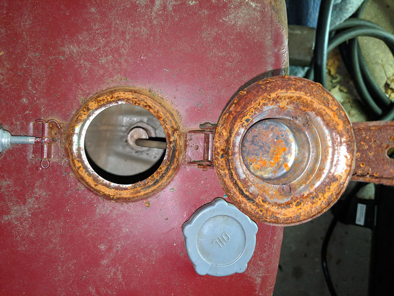

gas and oil look pretty good.
this is the worst rust on the whole frame i have found so far. I do think it can be sanded out.
although the opening rust, the interior of the tank looks surprisingly good.

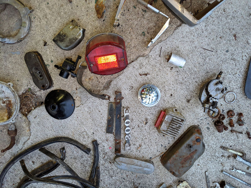

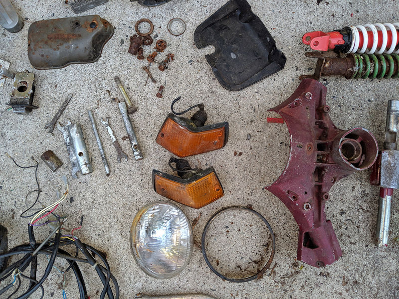

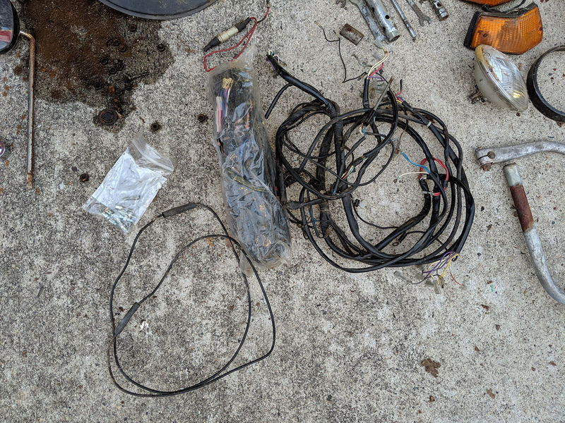

I went through all the milk crates of parts to sort things out and see what was there and wasn't. Here are some images of most of the parts, aside from the bucket that was full of water and rusted out hardware.
original wiring loom. new wiring loom. cowl grounding wires.
found the throttle tube. gear shift tube has lost most of its paint on one side.
did not find the front turn signal housings. Did find the wiring components to them in the bucket of water, destroyed.
rubber probably will throw out. I threw out a ton of old dry rusty control cables he kept.
the infamous bucket of water and parts all destroyed. there were some good things in here if they weren't destroyed.
original headset cover with some mud or melt damage from who knows what. a mildly scratched replacement headset cover. not sure what that circular metal thing is above it.
what is this metal circular part to the right of the black headset cover?

Original before starting to remove rust:
inner left cowl
inner left cowl rust
corner of inner left cowl
front fender.. metal pitted. need to sand the base metal down smooth.

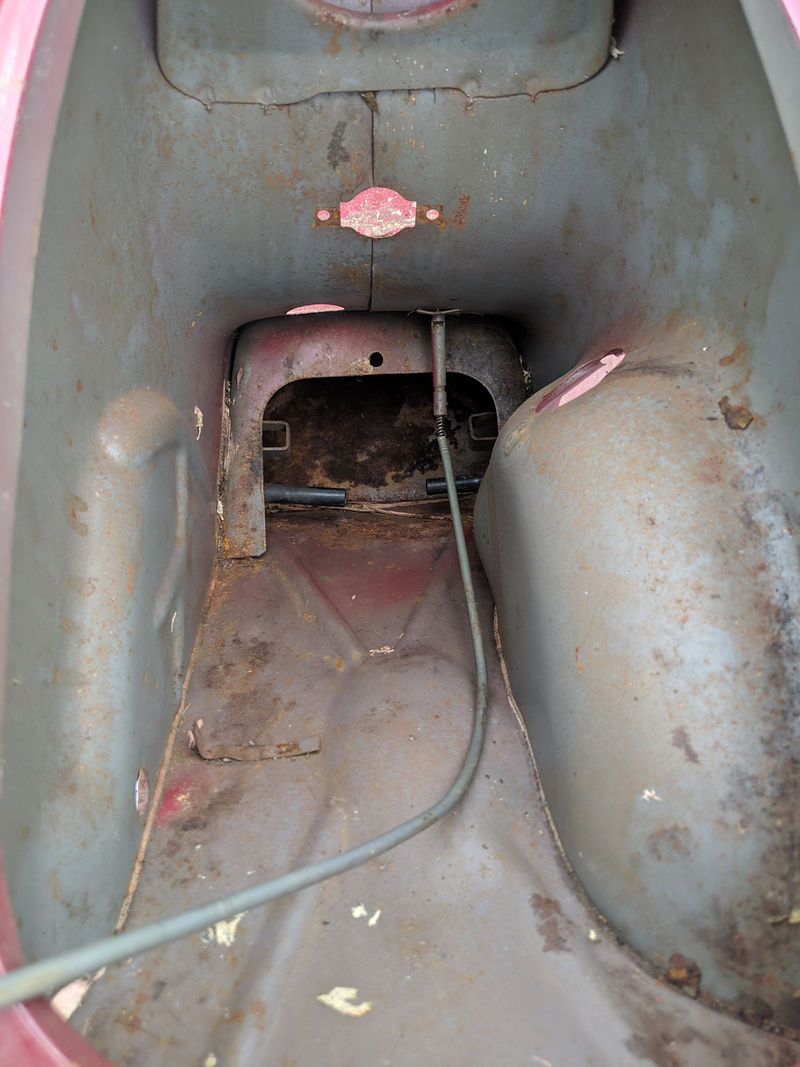

Tue, 30 Apr 2019 20:43:42 +0000 quote
I am starting to clean up my garage a bit to make a little space to work on this project. While I was pulling things out of garage to do that, I blew out the nest inside the frame and took some detailed pictures of the whole frame to get a good idea of what I am starting with.
The frame itself seems solid, no warping, bends or issues where the leg shield attaches to floor at the front, or where the floor attaches to the back below the seat.
There is some decent amount of surface rust inside the frame tunnel due to the nesting that some animal was using it for. Is there a way to remove the rust scale from inside the frame tunnel along the floorboard as is? If not, I guess I'll just pour owatrol oil down there trying to get every inch of it covered as much as possible.
how to get the rust scale out of this floor tunnel?

Tue, 30 Apr 2019 21:00:07 +0000 quote
You'll have to either grind the pitted metal or use a fairly abrasive sandpaper (like 80 grit) if you want to smooth it out.
I used Siem Rust Seal directly on my rusty smallframe. It's easy to apply and dries to a cool satiny finish. I almost left it that way.

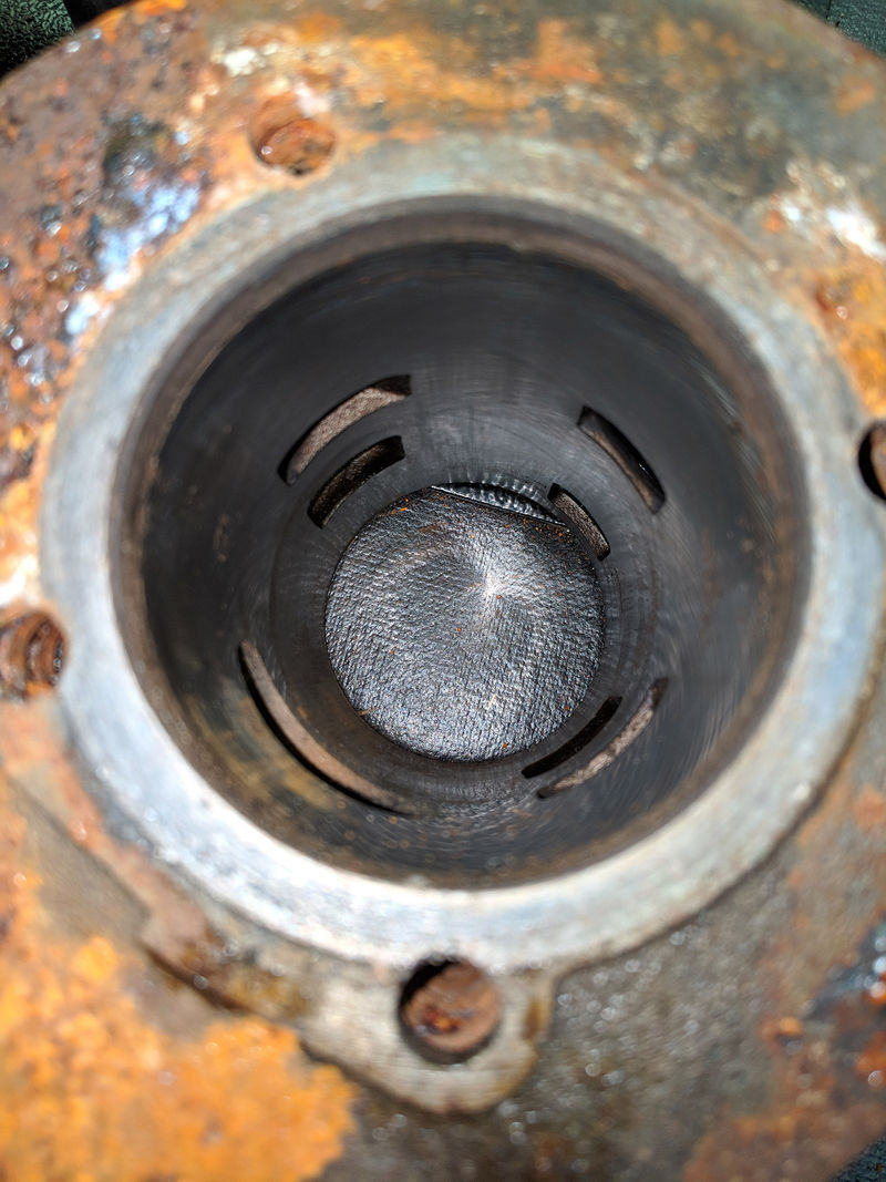

Set up my engine stand and took the cylinder head off today to see what I'm working with. Some rusty studs and cylinder. Engine cases look great inside, but the top end, studs and crankshaft are gonna need to be cleaned up.
I think the piston and cylinder look like there is no damage.. just wondering if I can clean it up and plug it back in or if it needs to be bored out again?
Im thinking sandblasting the cylinder fins to remove rust and then it should be good to go?
Then again, I do plan on upgrading the top end at some point, but hopefully I can get it running as is earlier rather than later.
Studs I think can be reused with some wire wheel to remove the rust and then coating with owatrol oil to protect against rusting again.
matching cases. too bad the port shapes don't match from the factory!
the case aluminum looks clean, aside from the 20 yr old oil. Crankshaft looks like it needs a cleaning. sawdust on it from building shelves. We'll see what shape its in when it comes out.
