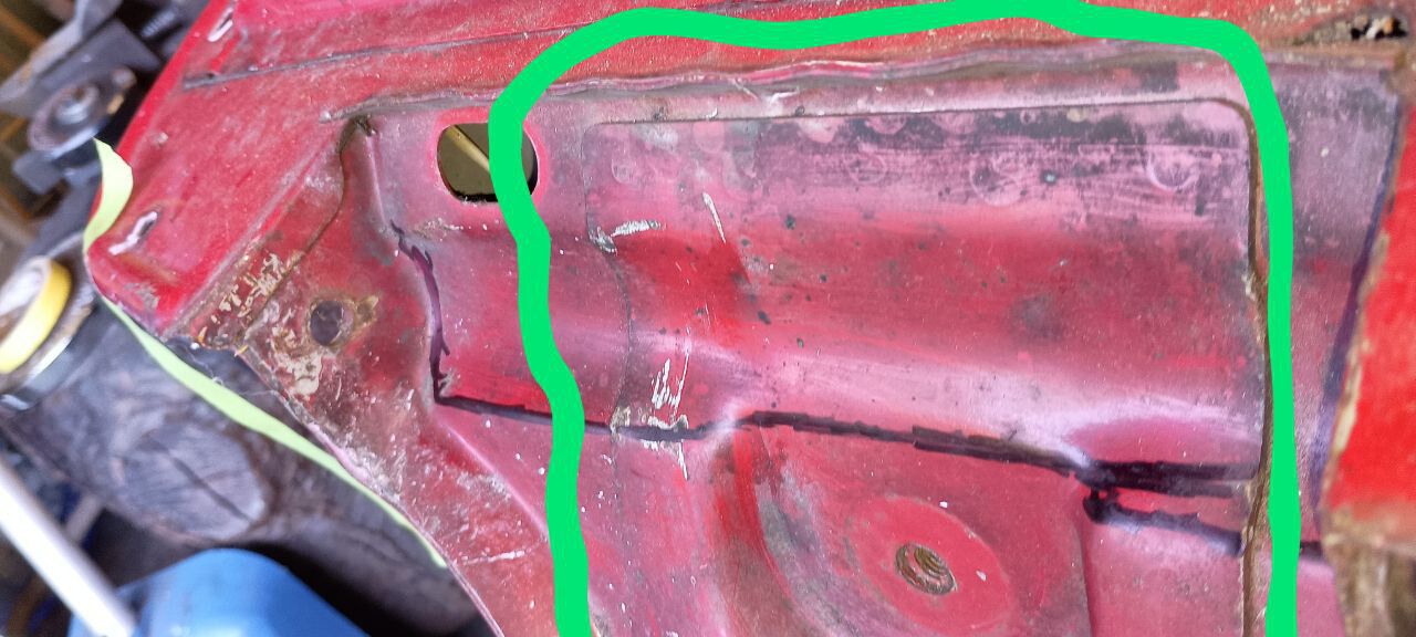

It seems the frame is a LOT stiffer than I am used to, the leg shield corner hardly flexes at all and it has some additional frame bracing that Vespas lack. This particular model doesn't have large openings in the leg shield for turn signals, just 2 holes on each side for surface mounting I guess(they were already gone). The leggy/floor measured 1.1 to 1.2 mm thick at the edge while my AllState was .86 to .96 depending on where I measured.
It turns out that the body is really straight and the original deep red paint is pretty tough and buffs up nicely. And the paint's 99.9% all there on the frame so matching for the headset, cowls & mudguard will be the biggest challenge.

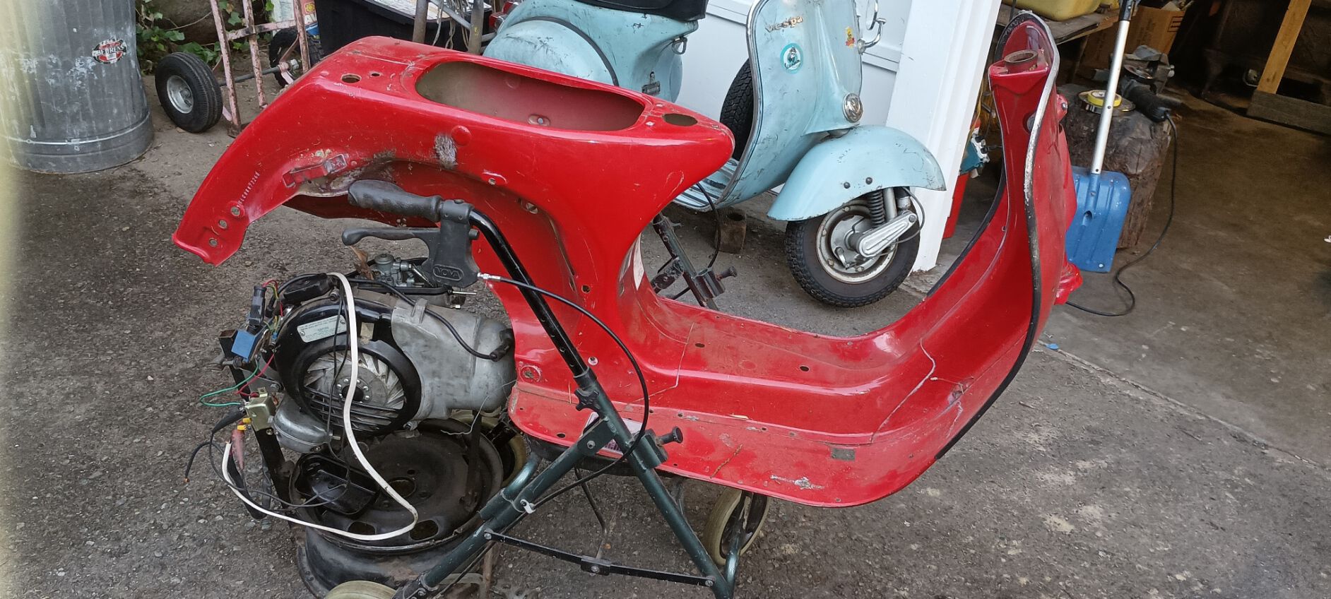

A little progress and more knowledge about these rugged Indian bikes. It sure seems that ppl that have had a Bajaj seem to love or at least respect them. I'm still trying to puzzle out the 4T vs 2T permutations on these. Did any of these newer Chetaks come w/ 2 stroke motors? Possibly both 2T and 4T into the same frame? So I decided to see if I could fit a P200 motor in there.
I've also been playing with the look of it and decided to swap the trap headset for an older VNA style that is more smooth with the rounded tube extensions and round lite like a stock 2004 Chetak. Also the trap needed repairs and all the internals which I don't have.
engine bay still needs cleanup
You can see the extra bracing
engine bay still needs cleanup You can see the extra bracing

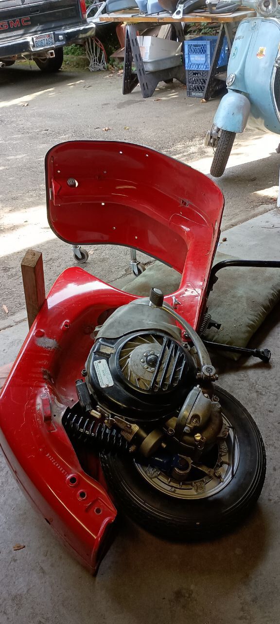

It's alive! The motor is finally in and it fired up with very little fuss - I even rigged up the solenoid and started it w/ a battery. Getting the motor to fit in that tight pocket was a fair challenge, the 4t motor has a smaller main pivot mount diameter and uses a smaller thru bolt, the size a small frame uses.
Now I'm getting a modified P200 fork fitted that was set up with an old VBA mudguard that I considered using as well as a VBA headset. It just didn't look right so now I will try a trap headset if I can find all the needed pieces and get it to work. There must be a hundred small 'adaptations'* to work out when you are building a Frankenbike with parts from three different makes.

old VNB motor half has about same dimensions as the LML and it just won't go
you can see the small pocket and where I've marked it to cut for enlarging across that thick reinforcing plate that was part of the 4T motor mount system
after cutting and much spirited bashing w/ the cut off piece of reinforcing plate positioned to be welded back in
ugly stick welded but lots of deep tacks and plug welds into the thinner metal behind
I enlarged both pivot bolt holes off center to move motor slightly out & away from the frame, VNB dummy motor now clears fine
that big lump on the LML swingarm is not gonna help
GONE!
GONE!
I flipped the frame upside down w/ a stout board bolted thru the gas tank opening & my new T stand for the front so I could drop in the LML motor
Bolted in and shock installed, the 4T had the top shock mount same as 2T
