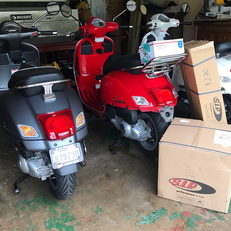

I really wish I knew how to or if it's possible to post more than one picture at a time. I see the question asked all the time but it's never answered. I only use my phone for the convenience but maybe things work differently on a PC???
Anyway, what spurred me to start all this was my boxes started arriving today. Amazingly the ones that came from Germany beat the local orders. If anyone has concerns about ordering from SIP don't worry. My order got here in 3 days...and would have been here yesterday if it weren't for TS Imelda dumping feet of rain here.

Also took that chrome springy rack off the back and added something a little more retro and sporty
is that the alibaba rack?

jerryd wrote:
No not alibaba. I actually got from SIP. It's number MV655829MB there. ScooterPartsCo also sells it here locally but since I was already getting something I could only get from Germany I just added it to the order.
