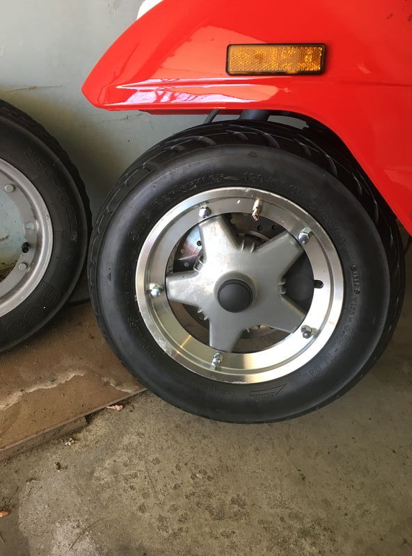

I put two of these tubeless rim/tires from SIP on my 2005 PX150 and I love them. They came already mounted on the tubeless aluminum rim and all I had to do was mount them. They came with the mounting nuts and Nord-lock washers. I ordered them through Scooter Mercato. I just feel safer riding on tubeless tires.
https://www.sip-scootershop.com/en/products/tyre+sip+perfromer+20+_30301010
SIP tubeless rim/tire.
Tubeless rim/tire mounted.

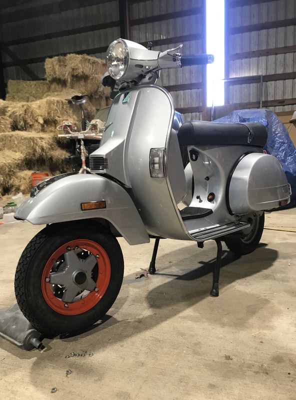

Orange rim...

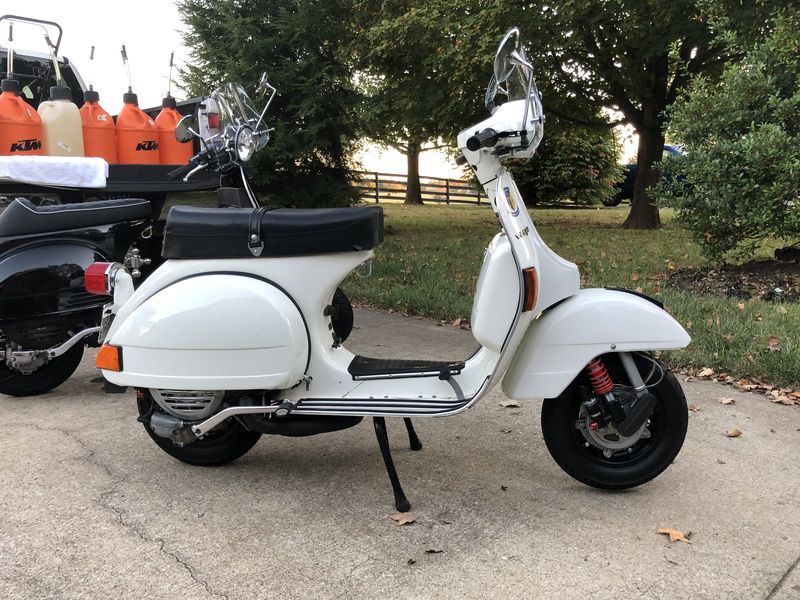

Red rim...

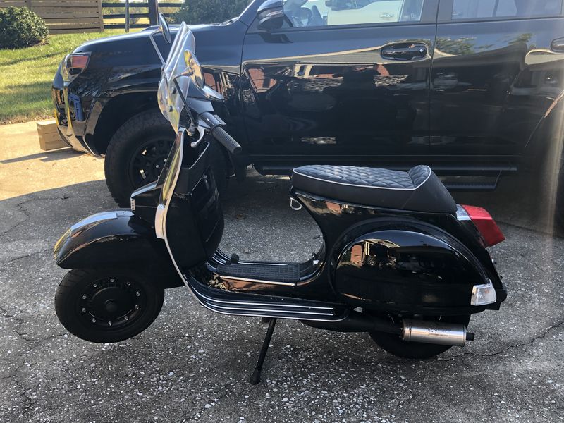

And a black...

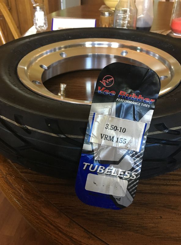

Package from SIP today
SIP also sent a 25th anniversary book entirely in German Facepalm emoticon
It is a fantastic resource and so is this forum. Thanks MVers for your able assistance as always!
