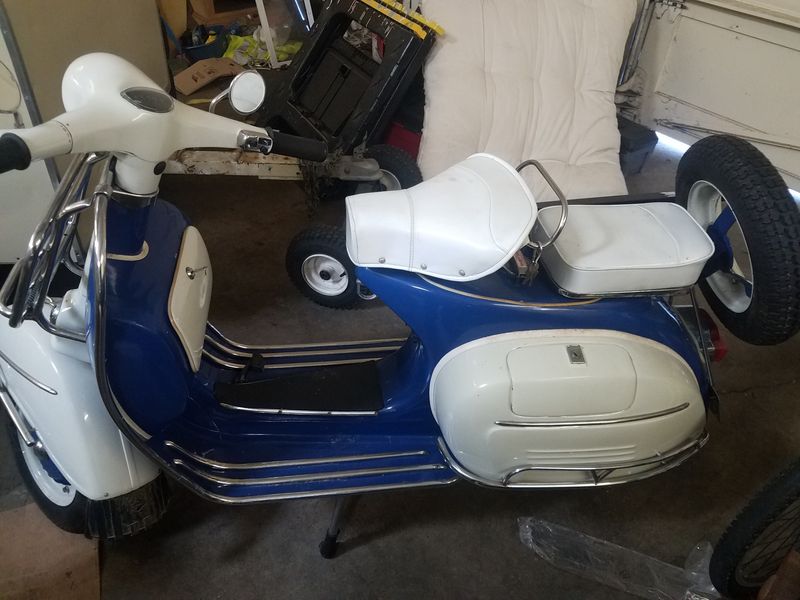

A bodge is in my Garage. (Think Dr. Seuss story) Haha!

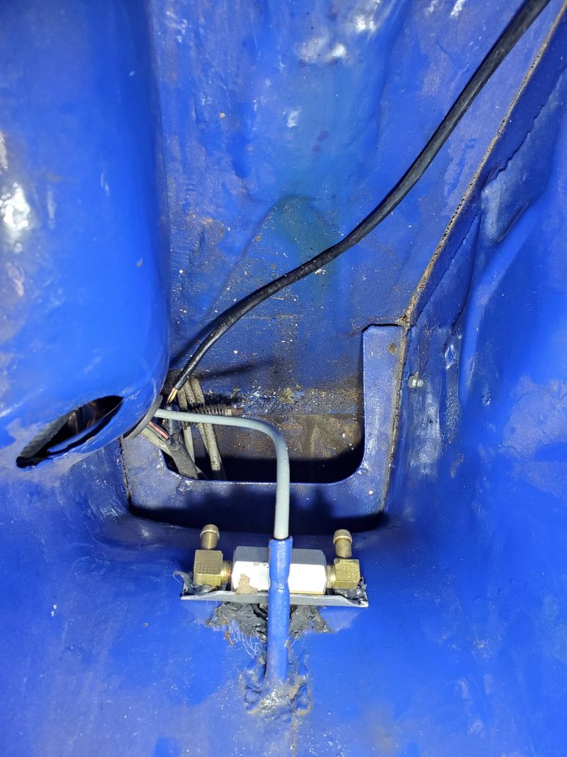

Long story short, I'm looking at a bodge for a friend of my wife's. It is labeled as a 1966 Sport 150. I had . . . let's call him Don, yeah, Don. I had Don bring it over to the house so he could see what a 1962 Allstate and a 1979 P200 looks like. Then I could point out subtle and not so subtle differences between what he owns and authentic Vespas.
To be clear, I'm not saying anything negative about it, just pointing out differences and explained to Don I am not even close to an expert - just observing.
Don said it seemed like fuel to him cause it'd run for about a mile, then die. I shook his hand and told Don I'd get back with him after I checked it out.
So I open the tank and cannot see through the fuel to the bottom of the tank. Too rich a mix? Probably. So I siphon out the gas and pull the tank. OMG!
The hole for the fuel tap has been welded and an output has been installed. This home made fuel tap has been installed, and a fuel filter in the line also.

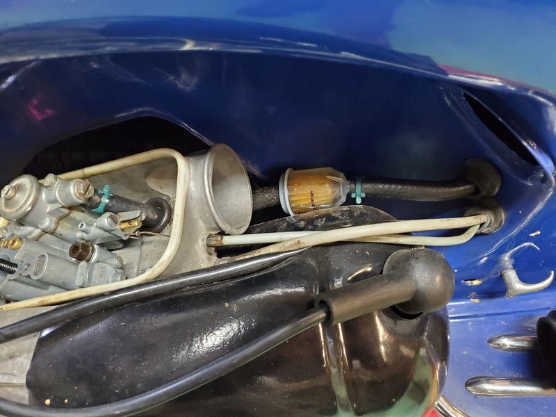

For grins, I proceed to clear out the lines, and to my suprise everything is pretty clear, except for the carburetor. In fact fuel was all the way to the top of the little cap above the float bowl. So tomorrow I'll pull the carb and give it a quick clean.

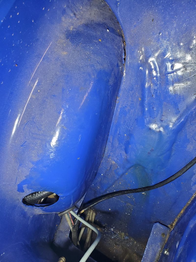

While I was in there I looked at the bodywork. It looks like some work has been done inside the cavity...

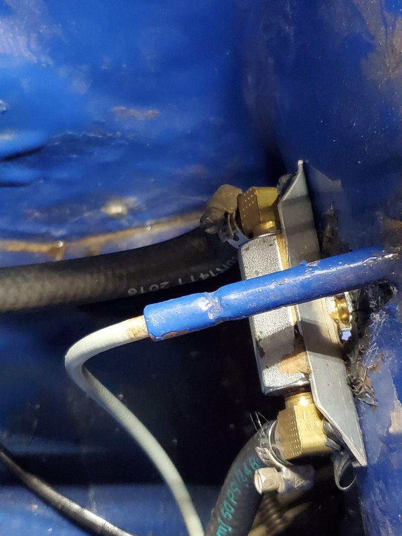

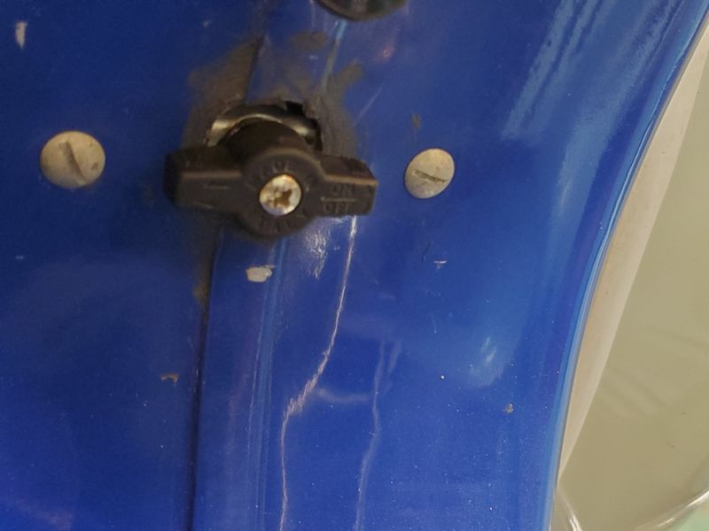

What is this?
What is this?
That's not a good sign...

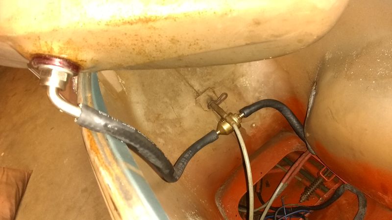

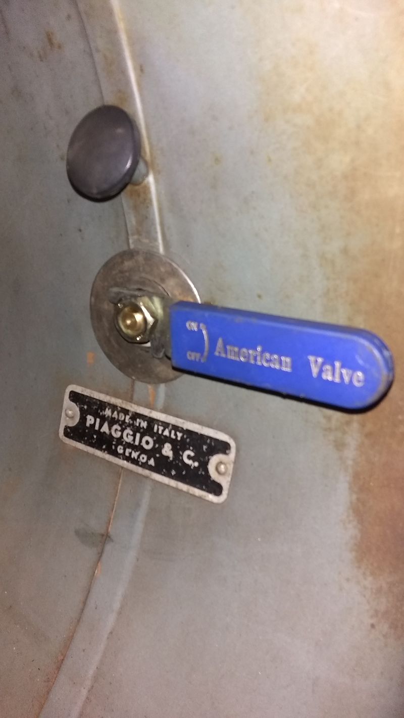

E-Gads - what type of home brewed fuel tap is that?!?

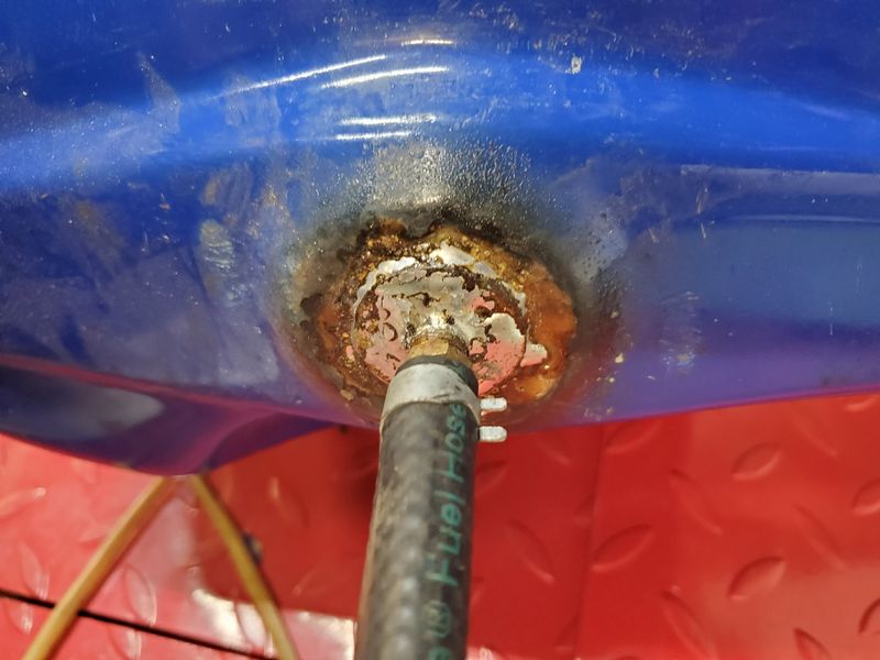

Bottom of the tank is welded with this plug to accept a fuel line, which attaches to that funky fuel tap.
Then there is the bodywork inside the body. Hmmmmm.....
Another bodywork picture...

I had a bike show up recently with one of those shut off valves. It's a fuel shut off for a car from Summit racing.

Which position is "reserve"?
Ahhhhhh
@attila avatar
Posts: 8291
Location: Latina (Italy)
@attila avatar
Posts: 8291
When closed, detach the hose from the carburetor and do the test: closed ---> open ---> reserve.
Easy.

No reserve. Just Open or Closed. I'm concerned about the gravity fed system and fuel not getting delivered properly. That's neither here nor there though, until I pull the carb and clean it. I was just asked to look at it. I'd like to get it running, check all the nuts and bolts, then get it out of my garage! Razz emoticon

I wouldn't worry about the flow if I were you. So long as the line isn't kinked, the head pressure will be the same, so flow will be the same, too. Besides, on a bodge like that, I doubt it will hold together at WOT long enough to get fuel starved.
I wouldn't worry about the fuel filter, either. Also Summit Racing, if I were going to guess. Cheapest one they sell.

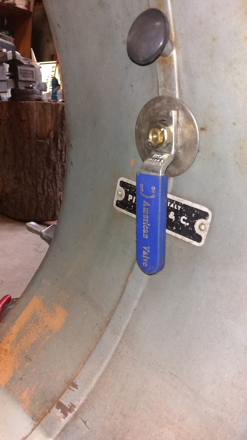

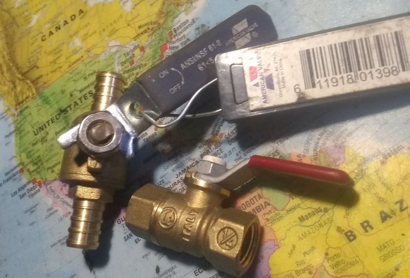

Buckle up, here's mine & yours sux next to it. No race car swag here, ~8 bux @ home depot :
serious  AMERICAN!!! bodge
Tire valve stem to the rescue, no solder & no leaks

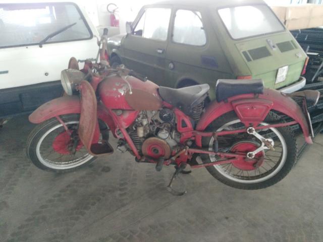

This 150 VL3T (Struzzo) was worse:
I posted the photo to push you to beautifully restore the one in the topic

holly smoke, the inside revealed lot of weldings.
I thought so too. I'm going to check the underneath closely and get pictures to the owner, so he understands what he owns...

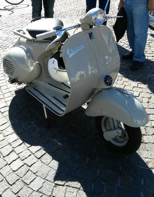

Let me understand ... you are not interested in restoring the "bodge-vespa" in the picture but only making it walk regardless of the type of spare taps included; well a Klinger valve would be good, or not?
On the steampunk style I agree ... the bodgevespa has already been thoroughly martyred.

... i found this 1951 Moto Guzzi 250 in a garage:
But it wasn't bodge ... Bought, i'm waiting to restore it

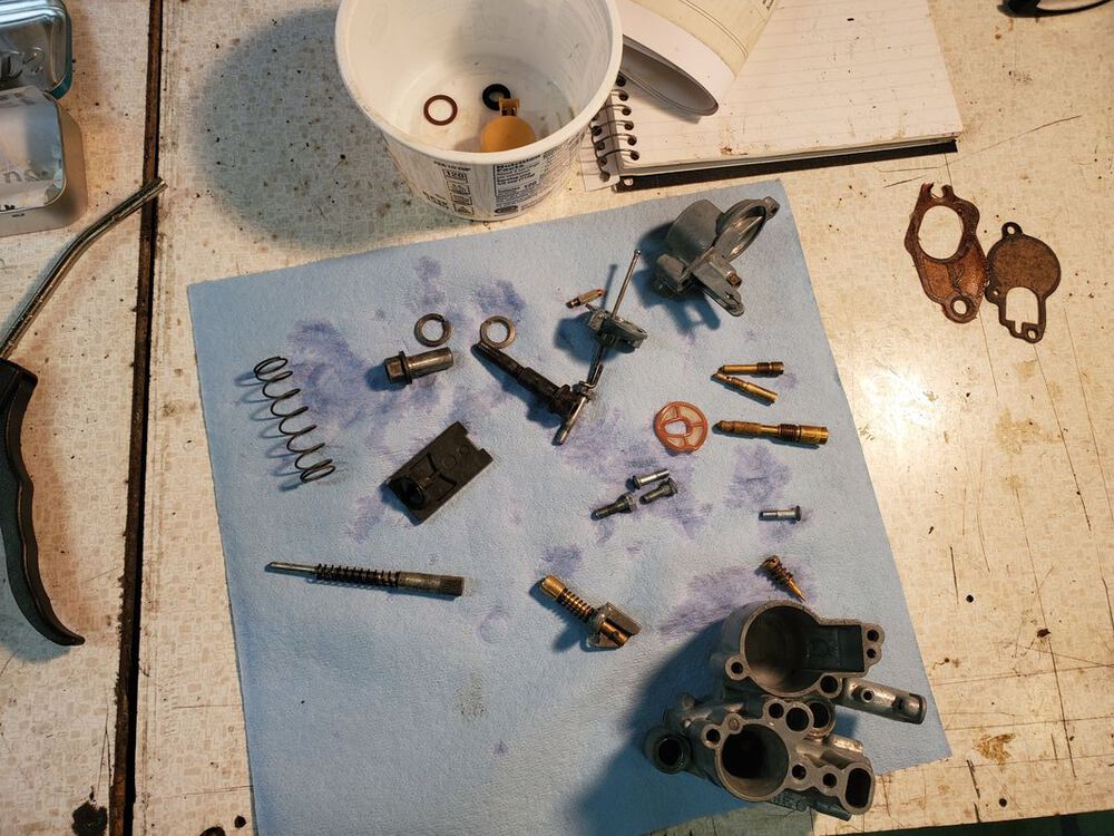

Running
I'm with Voodoo HhoDat - I'd kick down some cash to see that go down! Razz emoticon

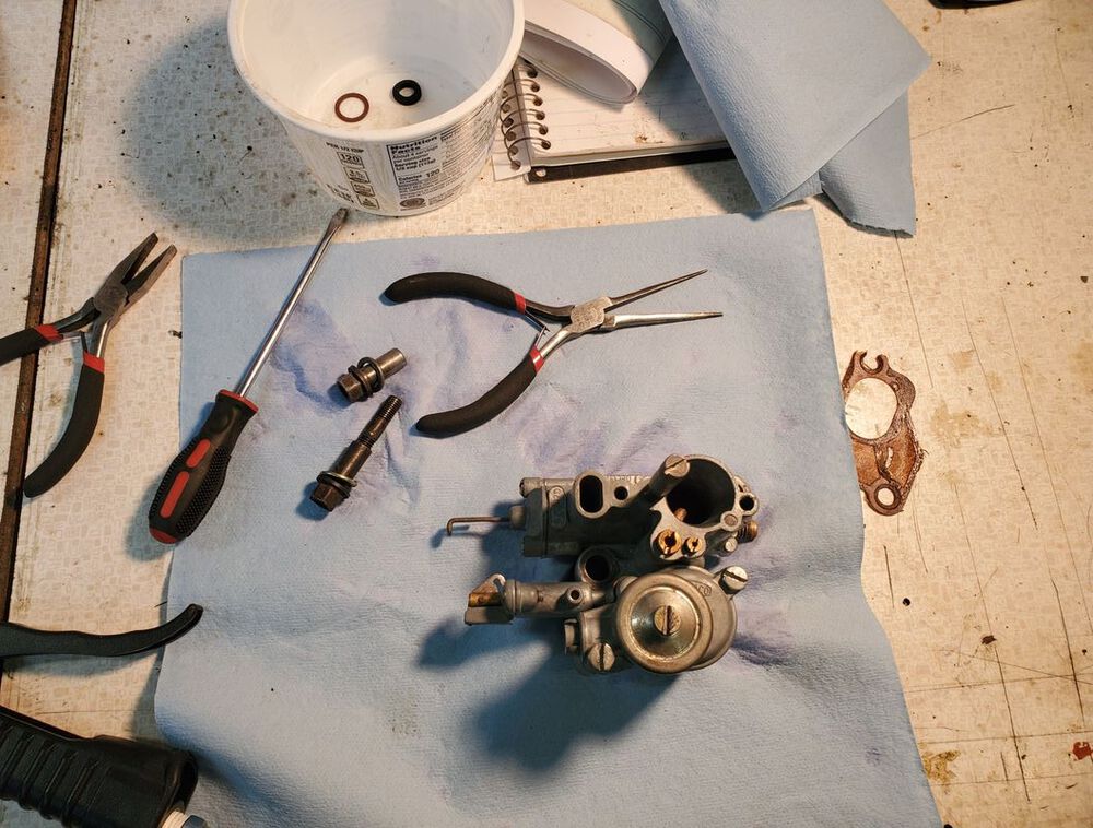

So I got it running. I pulled the carb and cleaned it, replaced the float and needle. The old needle actually had play at the end where it sets in the float. I'm sure this was the original reason it wouldn't run. The float looked ancient and while the needle was red-tipped, that play in it is a deal breaker for it to even work.
So someone changed out the whole fuel delivery mechanism, and still couldn't get it running reliably. All because of a float needle... Just a guess...
I'm nervous to drive it around. The front fender was missing a nut so the fender was loose. Also there is play in the steering column. Groan. I'll see if I can just lift the headset a touch and tighten things down. If not, I'll tell him and he can take it to the guy that updated his fuel delivery mechanism
Either way, he's coming by Monday morning to pick it up, and that'll give me time to find a generic waiver.
Took the carb apart and cleaned it. Notice the yellow float bowl...
Carb back together with new float and float needle
