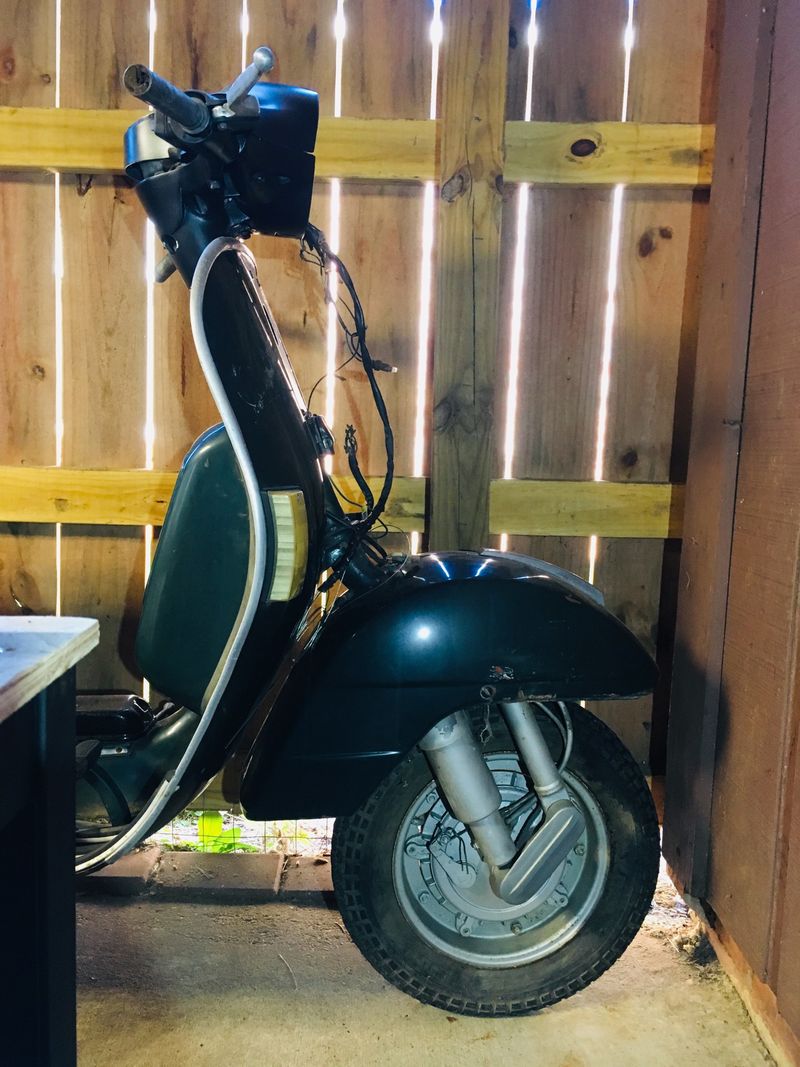

Again thanks for the reply, love the MV community and here is the obligatory pictures! This is right after it got home from its previous home, a chicken house.

you can repair the keyway with JBWeld. On the flywheel side, it's just a locator for timing. The taper of the crank is what holds the flywheel in place.
The thing about the crank is that if the main bearing was damaged by weather exposure, then you can reasonably assume the crank web bearing was, too.
Looking at that picture, it seems like the fork is maybe bent. Maybe get one that's more the profile so we can see for sure.
Completely agree, as crunchy as the main bearing is surely an others in the chamber are cooked. Key way is least of my worries!
But why ya gotta make my heart drop like that?! Kinding of course! I will get it out of the shop tomorrow and snap a better picture. Hope it's not tweaked but will let you determine it.
Thanks again fellas
For now this is another picture I have of it. Not profile but close-ish-ish?

Ok Chandlerman, will this picture get you a better view of the fork? Floor board is level to the ground. Bike is tucked in a corner of the shop and I'm down with a case of lazy this morning.

Fork looks fine to me...
Posts: 10085
Posts: 10085
huh, you sure?
I thought the top & bottom were more parallel???
But I have no P here to check.

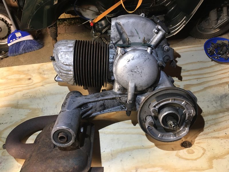

Do have a before and after cleaning for my fellow picture people
Dirrty
Dirrty
Puurty
Puurty

I didn't run off, I just actually went out to the garage for a little while this afternoon. That will be the subject of its own little thread, or maybe just a post in Today, I...
That fork looks fine in profile, so it could just have been that first picture. Maybe shoot another one at some point when it's parked on pavement. Take one of it with the front straight head-on, too. It could be bent sideways, too. That can happen if it gets hit hard while parked.
