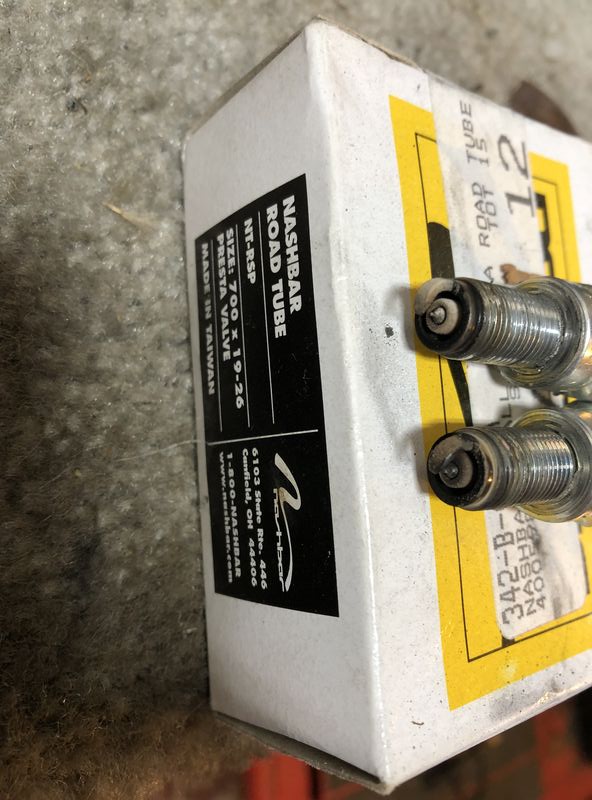

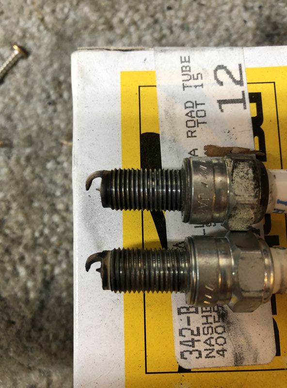

They don't last forever, but they sure lasted long enough!
MP3 500 uses two plugs in one cylinder.
Recommended change interval - 6,000 miles.
I don't recall the thread, but it was recently brought to my attention that I had not changed plugs in my MP3 in, well, a few years. Four years and three months, actually. And just shy of 30,000 miles. Wha? emoticon
Just changed them today. Came out smooth, no problems there. Little bit of brown/black soot, but not much buildup. I was a tad surprised at the wear of the ground, but hey, I certainly got my money's worth out of these little buggers!

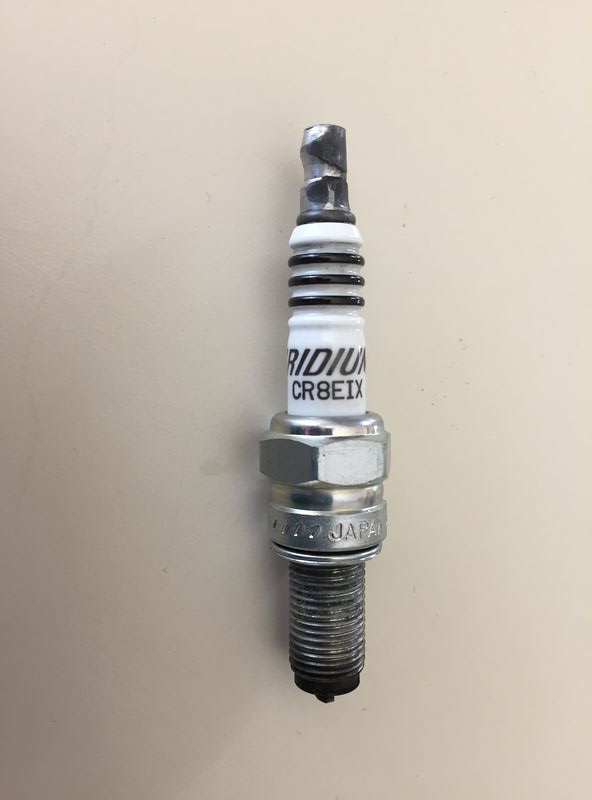

By the way, the plugs are NGK CR8EIB-10, aka NGK 4948. I add this because I have found that the plugs with the screw-off nut at the HT lead end can wear out, resulting in a cap that pops off at the worst times. Photo below is of such wear; don't let this happen to you!

Those sure look worn out and well overdue for replacement. Not good for your cdi units or engine efficiency. But you know that.

Yeah. Oops.

My father had a Vanden Plas R, with a Rolls Royce engine. Bought it from a friend and had it for years. It started running a bit rough, for a Rolls Royce, so we took it to a local mini tuner for a look see.
Six plugs all without the ground electrode!

what is factory gap? I order new pugs based on the pictures of how big those used plug gaps look. and the gap look huge. then i get the new plugs and the gap also look huge.
had a nice running 1972 triumph gt6 many moons ago. one day it stop running while driving it. stopped like it ran out of gas. no misfires or nothing. just a smooth stop. early learning experience
the plug gaps had burned the gap so big the plugs could no longer fire
used gap .070
new gap .028
used gap .070
new gap .028

NGK 4218 - CR8EIX IX - Nickel ground electrode with threaded stud. .8mm gap. Longevity: 50k Miles
NGK 4948 - CR8EIB-10 - Platinum ground electrode and solid stud. 1.0mm gap. Longevity: 100k Miles.
NGK 5258 - CR8EIB-9 - Platinum ground electrode and solid stud. .9mm gap. Longevity: 100k Miles.
