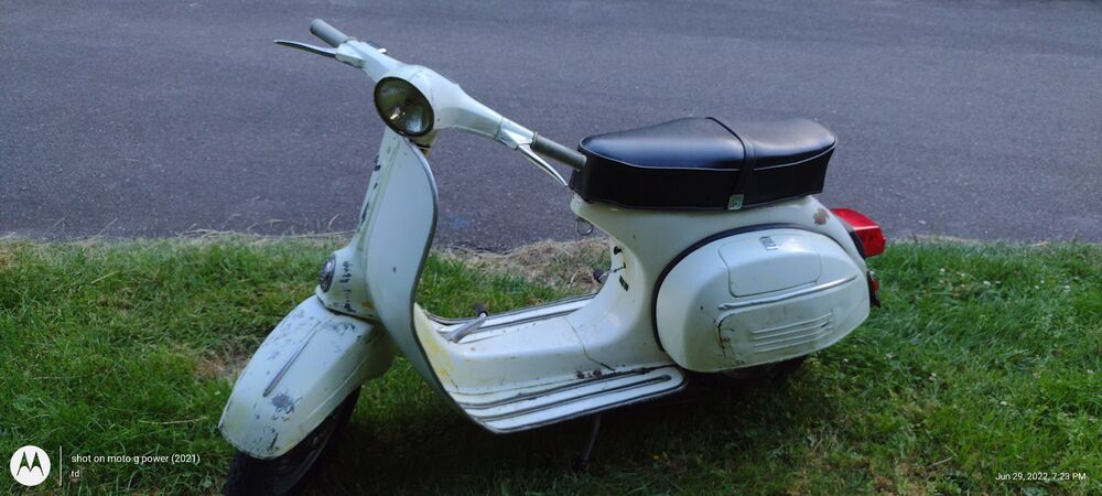

Turns over easy enuff, but w/ good compression & starts quick. The yellow is probably gotta go, so no more sunny side up.
This '68(? yet to be verified, but title says) Super 125, Script badge front & back, CEV real tuna can rear lite, Fresh LML 4 speed we still dunno how geared for 8", seller didn't know. But crappy yellow over original white, some wrinkles & bumps on looks solid body, no bondo though. Quality aftermarket seat. Motor runs great & very good power, but flattie on the front said I was done for now. 5xxx original miles.
It's only unloaded & I'm grabbing lunch before going down to INSPECT this pig in a poke good, I hope steal of a deal.
Popcorn emoticon
If you have any interest & can somehow remove it from my home or other close by place, want a deal, And someone in front takes a pass - It is yours at cost. First, of course me then qascoot then you, 1099$ FOB your rig w/ clean WA state papers and owned by an honest(bribes were tried after we 'shook hands' on the phone) 67 yo Marine Corps vet w/ hat to prove it. We had a great little visit after showing up in an beat up open HumVee. Thanks Randy, see ya again buddy!

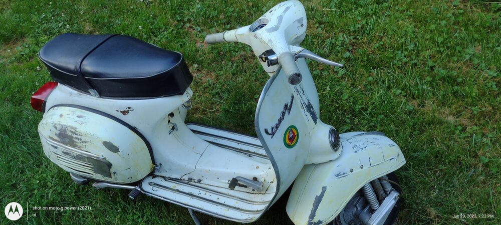

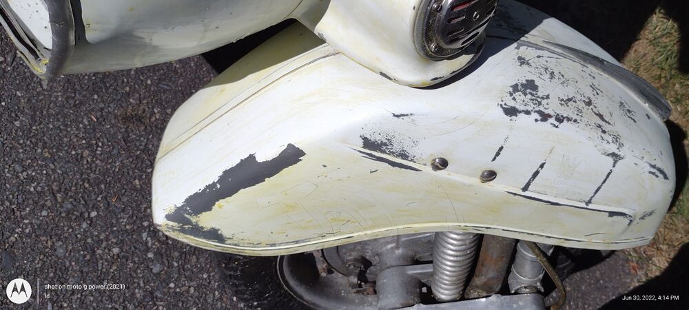

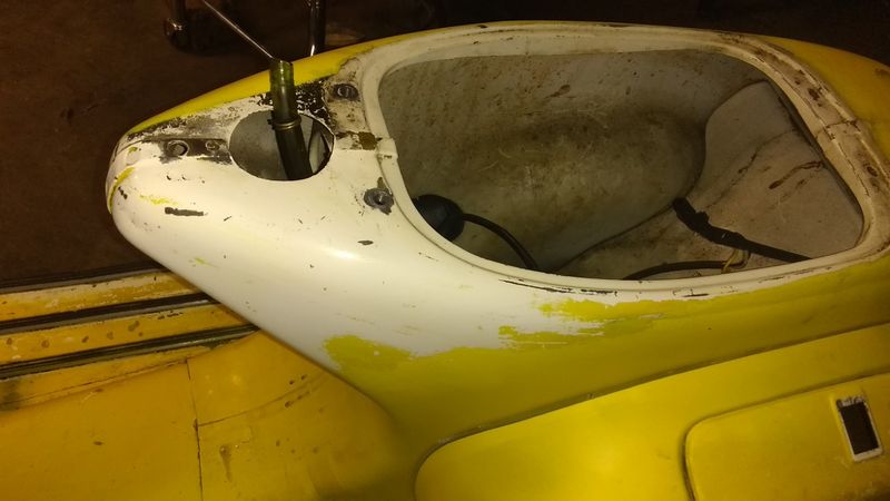

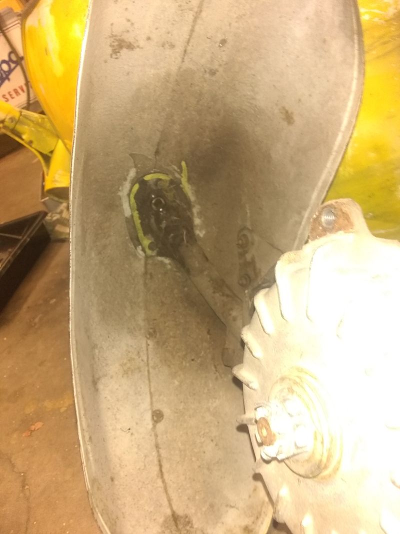

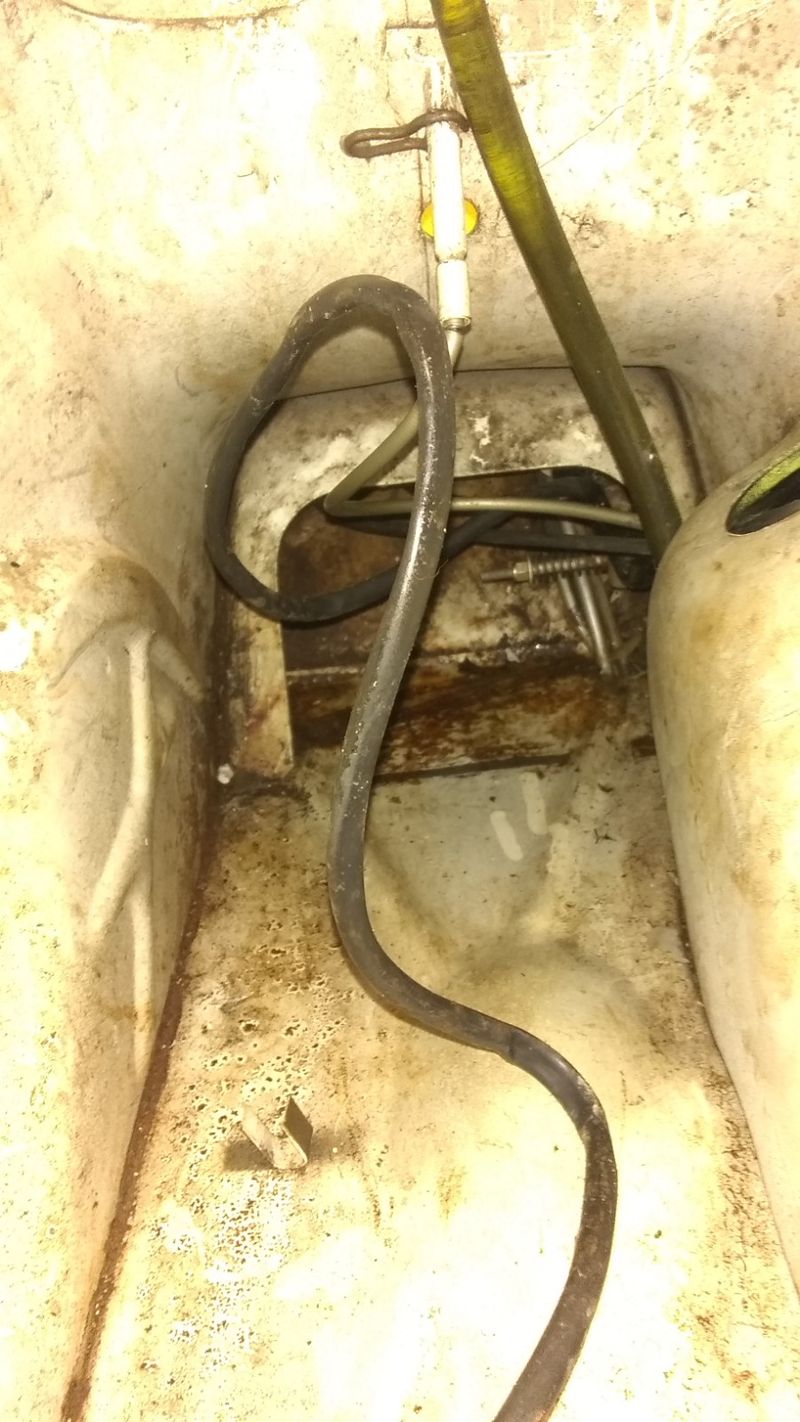

I hope the Portuges like white. This lemon turns out to be more egglike & the white is better than the yolk joke of a sloppy rattle can yellow spray job. Fortunately it comes off easily w/ acetone, which the original white is not affected by.
So many nice little discoveries on a solid lo mile bike.
I'm still happy it followed me home and I'm getting happier.
► very little rust
► the original white looks OKish so far
► Floor tim ALL there & in good shape
► The LML is really healthy, like new w/ just enough miles to relax
► Original wiring is all good & spliced in nicely, everything but horn works
► The tuna can is original CEV in in excellent condition
► All locks present & in good condition, just need to be keyed
► so original and so 'all there' under that LML & all the yellow
Here's where we sing "you'll wonder where the yellow went... la la la "

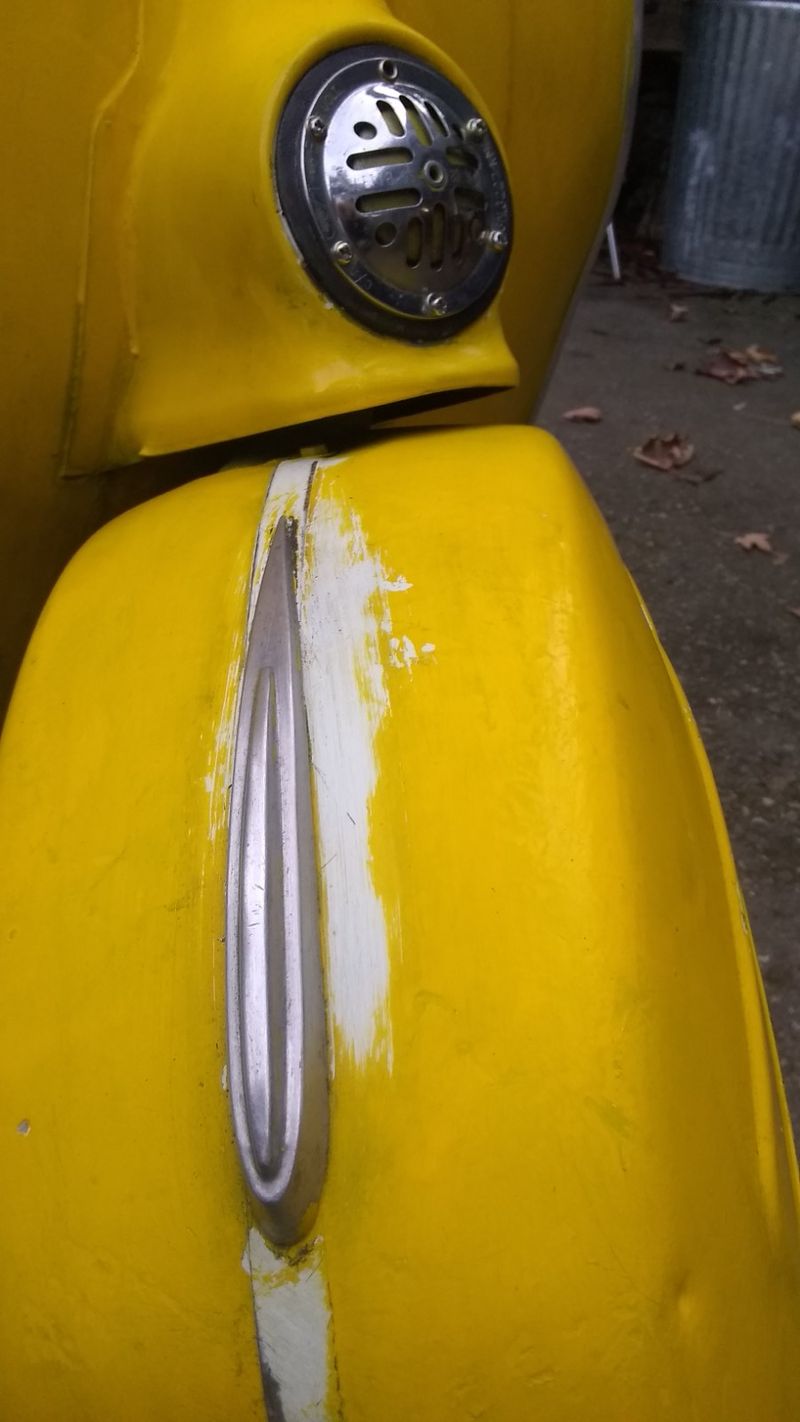

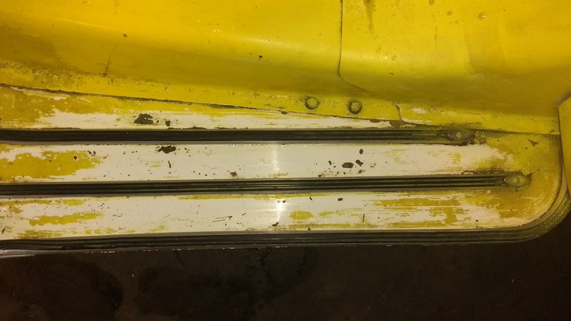

Just five minutes love rubs w/ acetone & the white original is unaffected.
5 more minutes

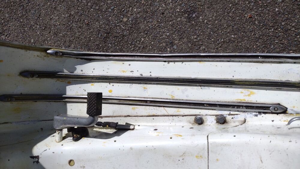

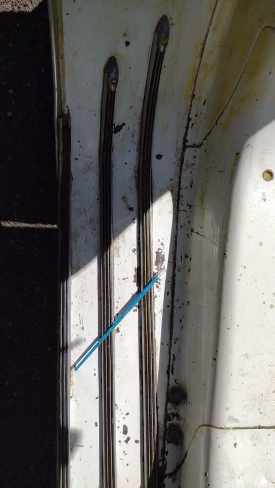

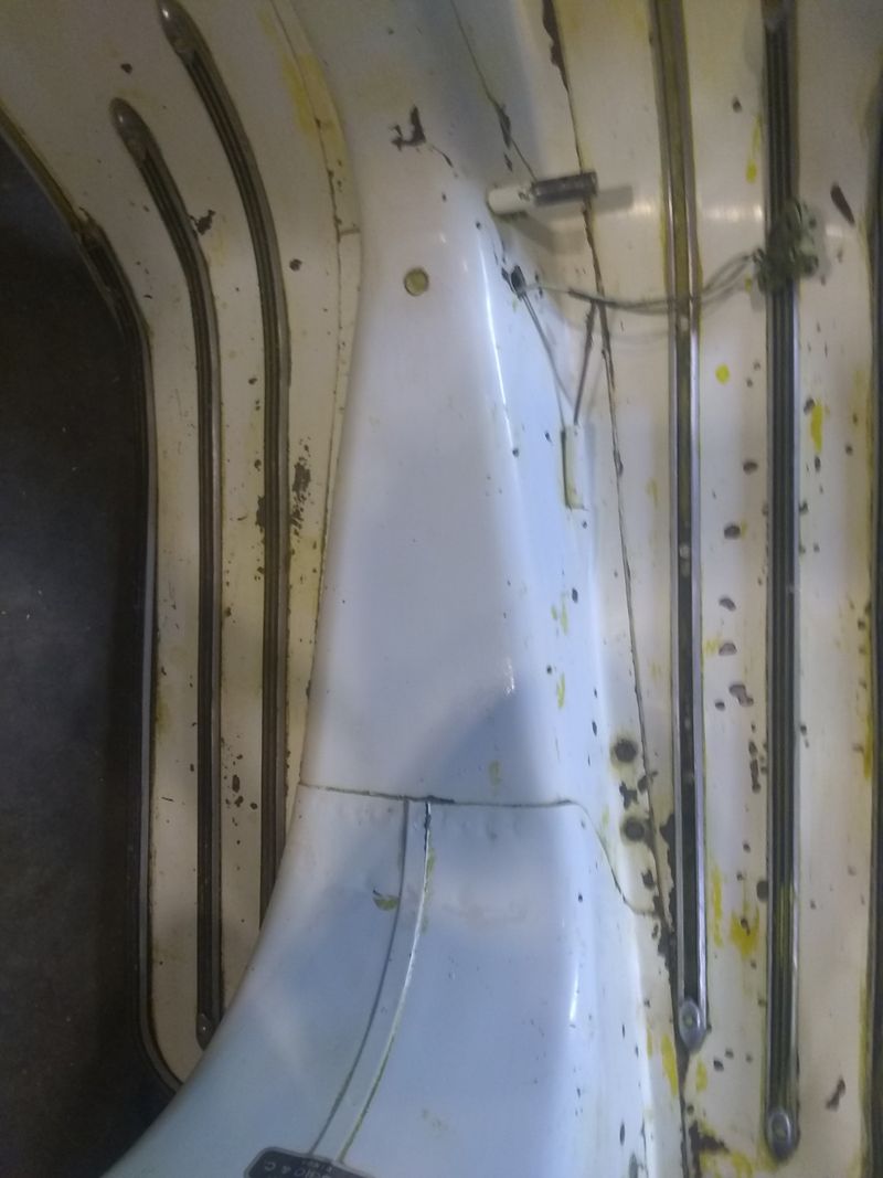

nice floor trim, same on other side
5 more minutes nice floor trim, same on other side
filthy, but so "clean"

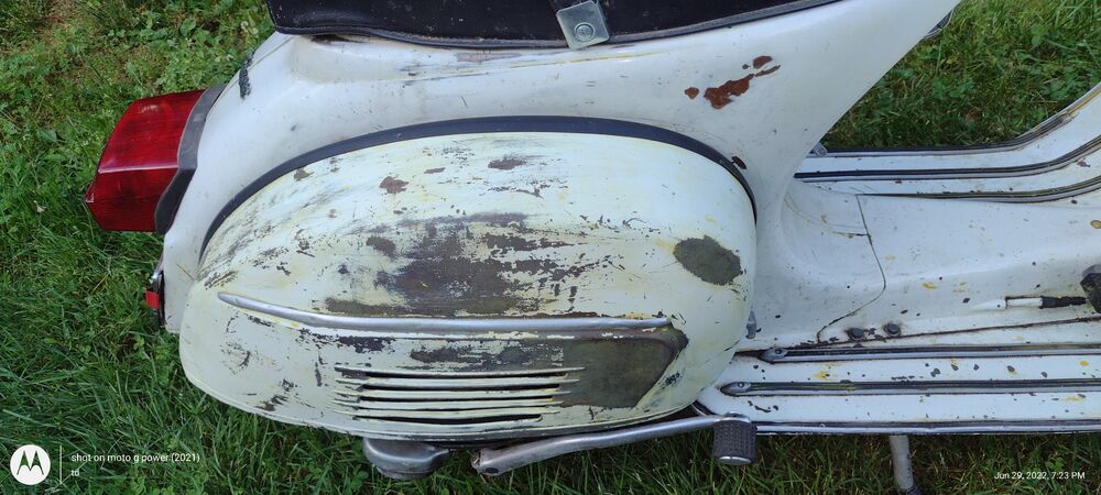

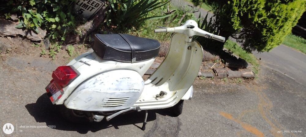

messy,  but nearly like new

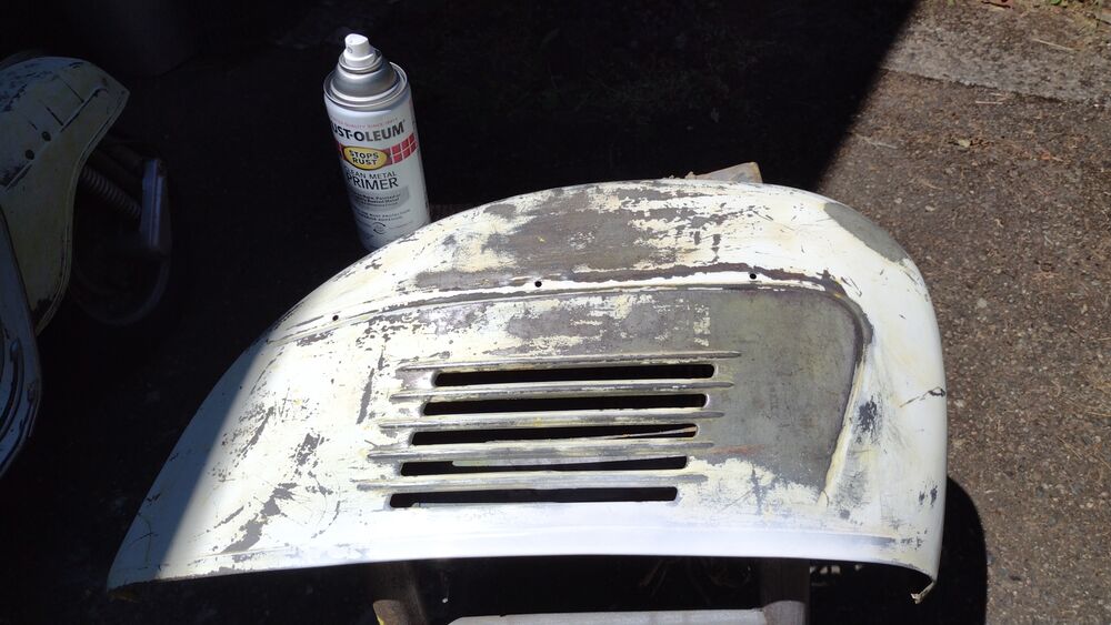

nutz, it's gonna need  sanding

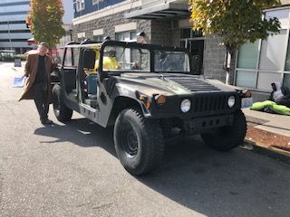

Downtown business, HumVee style
low income  living  downtown
 right next to  I5 freeway traffic
low income living downtown right next to I5 freeway traffic
borrowed fancy camelhair  coat for crisp fall ride in this big fancy "convertible"
home safe and  ready to unload

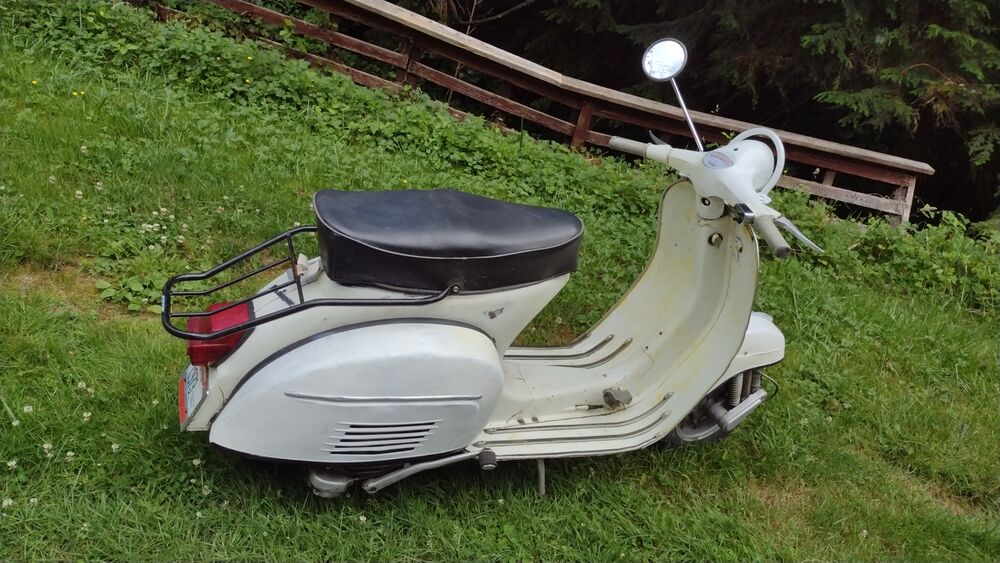

Old original paint and primer is solid as a rock. I've even had trouble using strong, toxic paint stripper to get it off. Modern paints pale in comparison.

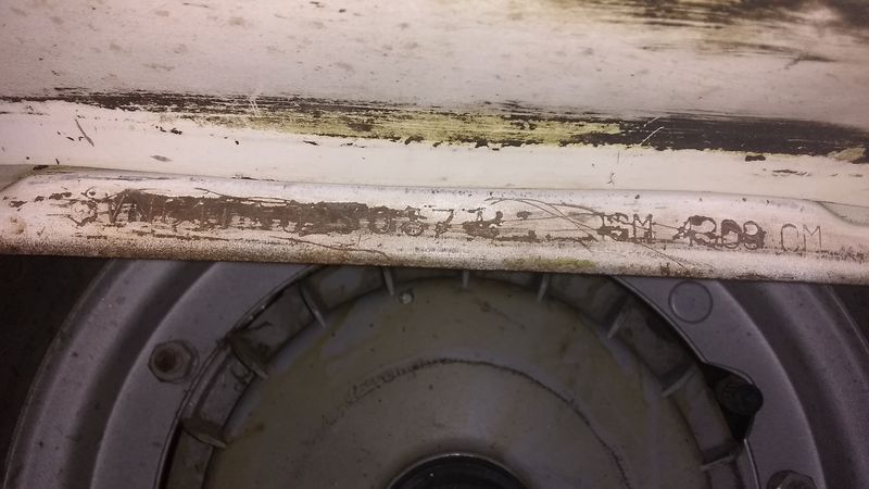

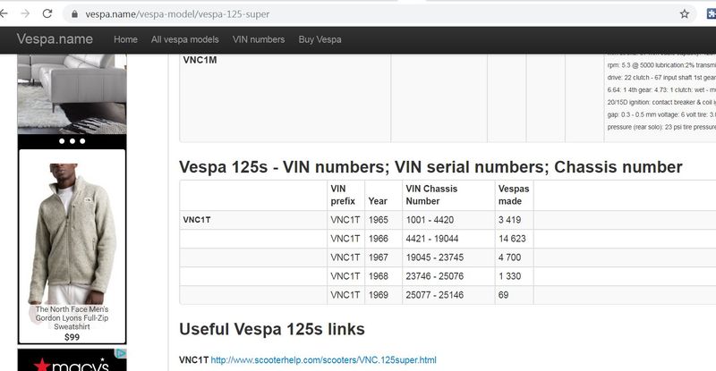

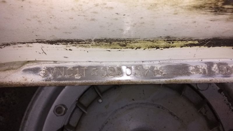

conflict
Between ScooterHelp which says I have a 1966 Super 150
and https://www.vespa.name/vespa-model/vespa-125-super
whis says with *025087* or maybe *025037*it could be a 1968, or possibly a 1969, one of the last.
Opinions? It doesn't seem to have ever been a 150, but no motor to verify.

Would appear 69 would have been a rare find.

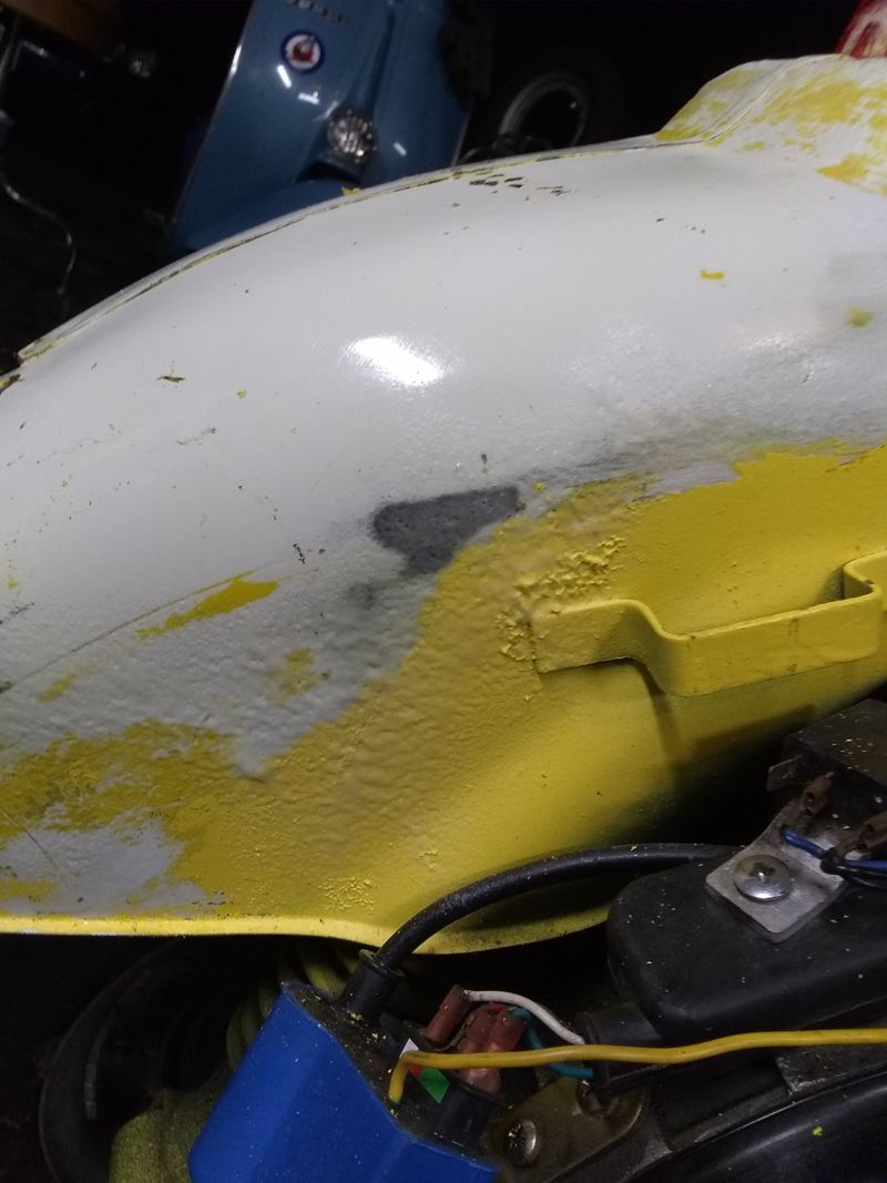

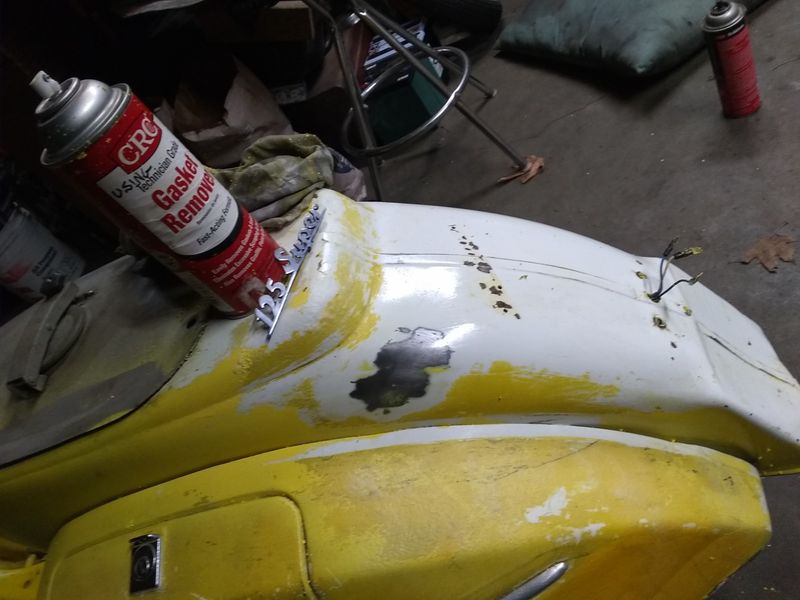

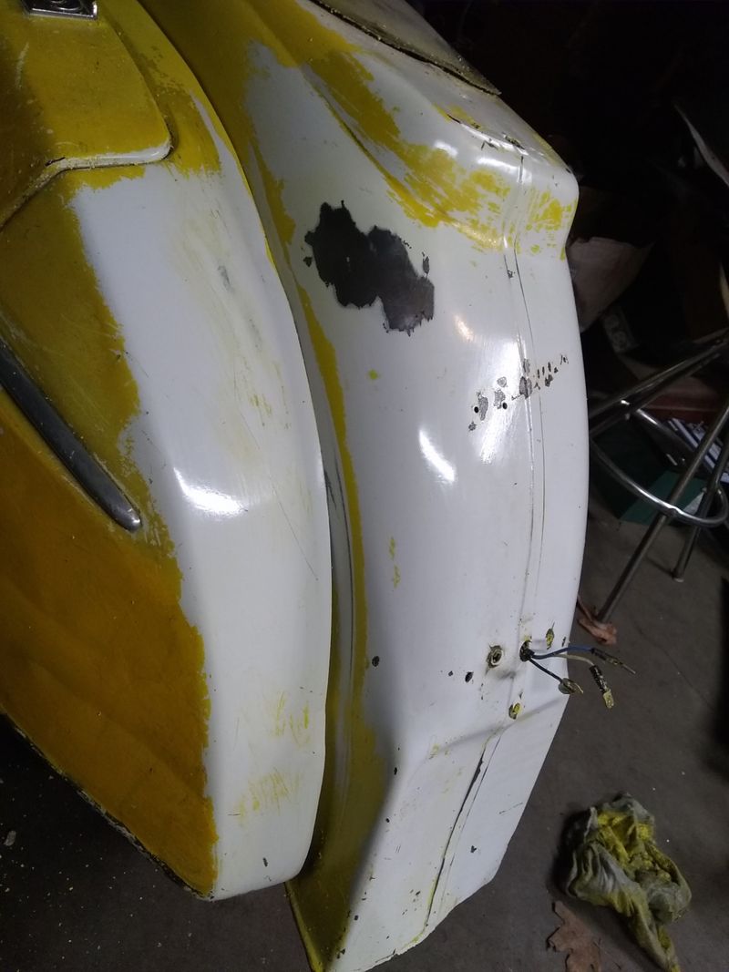

I found that this CRC gasket remover works wonders. It softens up the yellow spray paint but doesn't do anything to the tough original white but shine it up nice. Still a lot of scoot to get the yellow off of. Just takes enough time.
the yellow paint sort of curdles and then wipes off fairly clean as the rag shows
you can see the gasket remover sort of stays in place & doesn't just run down and the yellow bubble up loose

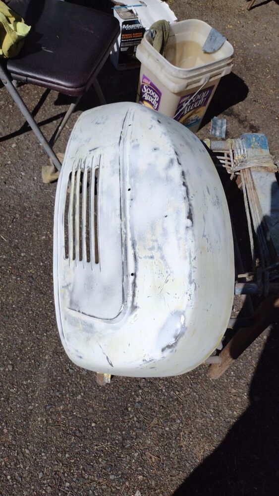

Dept. of loverubs

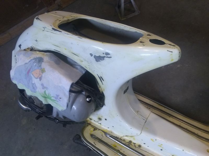

Mealtime's over, kids, back to work. This time mostly acetone loverubs because I have a gallon and I want to save the spray on stuff for touch up and hard to get places. The acetone with a 2" paintbrush w/ a lot of scrubbing action and a wiping rag to follow , then a cleaner rag soaked in a little acetone to wipe it down works well on this old yellow paint.
So two silver linings here so far besides that I can even get this stuff off fairly well w/ some elbow grease. First the painter forgot to sand the surface before painting but seems to have cleaned it very well and second, the yellow probably protected the OG paint for some years, where it's not worn in a few spots or flaked back in small places it seems to be nice and deep and no serious damage areas either.
I expect to spot fog some matched paint on the biggest owies and a artist brush on the little patches on the floor. No need to make like it's brand new, I'm not either and we'll match nicely this way. Then I'll use an orbital polisher w/ mild buffing and cleaning creme then some old fashioned carnauba wax to finish. That's the plan anyway.
Oh, and also gonna convert the front to 10" for now, maybe for keeps. Be ready to roll serious before you know it w/ massive 5 port reed valved power on tap! Oh Ginchy, where are you ol' buddy. Mr. 10" Super?

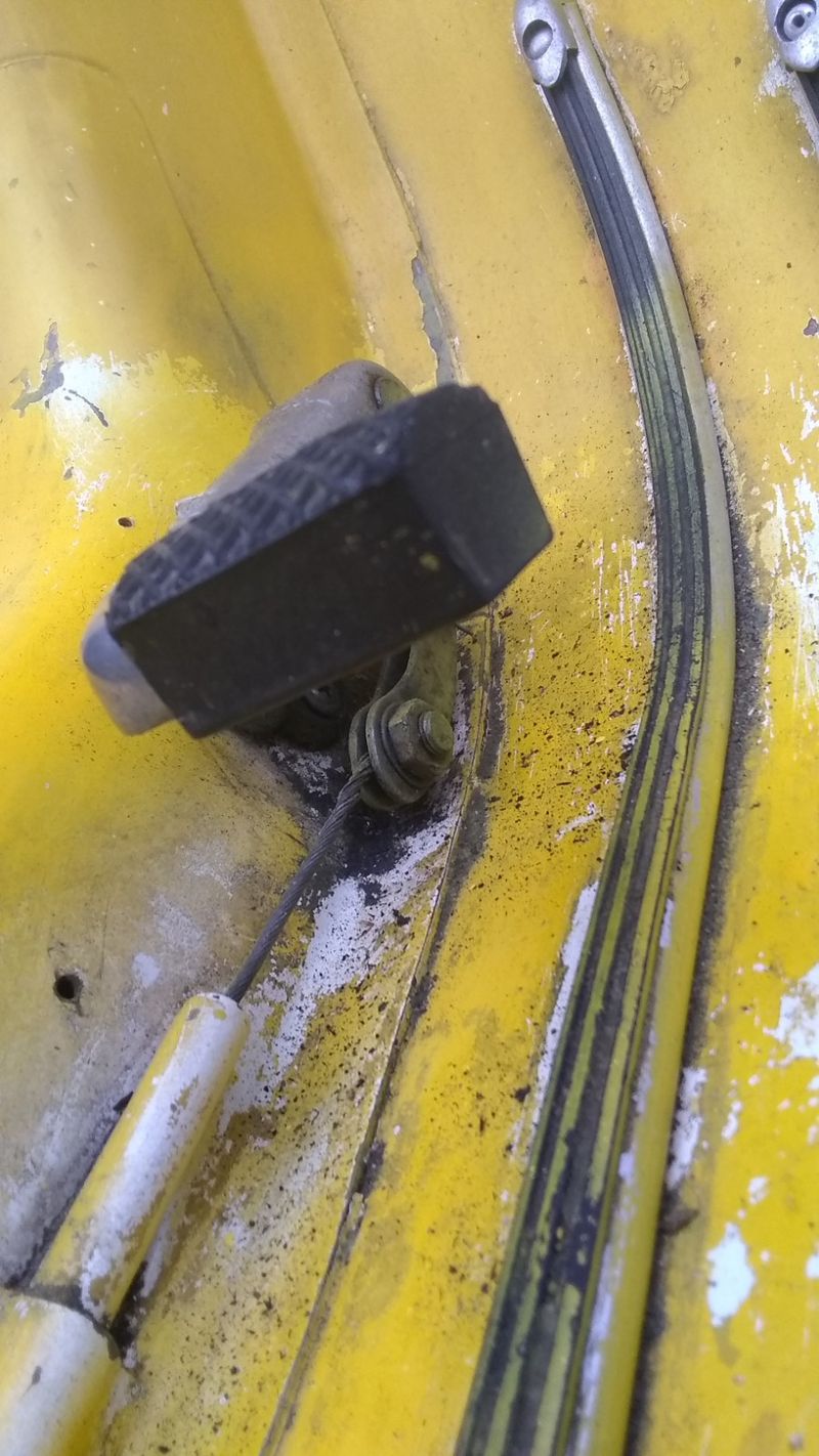

getting the brake pedal off was fun
had to pull the rubber strip out  to get the pedal low enough, but not the  trim strip, phew
getting the brake pedal off was fun had to pull the rubber strip out to get the pedal low enough, but not the trim strip, phew

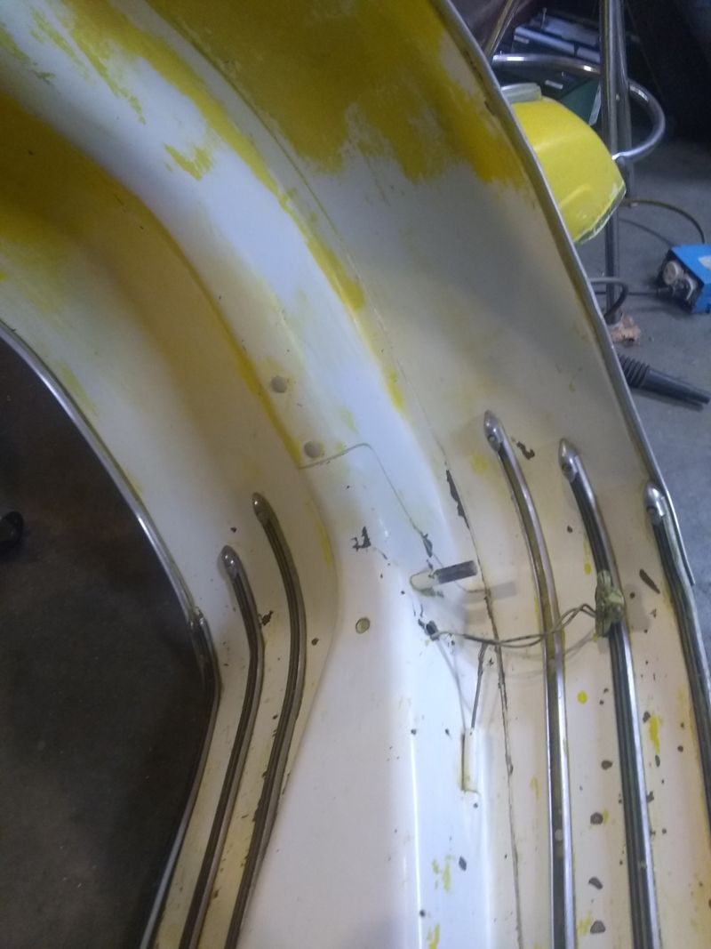

a little wear  but mostly good sound old paint
hey there, Eeyore lil buddy
a little wear but mostly good sound old paint hey there, Eeyore lil buddy
bottom's pretty good, even the paint
should clean up well enough for just  clearcoat  and done
bottom's pretty good, even the paint should clean up well enough for just clearcoat and done
motor cavity is impressively unfilthy
Posts: 10075
Posts: 10075
5 pic limit so here's the top of the floor & inside the mudguard

That's coming of nice! Remembers me of the days and days of aceton and paint stripper on mine.. i had 3 layers of paint over the original, of which the black one was a real sucker...

The paint is coming off nicely.
