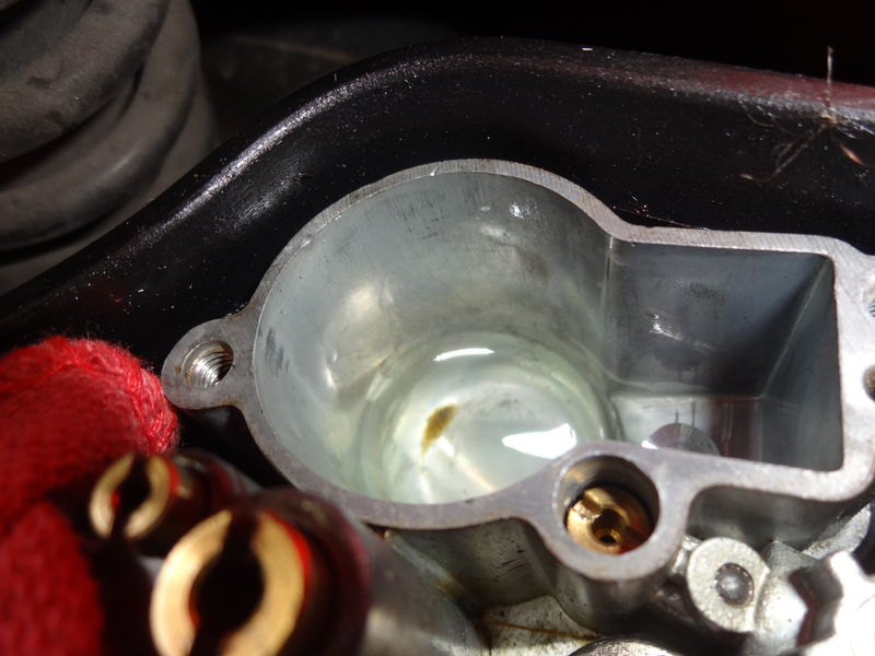

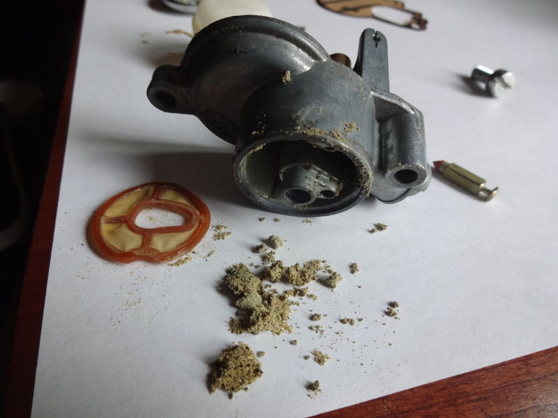

My US 2005 PX150 has been running great since I got the jetting dialed in. However, yesterday when I tried to start it, it ran rather poorly. It would not idle, it would bog off of throttle, and I had considerable four stroking while cruising at around 35 mph. It was difficult to keep it idling at a stop. So I removed the float bowl cover assembly to check out the needle, etc. Below is a photo of what I found in the upper chamber of the float bowl assembly. There was a considerable amount of sandy-like crud in that chamber. Some of it also passed the little filter and got into the float bowl. I will replace this assembly shortly. The fuel I use is a 93 octane 10% ethanol gasoline. I did add the Star Tron additive at each fill up.The bike sat for 15 years with 368 miles on it before I got it. I have put 4000 miles on it before I checked the float bowl assembly.
I would like to know what caused this crud and where it came from. Was it the long storage, the ethanol fuel, the additive I used, or perhaps the lining in the fuel tank? If anyone has a good explanation, I would appreciate hearing from you.
Crud removed from float bowl assembly after 4000 miles.
Crud in bottom of float bowl.

This happened to mine 20 years ago, when I was living in New Mexico. That crud looks just like sand; the scooter started to run intermittently and very badly shortly after filling the tank.
I called the gas station where I filled up to make a complaint; the manager offered to have the scooter worked on at their expense at a motorcycle shop.
I did not trust any of the local Japanese or Harley shops to work on it, so I fixed it myself. I drained and cleaned the tank, replaced the fuel tap and cleaned and rebuilt the carb. I filtered the drained gasoline through a fine cloth and it sure looked like sand from the desert, but used it later in the lawn mower without further issues.

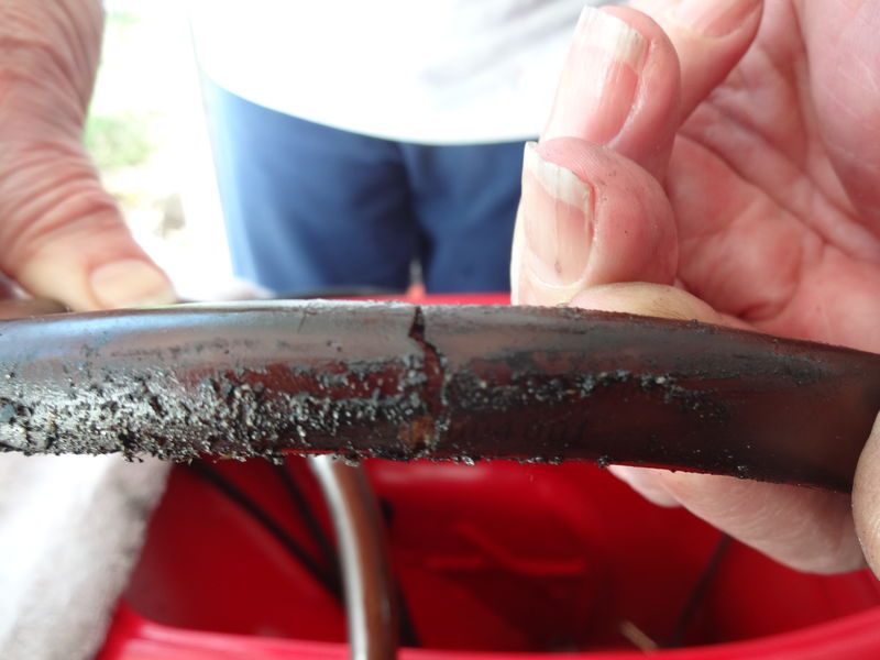

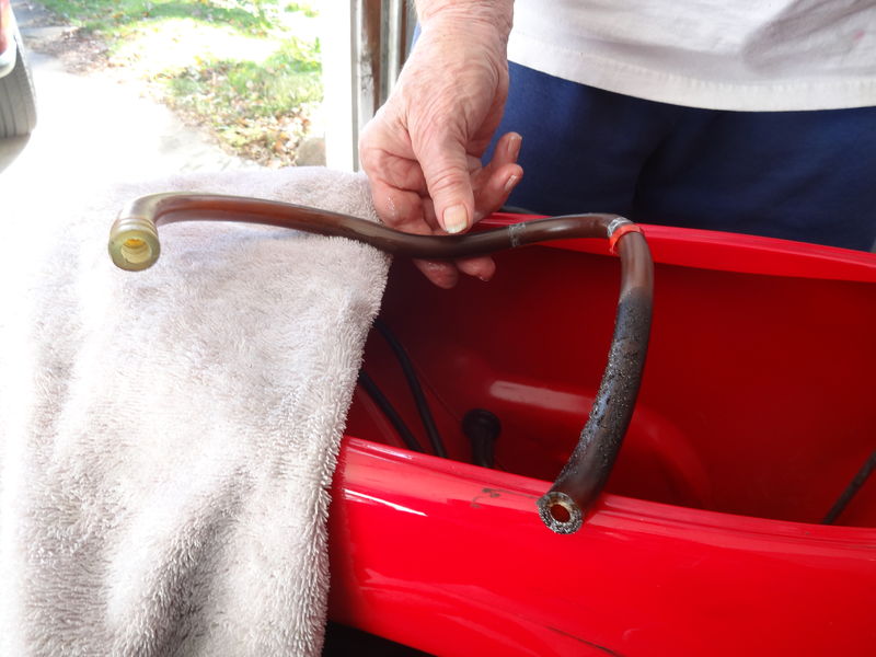

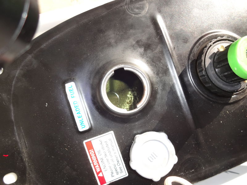

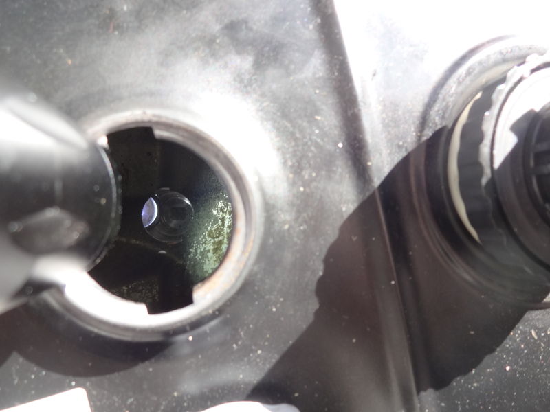

I decided to pull the tank and check out the fuel and oil lines. The US 2005 PX150 is 14 years old with only 4000 miles on it. What I found was a terrible fuel line with a large crack in it. The line was somewhat pliable but really in bad shape. Even the spring clamp at the tap had slide down the fuel line. I will replace this fuel line with a new OEM fuel line from Piaggio. The oil line seemed okay but will be replaced as well.
Looking into the fuel tank, I can see some sediment. There appears to be no rust. Perhaps this sediment is the source of the crud I found in the float bowl assembly. Just how to proceed in cleaning the tank I am not sure. If someone has a good method, I would like to hear it.
The bottom line is the fuel system in a 14 year old PX150 with just 4000 miles is a mess from the fuel tank to the carburetor. Did age or the ethanol fuel cause these problems? I do not know.

Sediment in bottom of fuel tank.

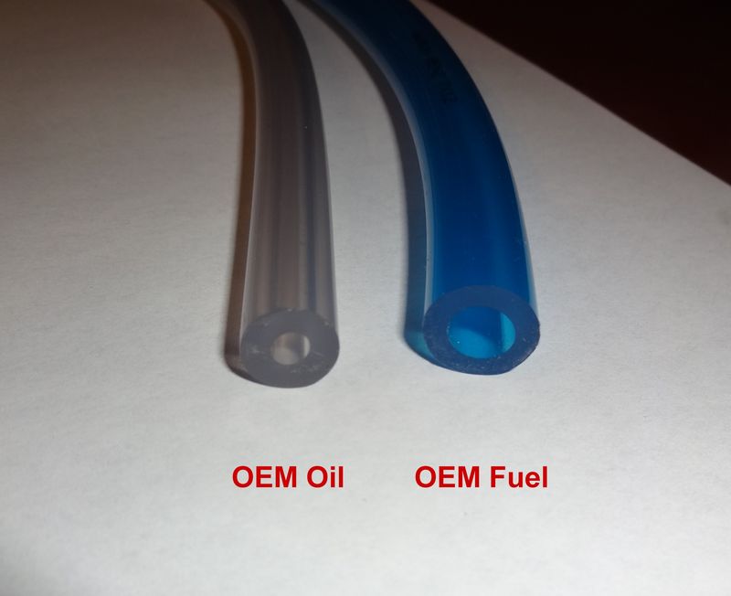

Tierney wrote:
http://www.scootermercato.com/Scooter-Parts/Fuel-Taps-and-Parts/FUELLINE
Thank you for your input Tierney. I have one of those fuel lines from Scootermercato but plan to install the Piaggio OEM fuel and oil lines instead. The Piaggio fuel line is 27 inches long making it easier to install. It also has very thick walls and will not collapse when bent. The Piaggio oil line also has very thick walls. In addition, I can use the spring clamps on both of these lines. I got these parts at Scooterwest. They are more costly but I feel overall, they are the better lines. Only time will tell but if they go another 14 years, I will be pleased.
Piaggio OEM oil and fuel lines.

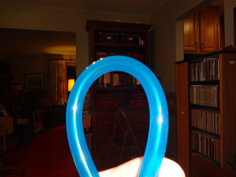

Piaggio OEM fuel line will not collapse when bent.

looks like Tygon fuel hose, top of the line stuff.

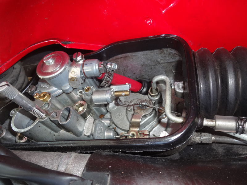

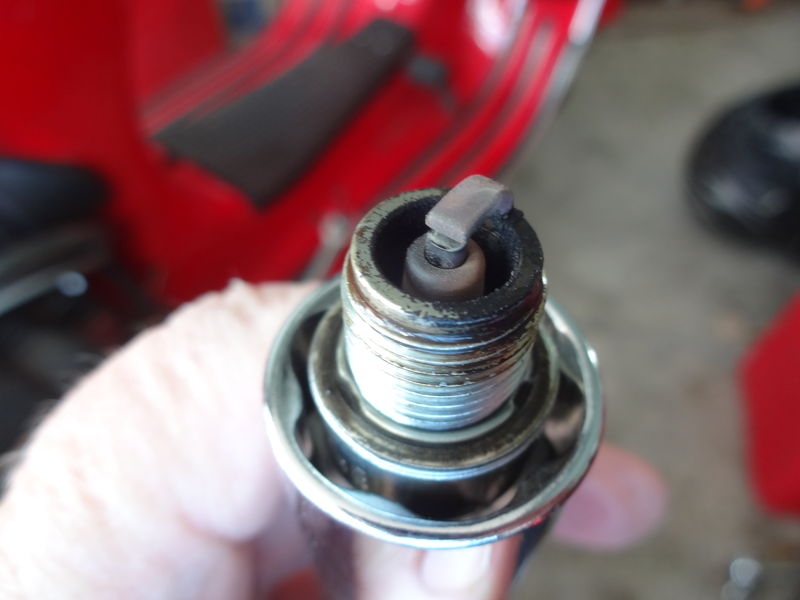

I installed a new fuel and oil line on my US 2005 PX150. The fuel line I used was a Helix racing line that has no plastisizers and will not harden with time. I also cleaned the float bowl assembly. Then I made a main jet stack with the following: 106/BE5/150 and slow idle jet of 45/140. I chose the BE5/150 combo since I want a richer mid range and the BE5 mixer is what SIP recommends when using a 150 air. I also trimmed back the slow idle jet from a 55/160 to a slightly lesser 45/140. I was getting some four stroking riding around 35 mph and felt the 55/160 was a bit too rich for my riding style.
The test ride was amazing. There was no four stroking at any cruising speed. The bike took off and was very strong up through the gears. I got up to 56 mph and it just hummed along with no problems. A photo of the plug with just 20 miles is attached. It was certainly richer than the previous tests using the 102 main. It was a little wet and may be on the rich side. But the way the bike performed, I can live with that.
So it appears to me that I have been under jetted in the main jet with a SIP Road 2 muffler and drilled air filter, the usual 102 must be increased. I am at 106, which is 8% above the stock jet, and it runs great. (SIP recommends using a jet between 5 and 10% over the stock jet for a Road 2 muffler.) I have a 104 jet coming and will try it as well. But for now, the 106 is working great.

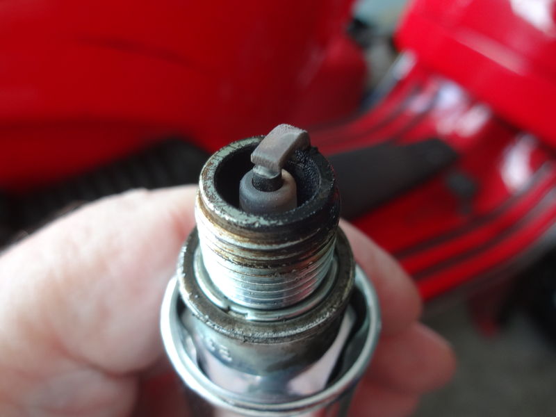

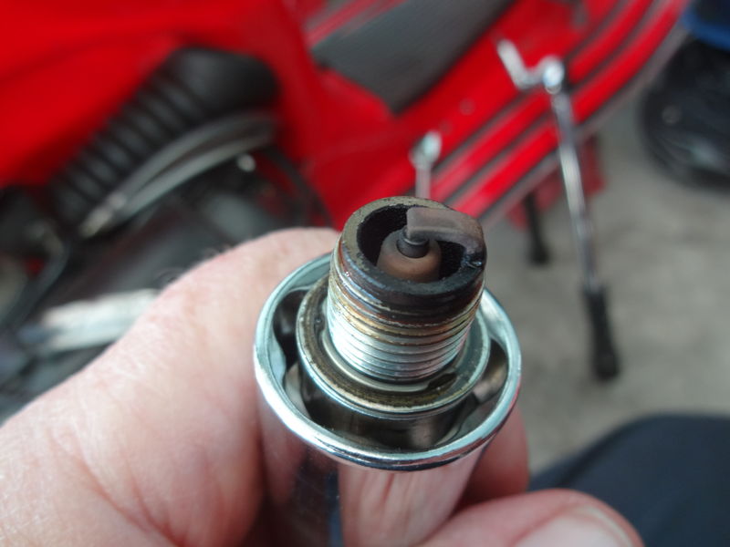

I felt the 106 main jet was a little too rich for the 2005 PX150 with SIP Road 2 muffler and drilled air filter. Therefore, I tried a 103 and 104 main with the BE5/150 combo and 45/140slow idle jet. The bike ran well with both, however, the 103 seem to have a better overall response. The 103 is also within the SIP recommended range (5 to 10%) for installing the Road 2 muffler. With the 103, it was 5% over the stock 98 jet. The spark plugs for both the 103 and 104 main jets are shown and are very similar. They both look good.
I still want to try the 103-104/BE3/160 stacks with the 45/140 slow idle jet. Weather permitting, I should get that done this week.
Plug after 20 miles with the 103/BE5/150 main jet stack and the 45/140 slow idle jet.
Plug after 20 miles with the 104/BE5/150 main jet stack and the 45/140 slow idle jet.

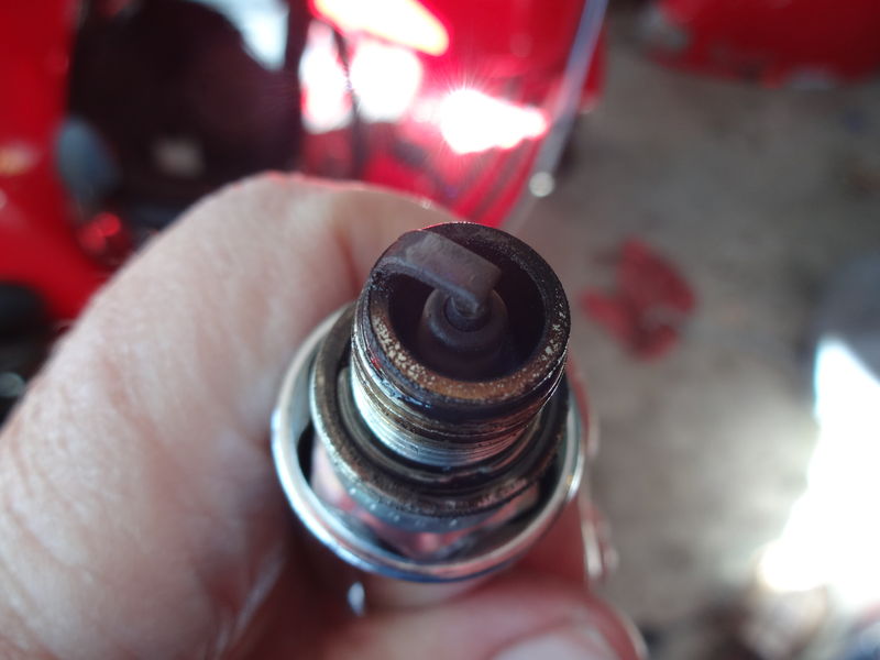

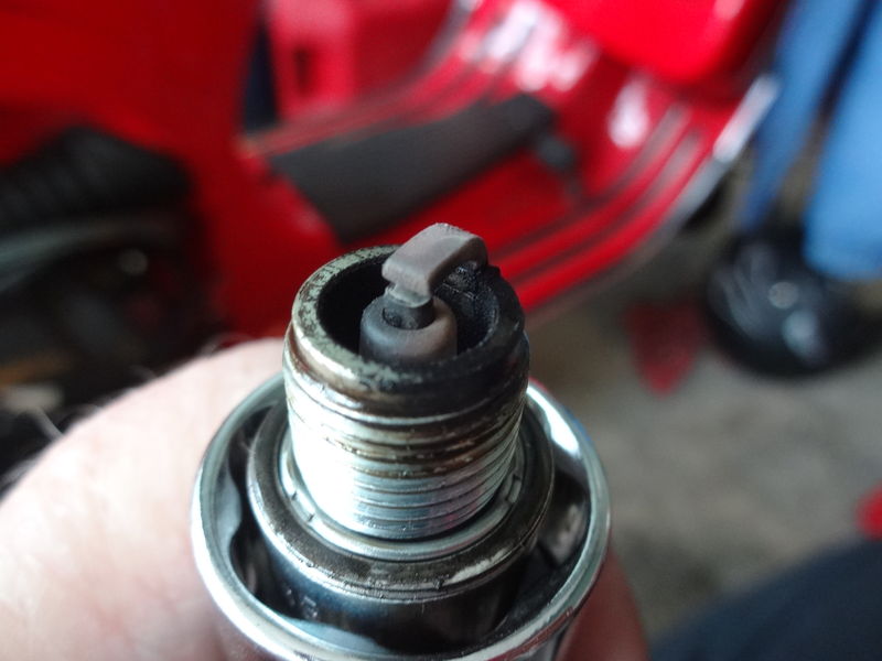

I was able to test the 104/BE3/160 stack today. Overall, the bike performed superbly well and there was no four stroking while cruising at 35 mph on a level road. It responded quickly to the throttle and there was no bogging or "fuel starvation" issues at 55 mph. Overall, this seems to be the best combo so far. The 104 main jet is about 6% larger than the stock 98 main. The slow idle jet was the 45/140 which is slightly leaner than the usual 55/160. This jet was chosen to minimize the four stroking in the low throttle range. Going from a BE5 to a BE3 also help lean out the low to mid range. The low to mid range is, however, still richer than what I had at the time of the soft seize. Increasing the main jet to 104 and using the BE3 and 45/140 seemed to reduce the lean condition that lead to the soft seize.
The plug is shown below and is starting to get the brownish tan color on the electrode. It does not appear to be too rich nor too lean. It looks quite good.

Plug after 20 miles with the 104/BE3/160 main jet stack and the 45/140 slow idle jet.

Why are you using a resistor-type plug? Unless, it is called for in the owner's manual to have R type plugs, the plug cap should be a 5K Ohm type, which means that, by coupling it to R type plugs you have 2 resistors in series in the ignition lead, which could possibly generate a weaker spark.
On my 1985 PX it calls for a standard plug, either NGK B6ES or B7 ES, and the cap is a 5 K ohm type.

The owners manual for the US 2005 PX150 recommends the use of a resistor spark plug. The spark plug wire goes directly to the spark plug and there are no plug caps used.
