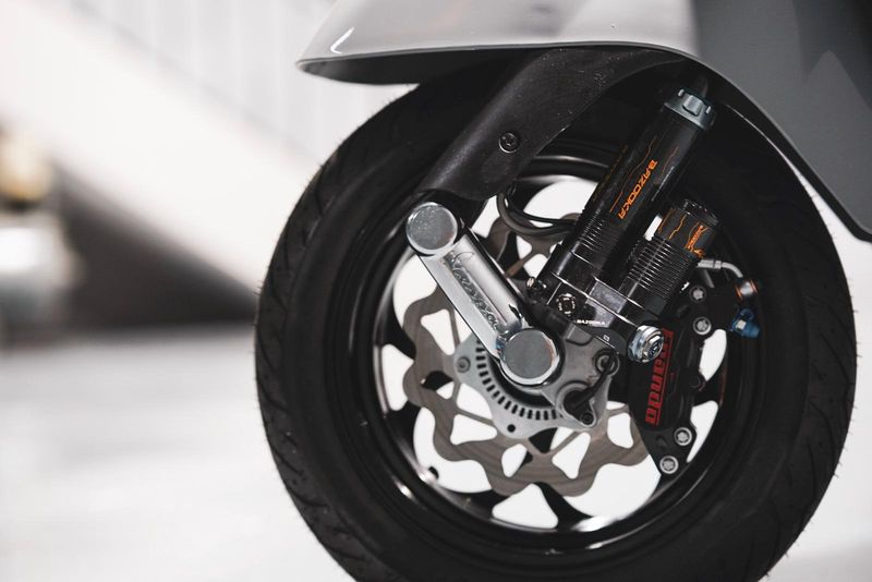

]You dont need to do anything else but change your front shock to a proper shock and it won't wobble.
Have a look at my posting.
https://modernvespa.com/forum/post2387507#2387507
flag edit X quote
Here is the new 4.0 bazooka on Supertech.
Problem is with coil shock, most of the time the spring is not rated to individual weight and most brand when buying their shock are not given a choice off spring. There is no 1 spring for all. Almost every aftermarket shock especially designer shock (Example, zelioni etc does no testing and have no facilities to test their shock. Its all outsource to a manufacturer) including bgm that i have to tune for customer, 99% are not able to even set the Sag correctly due to wrong rated spring etc. Nothing else can be set if the basic of sag cannot be set correctly.
So if you would to ask me, i would say most people are spending money to make their suspension worst. Bazooka air shock is just like your tire,it does leak a bit. you would check it lke how you would check your tire pressure. My bazooka from my old vespa still works perfectly after more than 3 years. You can even send it in for maintenance where all your internal parts will be change, with proper care, it could last you a lifetime.
Its around 40% lighter than stock, with that saving in weight, it translate into more power for your bike and your front end will feel as lot more nimble. I am sure everyone knows about the infamous vespa front end wobble . It will wobble regardless its the current front end setup or the 14-17 macpherson strut setup, it will wobble. Just try letting go both of your hands and see what it does. I tried a few suspension setup and i can say only bazooka i can safely do let go of my hands and it will self correct itself and will not wobble. Have as look at the video, do note my left hand is holding my phone for recording and that is the furthest back i could go to take the video, i can do a longer video without hands if you want.
To me, its no brainer. Either you buy a proper shock that improve your ride the first time or you buy a cheaper shock that doesnt work and then spend more money on a shock that work. If you are only into aesthetic, then use whatever shocks you fancy but be ready for rough ride.[/quote][/quote]

OK now you are officially spamming.
yummyburger has been ejected from this topic
