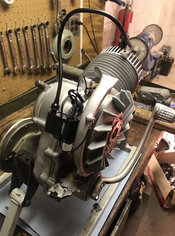

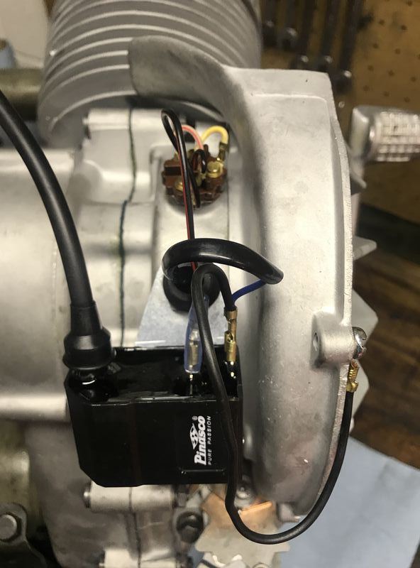

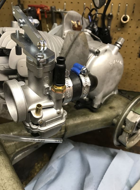

here are some options:
Enjoy

Thanks Voodoo.
You now have several quality options to choose from: Pinasco 160 and CC Corsa 160. Either can be ran with a 57 or 60mm crank. My personal bikes are running a 57mm Pinasco crank and a 60mm KingWelle crank; so a stroked cylinder is possible!
That being said, Widebody's are not for everyone-they are not inexpensive to say the least. Beside a cylinder kit, you will need to purchase a crank, variable timing ignition, clutch, primary gear, carb, exhaust. . . You would be looking at roughly 1800 when all is said and done. Then you get the honor of purchasing all your wear & tear items such as gaskets, seals, bearings, cruciform, rubber parts, etc. etc.
I work on these engines regularly and fortunate enough to have full set of original factory tools to service them correctly. All parts that i have mentioned i do stock and are in stock. Builds to full technical support offered.
Not a whole lot of Widebody talk around these parts. I am always available @ https://www.facebook.com/GickSpeed/ and https://www.instagram.com/gickspeed/
