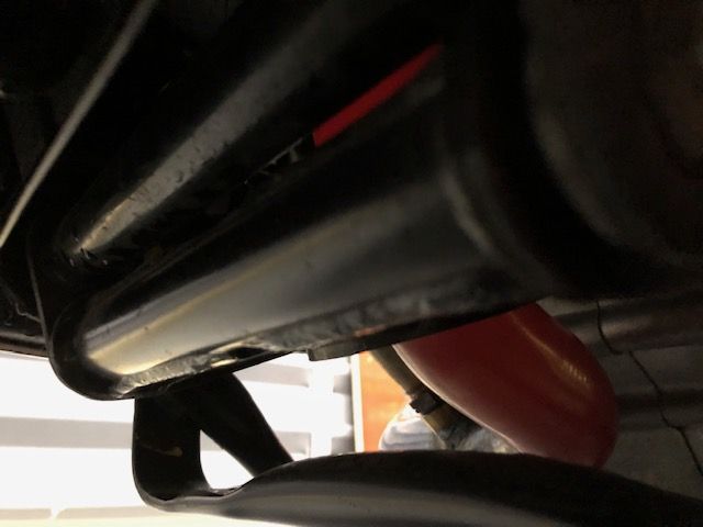

Hello,
MP3 500 HPE Sport 2019, 2000 kms.
From cold start idling 3mins. the exhaust manifold from the head about 4-5 inches is glowing cherry red.
Same in ECO or Normal mode.
Checked one of the spark plugs (NGK MR7BI 8 ) looks normal, not burnt.
Idling is steady about 1700 rpm, running ok, when the clutch disengages eg., going slow down hill there is some spitting/"burbling" in the exhaust
Is this normal?
Thanks!

Exhaust picture 2 mins after cold start
Exhaust picture
Exhaust picture
Hello BJN. That doesnot look normal. As I recall, you also said that your roller idles at 1700 rpms. Am I right? In any case,that's too high ! Wha? emoticon You'er rpms should be somewhere between 1250 and 1500. If your current dealer can't or wont help you,then seak out another Dealer!

Yes, that's very wrong. I wouldn't run the bike in that condition.
Posts: 1001
Location: tampa
Posts: 1001
Location: tampa
it means your combustion event in the cylinder is happening too late in the cycle. the combustion process isnt complete when the exhaust valve opens. combustion heat is easily able to turn the pipes red hot.
this can mean spark timing is too far retarded. it can also mean mechanical timing set wrong.
not likely catalytic related with such low mileage. severely clogged exhaust will stall engine.
it needs immediate attention and shouldnt be driven. you will burn exhaust valves.

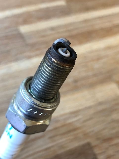

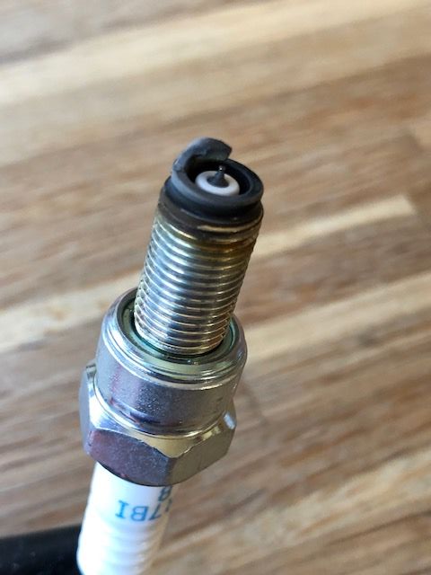

Spark Plug
fuel consumption:last driven
km: 35
average: 29,6 km liter
average speed:52 km hour
The driven 35 kms where from sea level to 300 meters above, (up and down) on twisty roads, max speed was 90 kmh.
spark plug
spark plug

Spark Plug 2 inboard
spark plug inboard
spark plug inboard

Just never saw this before.
Keith,
Marietta, GA
Posts: 1001
Location: tampa
Posts: 1001
Location: tampa
thats a really fabulous photo.

Looking at the spark plugs, I believe the fuel mixture is too rich .
Posts: 45735
Posts: 45735
How so? To tell from the spark plug you have to look at the lower part of the insulator - which isn't visible in those pics. Going just by the upper part, it looks as though it's far too lean a mixture - which is odd considering the FI...
