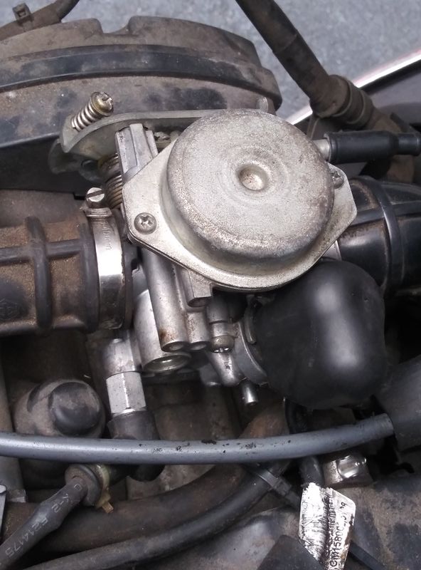

I recently acquired A 2010 LX50 4V that had been sitting a couple of years. Got it running for less than $2. That's the good part. Now little issues are coming up and I'm trying to address them. After function ok for a couple of weeks of short rides, the idle speed has gone way up practically overnight. When I now ride it I have to brake hard to stop. It's manageable but needs fixed. I can't seem to find any real info on an idle speed adjustment screw. It's not the throttle cable. That's fine.

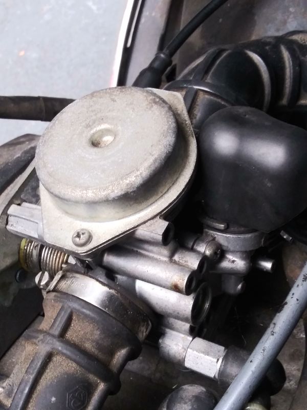

Your idle screw is the one in the first picture with the spring under it. To. get the idle set right get the engine warmed up and be sure that the enricher is closed. to do it properly you really need a tachometer, they are relatively cheap I use one like this https://www.amazon.com/Resettable-Inductive-Tachometer-Motorcycle-Snowmobile/dp/B01CR2IC2Q/ref=sr_1_5?crid=27LAVBENCPYX2&keywords=digital+tachometer+small+engine&qid=1571493967&sprefix=digital+tacho%2Caps%2C138&sr=8-5. turning the screw in will raise the RPM and out will lower it. The RPM's should be 1900-2000rpm. Be sure you have the correct setting on the Tachometer, they are for 2 and 4 stroke engines. The problem could also be an air leak that could be creating a lean condition. be sure all of the hose clamps are tight.

Ok. Now the only problem with that screw is that it's already backed out all the way. That was the first thing I went for.
The vacuum leak sounds like a logical next idea, especially since the change happened overnight for no apparent reason.
So next, I'll start it and selectively shoot small bursts of starting fluid in different areas to listen for an RPM increase. I'm thinking that's how I'd find a vacuum leak hole. Make sense?

Could be a clogged jet, or malfunctioning electric choke (the part beneath the round black plastic cover in your first photo). If the choke isn't disengaging, it will affect the idle speed.

I haven't tried on an LX50 carb specifically, but on other similar setups, I've removed the choke but left it plugged it. Turn on ignition, and wait for it to heat up. You should be able to feel it get warm. Once it's at temp, the pin should move in or out (I don't remember the direction off the top of my head). It should move enough that you can see a difference in position.
