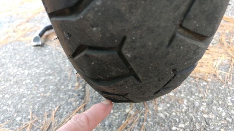

My rear tire is worn funny on one side - any ideas of what would cause that? Could it be an alignment issue? The tire does not feel loose in any way, but it does feel like there's a bit of a wobble at a certain speed. Thanks!

Its the camber of the road that does that.

you probably have a bearing going bad.
road camber is so minor it won't cause abnormal wear unless your on a banked race track.

How many miles on the tire and it's age?
Have you looked at the wear bars on the tread? How do they look?
Do you ride aggressively or like an old man?
On first blush, it just looks like the tire is worn out and needs to be replaced.
My rear Hiedenau tires only last about 6k miles and I don't ride aggressively.

Could just be a balance or air pressure problem.

Check the swinging-arm bearings and the silent blocks. If the whole engine/transmission is tilted or twisted w.r.t. the frame, this can happen.

Could be a mechanical issue or out of alignment. Worth inspecting all the moving parts. Could also be riding style (trail braking or accelerating in the corners). Or could be the model and construction of the tire. I've been through several sets of Michelins on the big bike and they do the same thing every time. Squared off in the middle and sawtooth on the side. You can really feel and hear that sawtooth wear when you bank in to a turn.

The tire just looks worn out to me.

Does your notion of "wobble" mean "vibration". I don't see a worn out tire so much as one slightly worn irregularly. Does the tire have "TWI" molded on it. That tire still has mold vent tits on it near the shoulder. See the 2nd one in from the CS base.
All discussion aside, in NH you'll be stopped for winter so simply replace it this winter while the best time is at hand. Not like they cost hundreds of dollars each, like my new PU truck Michelins.
OP/you feel or have someone experienced "feel" the bearing for notchyness or looseness. odds are very strongly in favor of the bearing being OK and you need a tire that rides better.

Normal wear.
The blocks of rubber deform and wear higher on the leading edge of the forces applied. If you ride like me, block wear is quite dramatic. I now purchase tires that generally do not have blocks, rather have wide strips. The wide strips of rubber deform less but still wear more on the leading edge of highest forces.
Handling is effected by wear. These tires will handle a bit different from when they were new. They may also make a different sound when ridden on their side than straight up.

It looks to me as though that is just tyre wear caused by the road camber. In your area are the roads cambered predominately on the routes you travel? We drive on the left over my side of the pond as you will know. It means the right side of our tyres can wear down a bit quicker than the left side especially if someone lives in an area where the roads are quite cambered towards the sidewalk (pavement as we call it). It will make your bike handle slightly differently and that may be what you can feel.

I am more comfortable turning left and do so more aggressively and with more throttle. This results in more wear on that side. My 2 cents

Tony, lets hear what car tire? Road camber is a factor. In my area, eastern KY, virtually every road is curvy. In my county, the two "straights" actually have names. On 4 wheel vehicles the front steering tires wear off on the outside rather fast. On two wheels many of us are more inclined to take a curve with a hard lean-I've never known what human factor cause that but I'm that way too.
