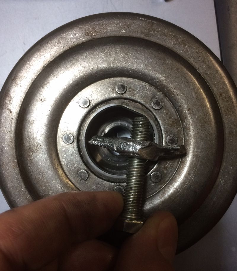

I made a little tool to pull clutches off easily with a screw and a little piece of alloy, which I insert under the clutch and screw against the crank to lift off the clutch, which saves me a lot of time whenever I have to work on a clutch or disassemble an engine. I'll post a pic if anyone's interested.

I made a little tutorial for those interested in more details
Here's the "tool":
It looks grossly made because it was done in an emergency, and it's so well served its purpose ever since that I've never felt the need to make a more presentable version Razz emoticon but rest assured it pulls even the most stubborn clutches in seconds, every time.

VERY grossly made, but... Solid welds! Clap emoticon
Tnx again. Gonna weld me a nut to a stout piece of flat bar w/ a hole in it.
Should work.
