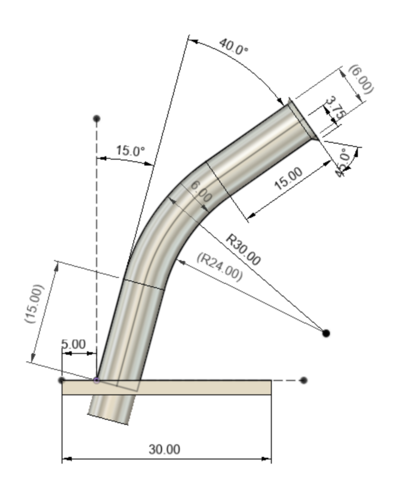

Almost lost the pin on my Rally cowl this past weekend, but caught it on time.
Before having it welded up I took the following measurements off the old pin to use for any future repairs.
