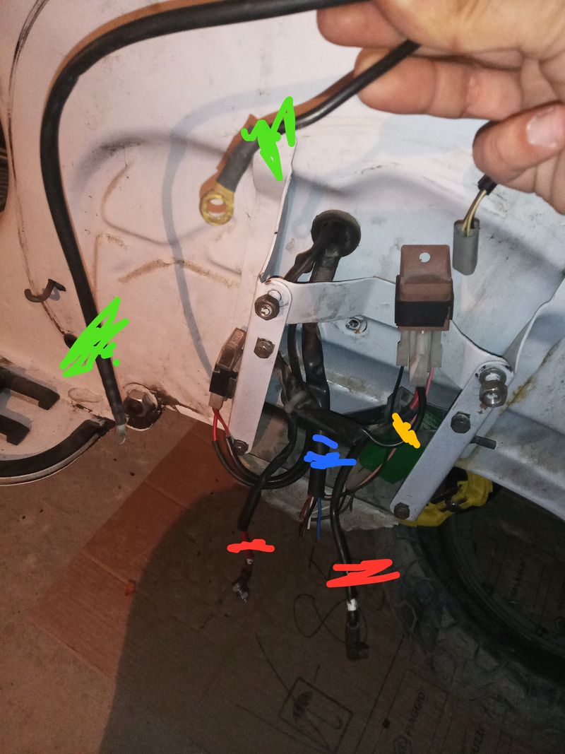

Hello friends,
I have a problem with wiring loom. I dont kniw this cable.
Blue - voltage regulator
Red - baterry
Yellow- indicator and start
Green-??????????

Looks like the ground wire that connects to the screw that hold the regulator.

I'd guess the thicker one goes to the electric starter motor and the smaller one goes to the voltage regulator mounting screws like Rowdy said.
