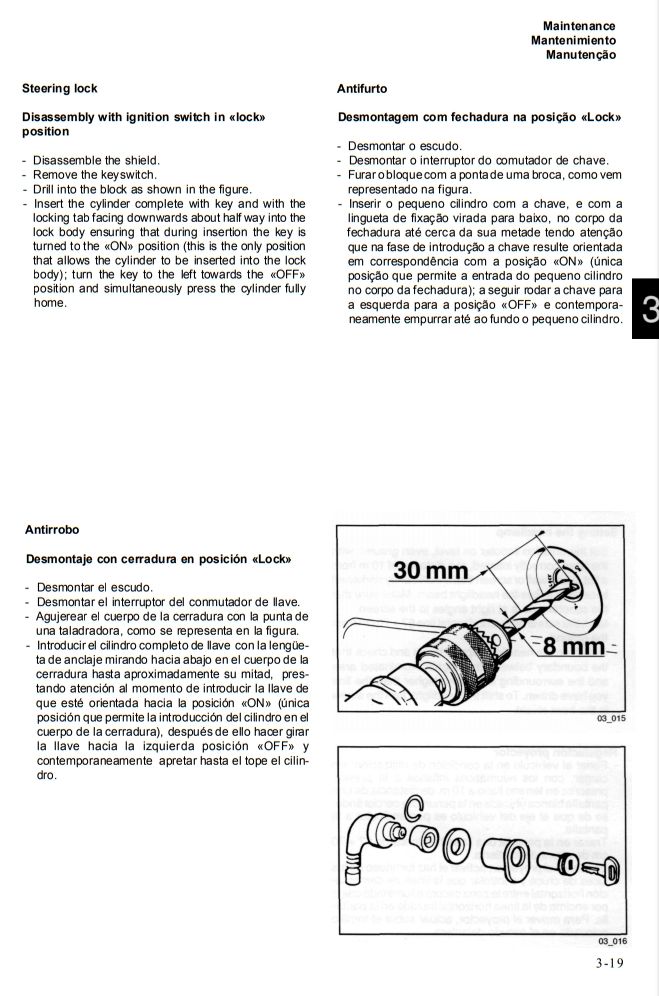

If it's in the locked position, it needs to be drilled out.
From an ancient X9 manual:

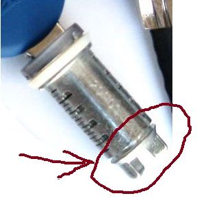

And if you look at the new tumblers, on the end away from the key, you will see a groove. This is what the clip holds in. So if you look at the slot on the top of the barrel the tumbler is in, you can push the tumbler in until you see a small wire that looks like a staple, holding it in. Pull that out. Then drill the tumbler out, and you can pull it straight out.
Here is where it goes, below is what it is, then where it is.
