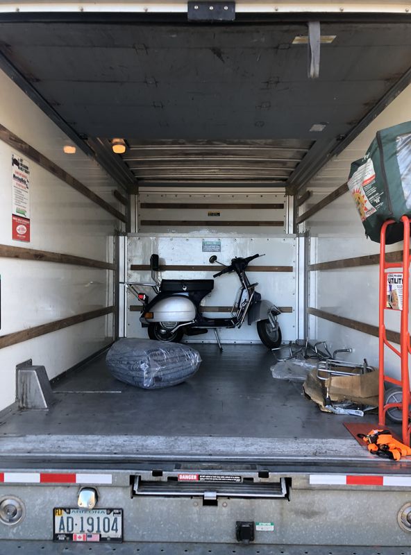

Well, it was definitely worth it. Titled and trucked home for less than $1250.
It's a '79, by the way.

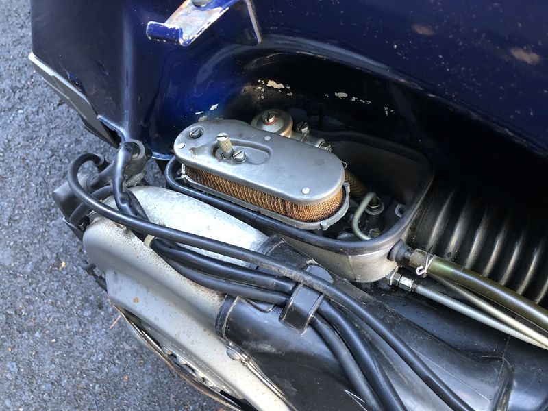

Cleaned it up, reset the carb via this tutorial:
http://www.vespamaintenance.com/fuel/carbtune/
and it started right up!
Front brake is non-existent.
Bogging some, but Ok to drive around the neighborhood. Seems fun! Can't wait to get a new battery and carb kit.
Suggestions on which kit to buy and the best place to learn about rebuilding it?
Thanks, u-haul.
Thanks, u-haul.

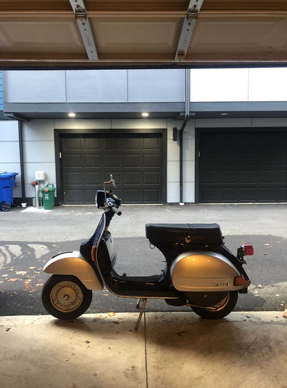

Pretty clean
Pretty clean
Removed all the extra chrome
parallelogramerist
Posts: 6021
parallelogramerist
Posts: 6021
Congratulations on getting the P! Non-existant front brakes can be quite common on a P. The are a few things that cost little to nothing that might make them work better. Second is that it might need a new front brake cable, but first i would remove the brake hub and lube the brake shoe and linkage pivots. Then skuff up the brake drum with some sandpaper. Something around an 80 grit would work well. I would also brake the glaze on the brake shoes themselves (if there is still a lining on them) with the 80 grit as well (don't breath the dust). Then slap it all back together. If that doesn't work, then replace the brake shoes. If that doesn't work, convert to a disc brake and be done with weak brakes forever.
I'd also remove that chrome exhaust pipe extension. Not because of looks, but because it will probably mess with your jetting.
