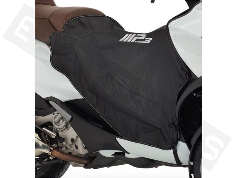

Is that a winter heated blanket that goes under the `tablier` ? I ride a lot in the cold.. I immagine it would be usefull. Do you have a picture with that? how do you mount it? How to you connect it to the dash buttons?
2015 MP3 500 ie Business
Posts: 1372
Posts: 1372

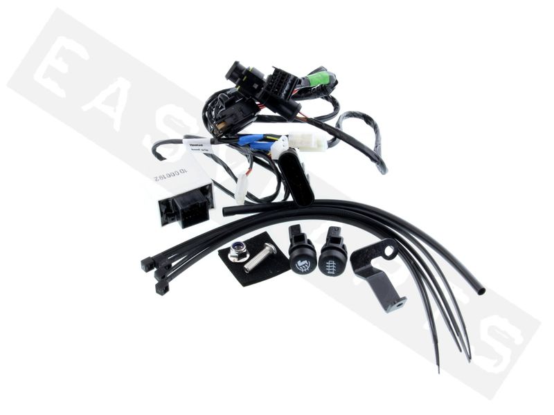

It is a heating pad that attaches to the inside of the Piaggio cover. Can't say if it would work for other covers. However, I never use this thing. I tried it once, and felt trapped and claustrophobic. I want to put my feet down when stopped. Probably mentally scarred from too many decades riding.
It is electrically connected to the harness used for the (optional) heated grips. You have to remove the plastics around the handlebars to install the harness. It's a medium difficulty install. Just requires some time. The hardest part is routing the plug for the blanket to the rear of the fairing where the coolant expansion tank sits.
