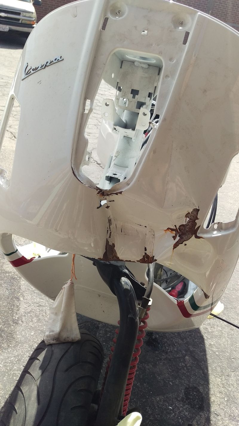

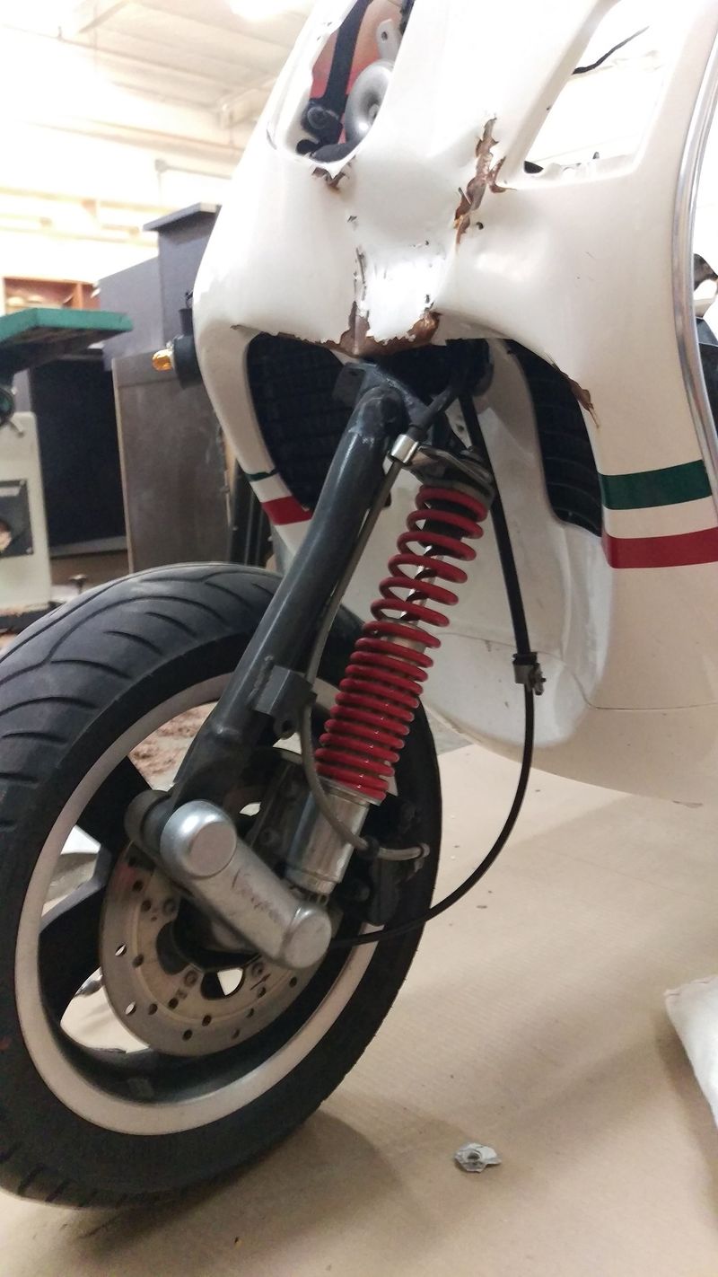

I got a damaged 2010 GTS 300, legshield is the only thing that is damaged real bad. It still rides no problem, but I want to replace it. I have watched videos on youtube of people changing legshield on older model vespas, I can't find much info on GTS models.
Any info/help would be appreciated.

That is part of the welded uni-body which is the frame of the scooter. Major repair. Insurance companies often total out a Vespa with a crunched front end.

How about showing us a pic or two of the damage before you do anything. Perhaps that one can be repaired. I believe the Vespa frames are assembled and welded in a jig to maintain alignment.

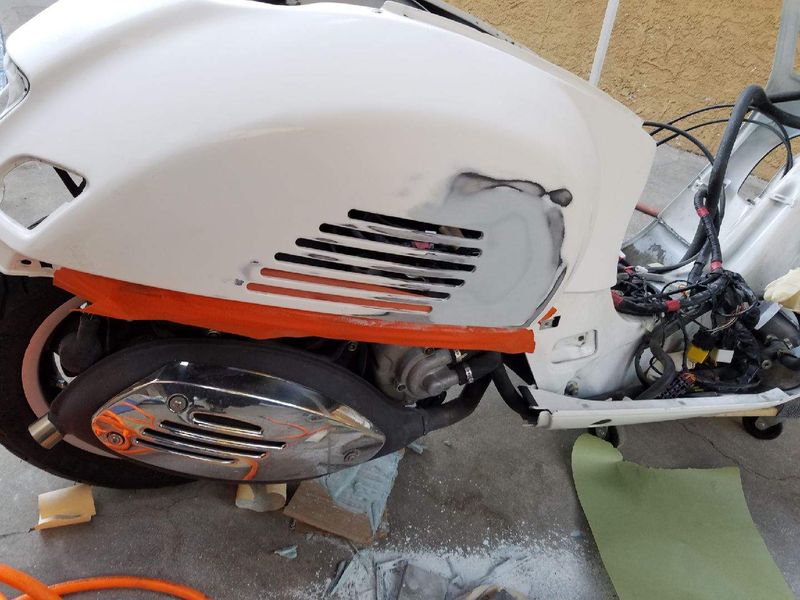

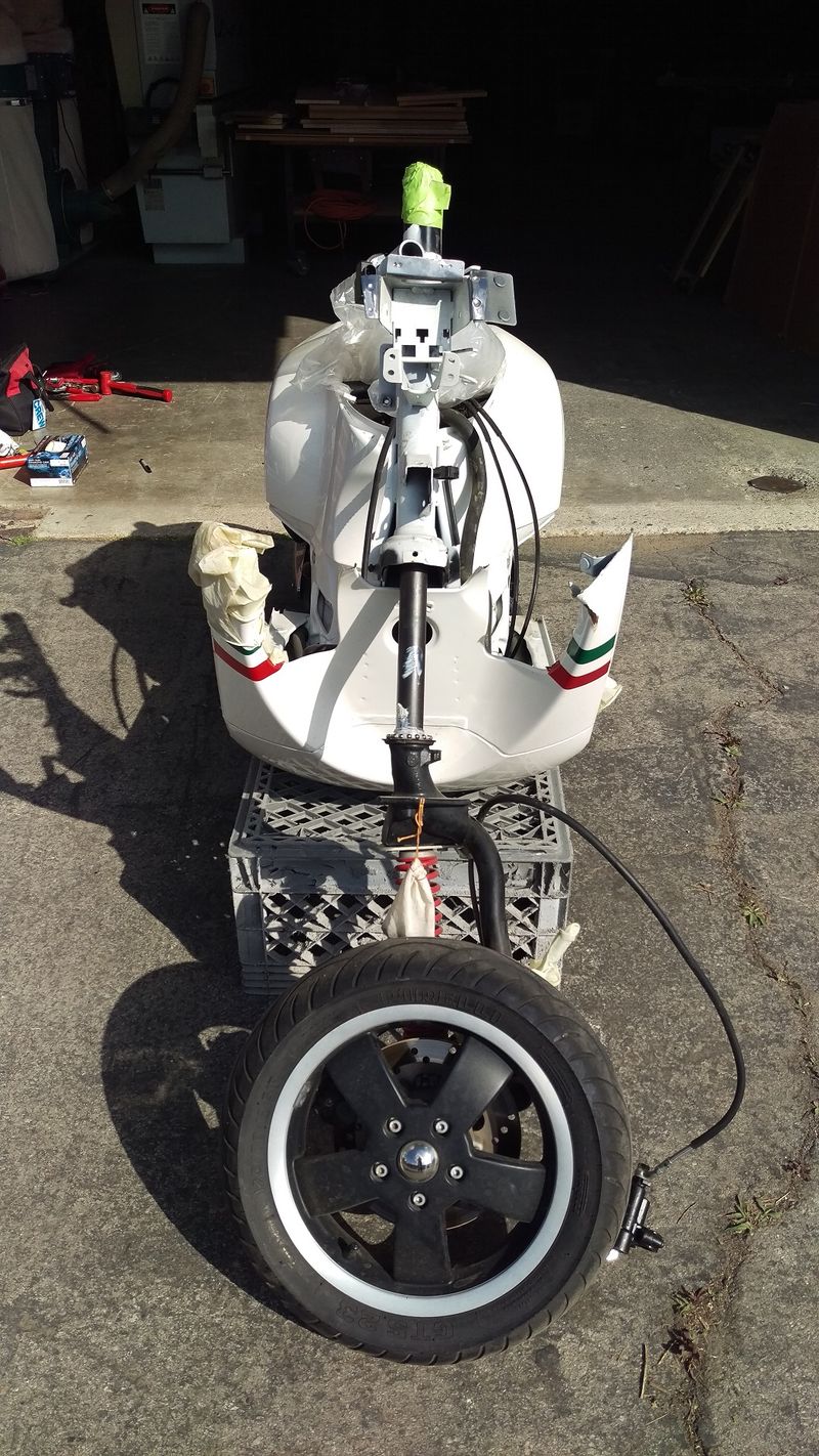

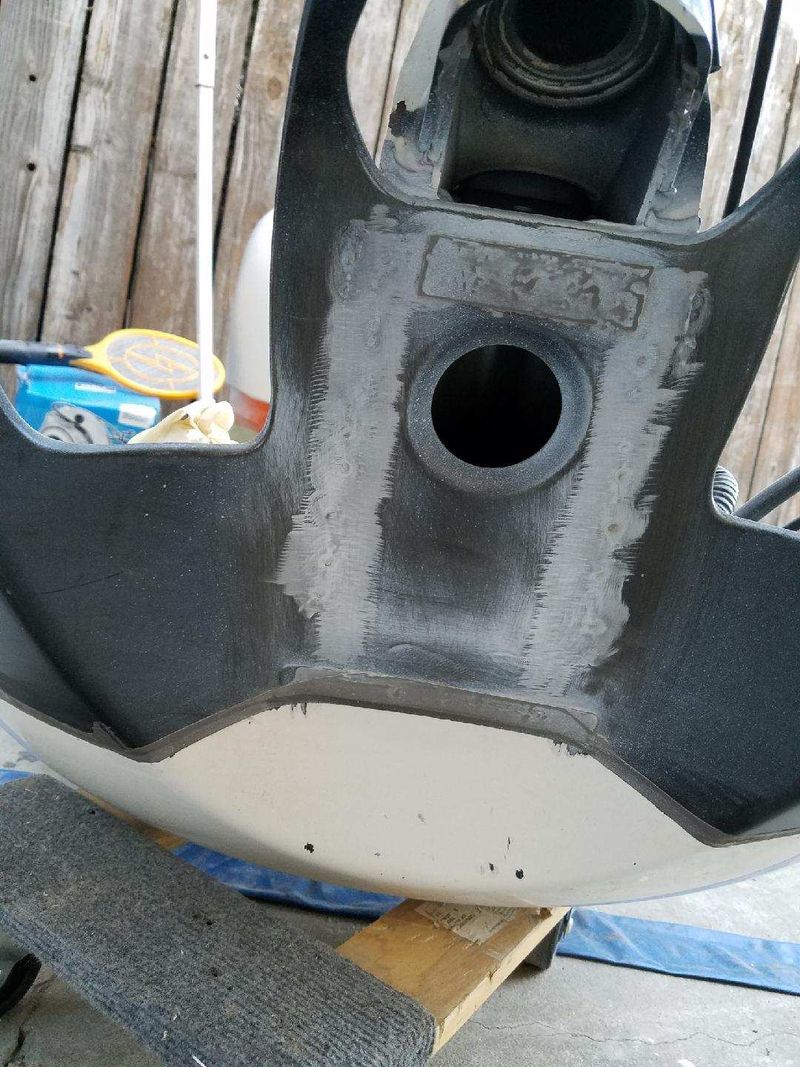

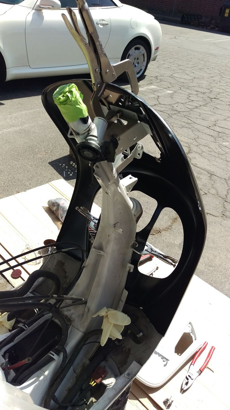

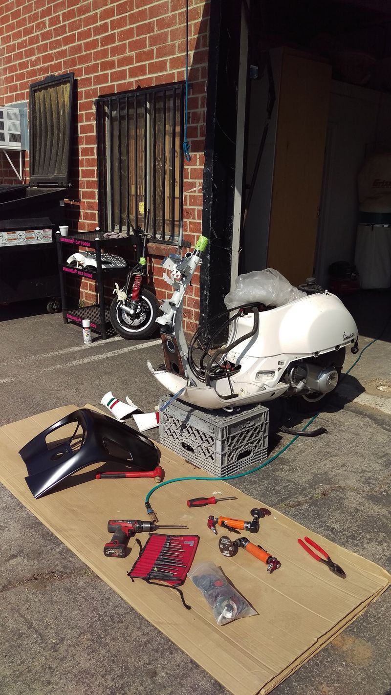

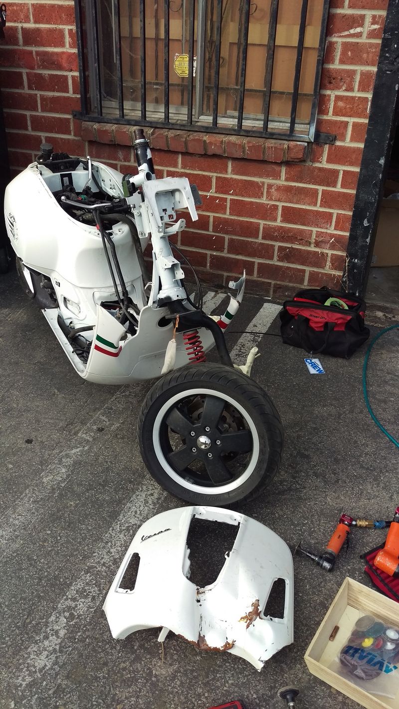

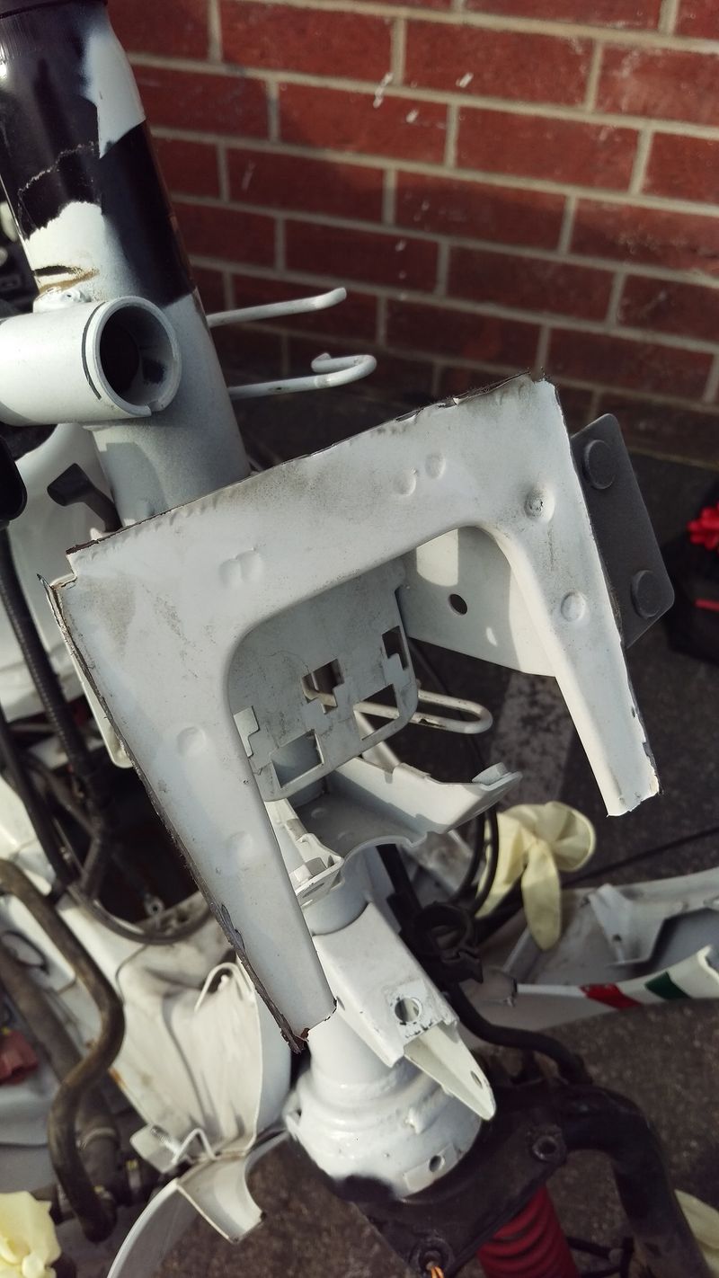

Here is some pictures. In the beginning i was like there is no way i can pull this off, but once I got going, there is no stopping me now. It is actually pretty fun process. Laughing emoticon

nice work so far. how will you approach the finishing - i.e. will you paint the whole scooter or what is your plan?

Thank you, I ordered the new legshield. I am going to wait until it arrives before I continue.
I would really like to paint the whole frame, but not sure on color yet.

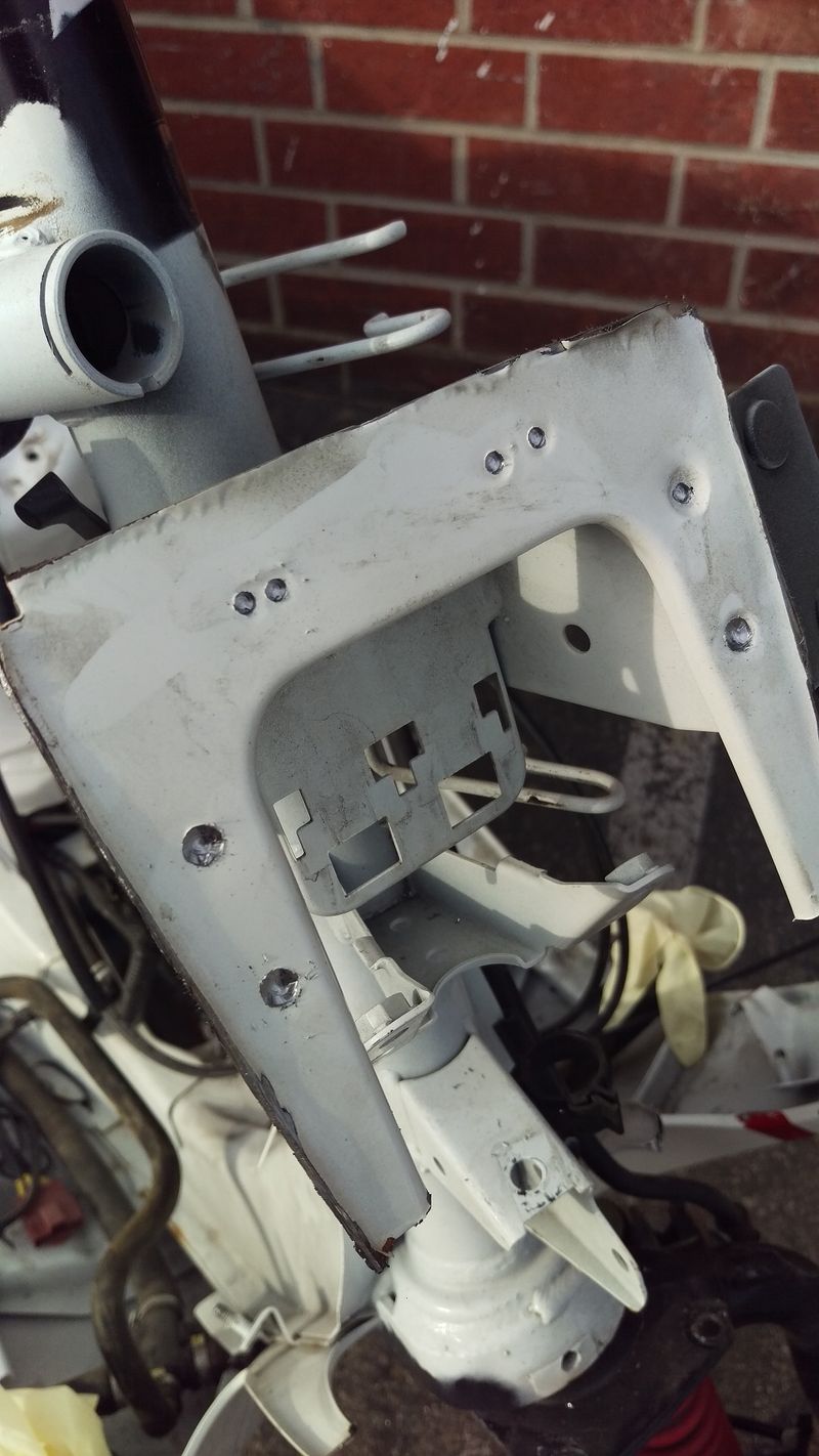

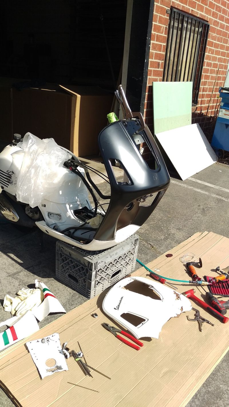

So finally got the leg-shield

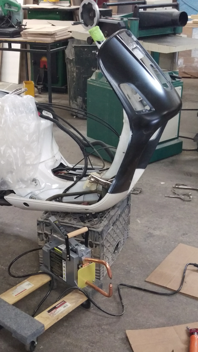

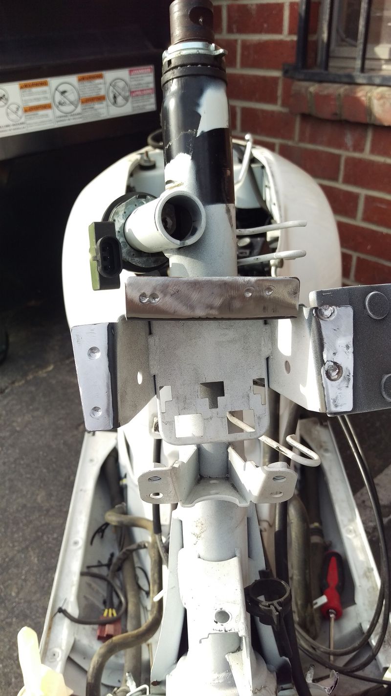

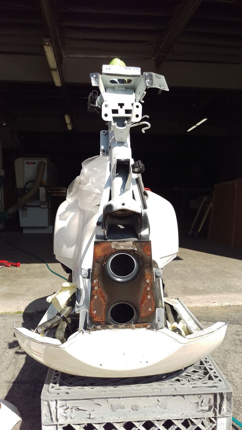

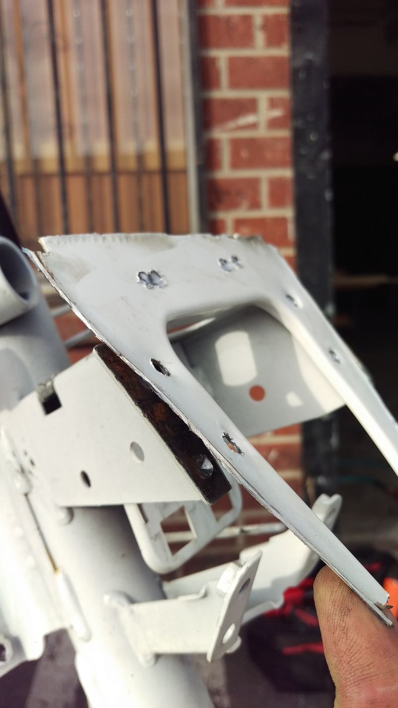

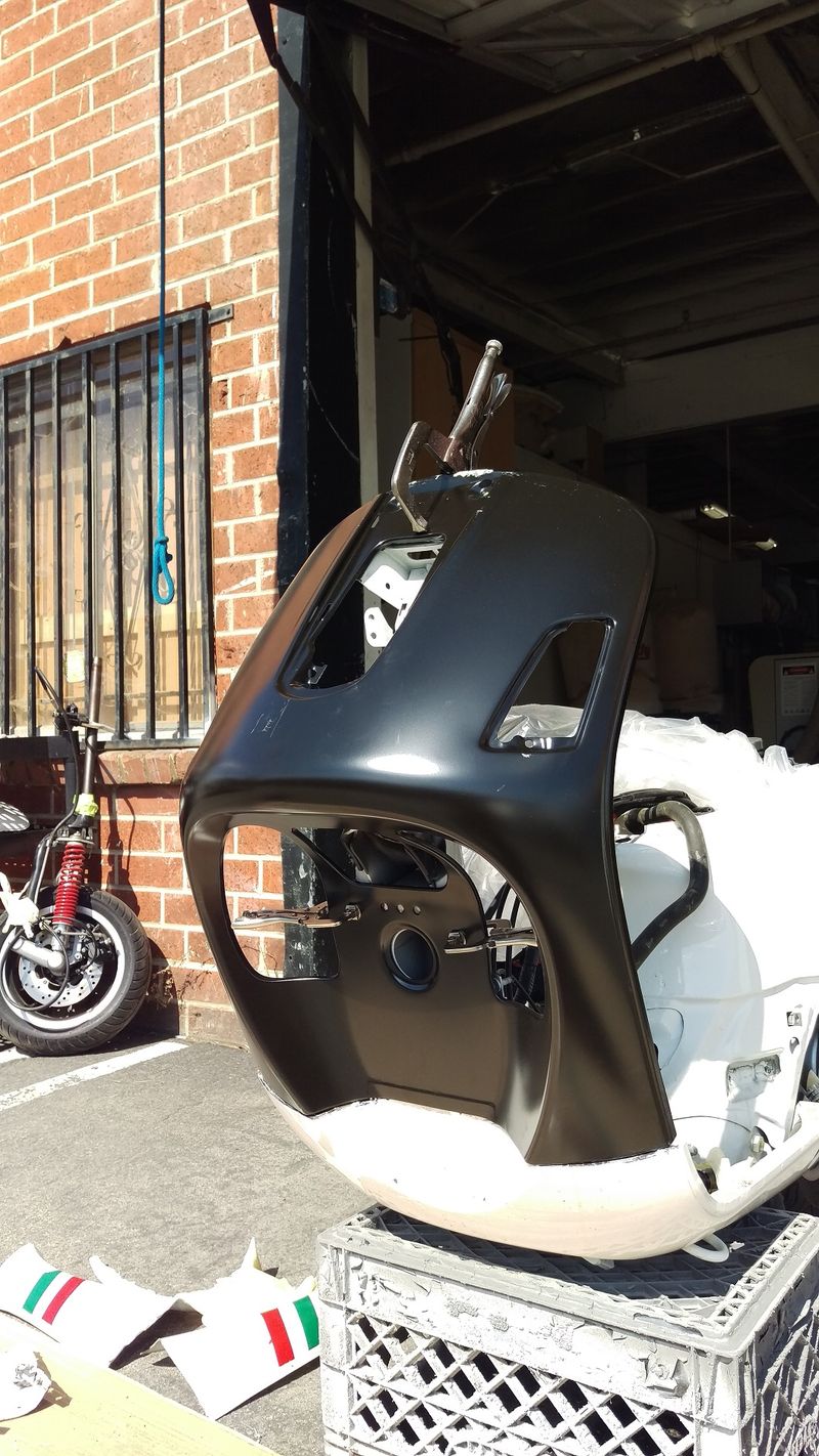

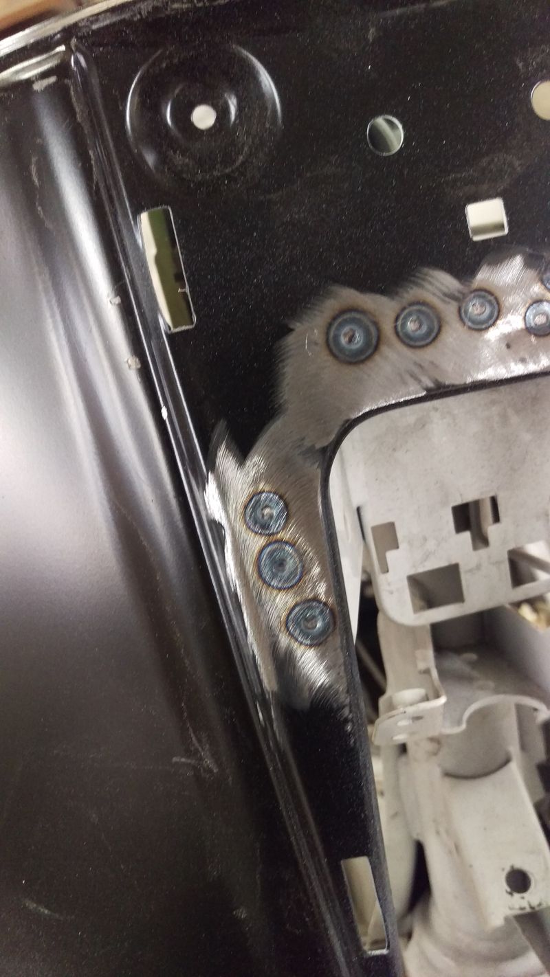

Started welding
Waiting on longer tongs for the spot welder to reach deeper areas.

just an odd question though, if you go to sell this in the future would you be forthcoming in the facts that you carried out this repair?

Thank you. It currently has salvaged title/certificate, and the resale value drops dramatically due to the fact. So in other words, the amount of time/money spent on it it really is not worth selling it. At best case scenario I break even on it which i have no intention of selling it.
But to answer your question, yes I do provide pictures before the repairs were done and that information is not secret, accident reports, car fax reports, auction reports all available to the public with search of a VIN.

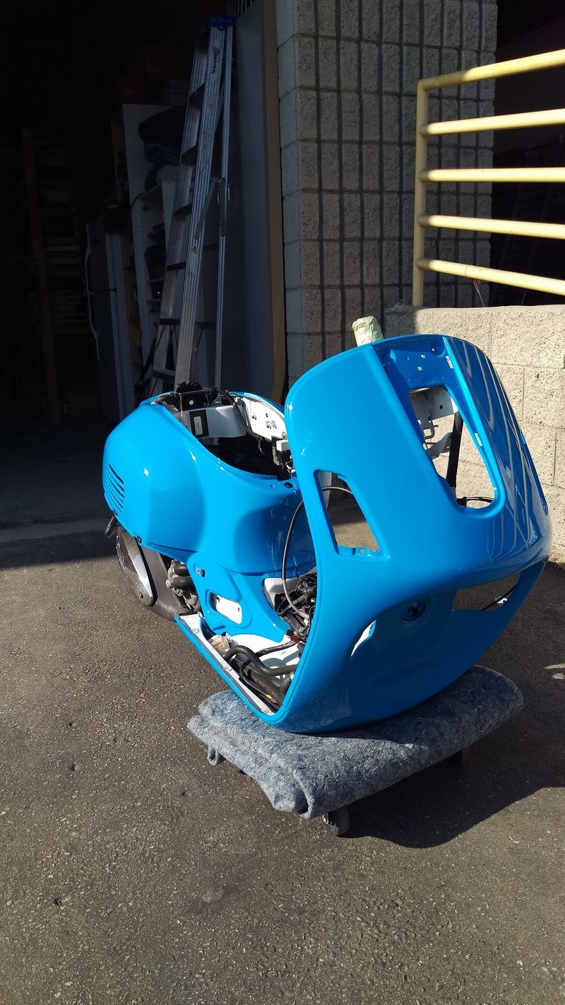

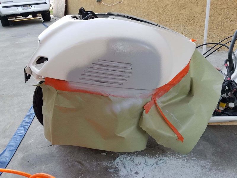

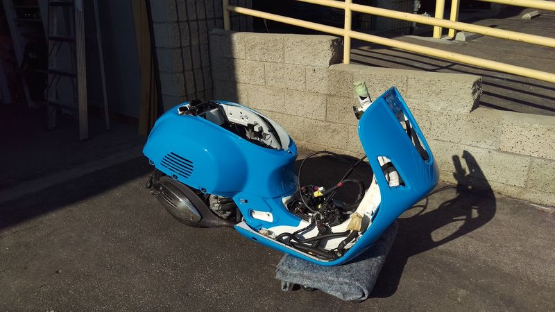

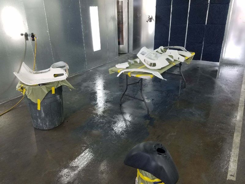

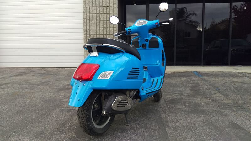

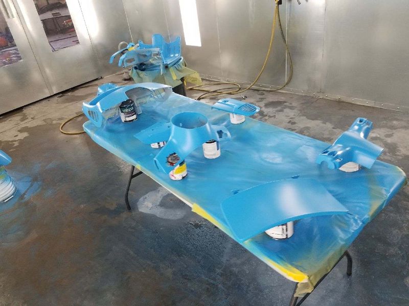

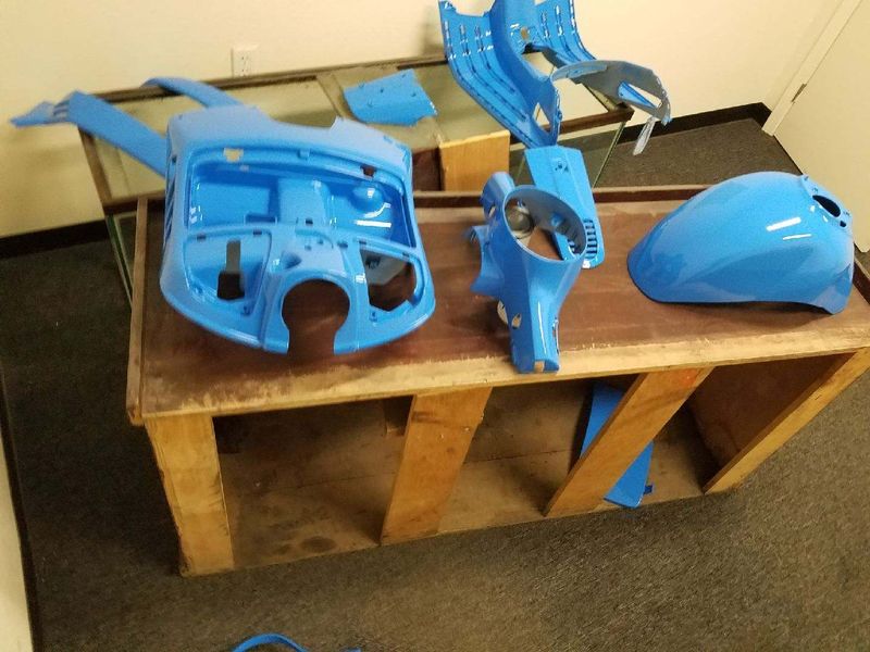

I was hoping to get her done sooner but work kept me extremely busy (even during corona season) and with family it's hard to find time to work on the vespa.

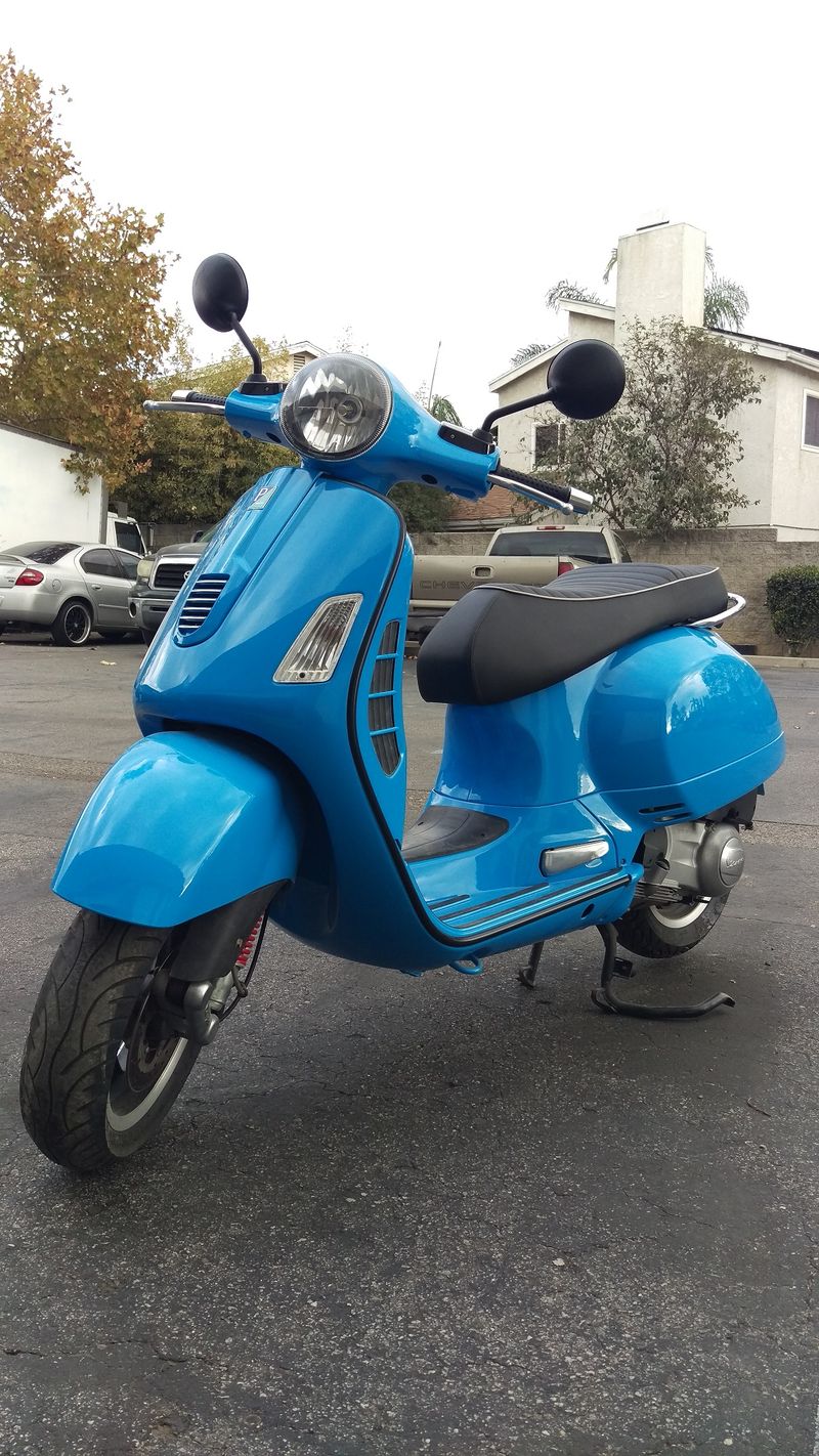

Finally got it painted. I had a co-worker of mine do the painting. Last time i held a paint gun is decades ago.

I got the color idea from 2020 Chevy Corvette Blue. Pictures do no justice. You have to see it in person.

It's probably going to end up looking better than it did new.
Nice work!
Posts: 988
Location: tampa
Posts: 988
Location: tampa
one of my favorite color shades.looks like 2000 porsche riviera blue and yes blues loose shades in pictures. I think its red eye reduction in cameras.
paint job looks pretty fabulous .. liken it.

Excellent work all around and I absolutely love the color. Reminds me of the Saab Viggen blue.

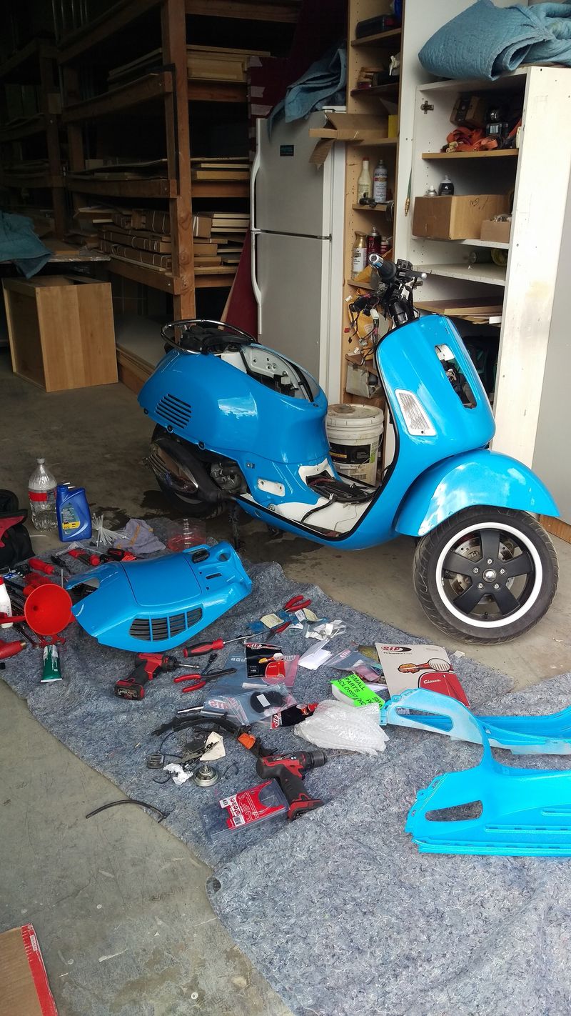

Putting this thing back together is no easy task. 1 step forward 3 steps back Laughing emoticon
I lost some of the coolant when taking the radiators off. I flashed the remaining coolant and filled it with fresh coolant. Both front and rear brakes were totally gone, so i sat there and actuated them by hand as fast as i could for few minutes. I was able to regain the front brake. Rear brake does not want to come back to life and it seems like now i have to change the fluid to make it work again. I don't know why but when you don't use your brakes you lose them.
@maxx28 avatar
GTS 300 Super
Posts: 672
Location: Los Angeles, CA
@maxx28 avatar
GTS 300 Super
Posts: 672

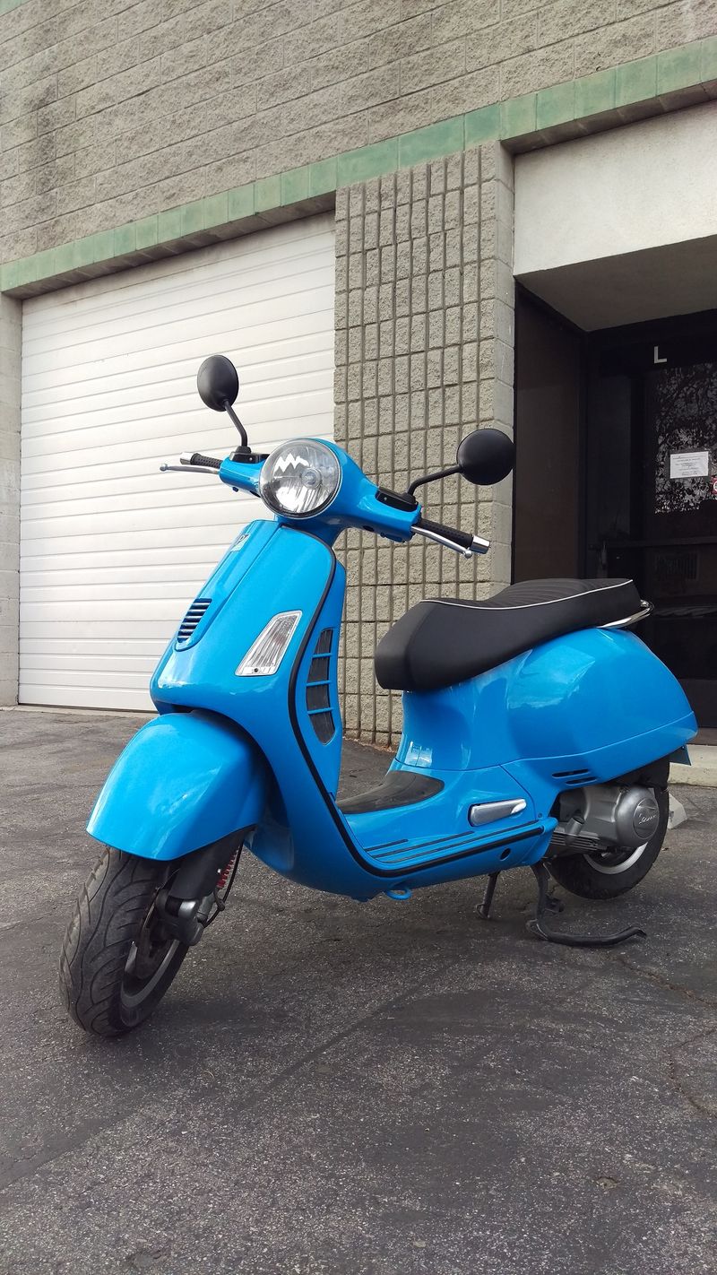

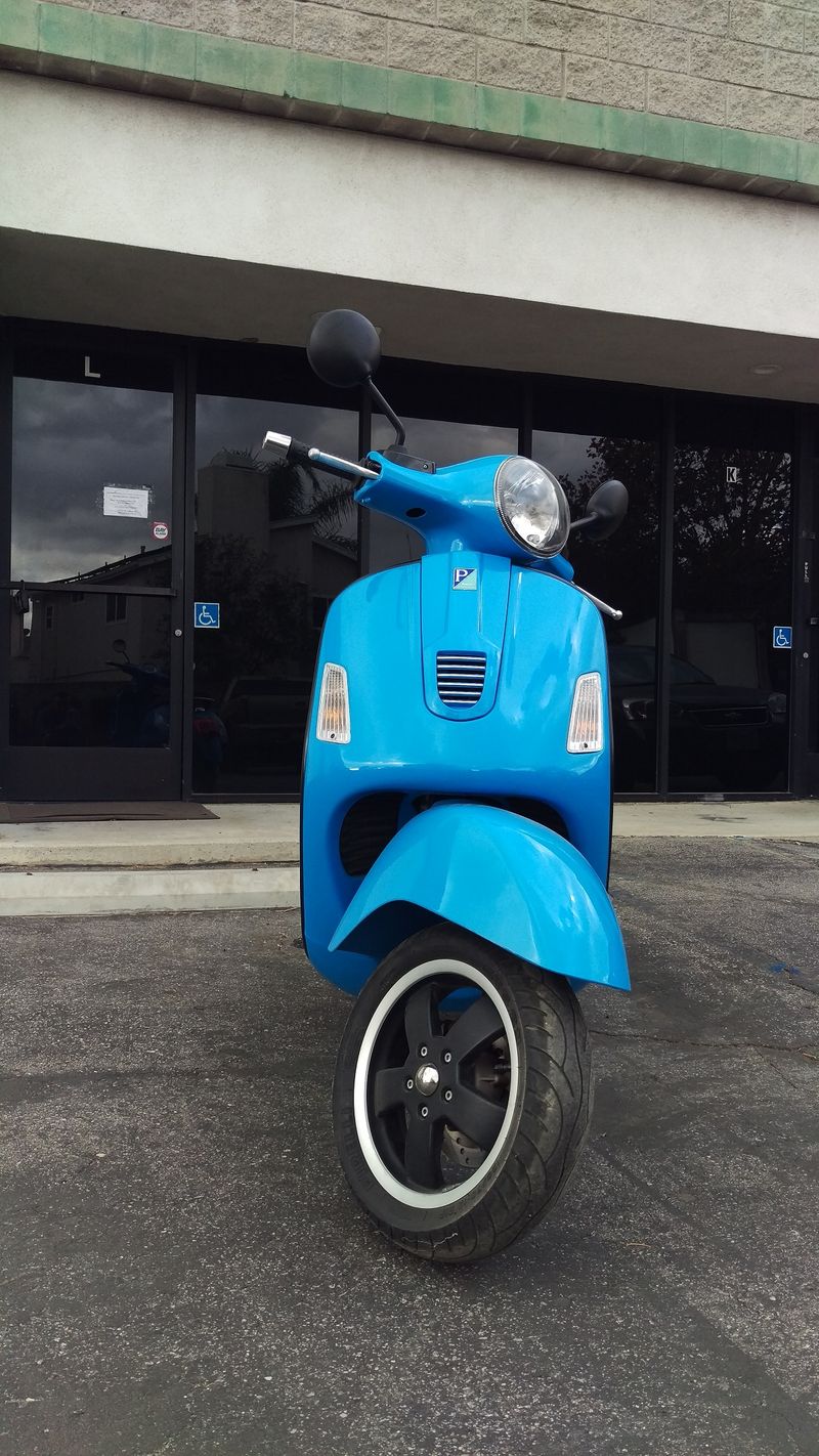

It took exactly a year to finish. Just gotta change few small hardware here and there. I have all the stickers and emblems, but i kinda like the clean look of it.

Is that "Richard Petty" blue?
