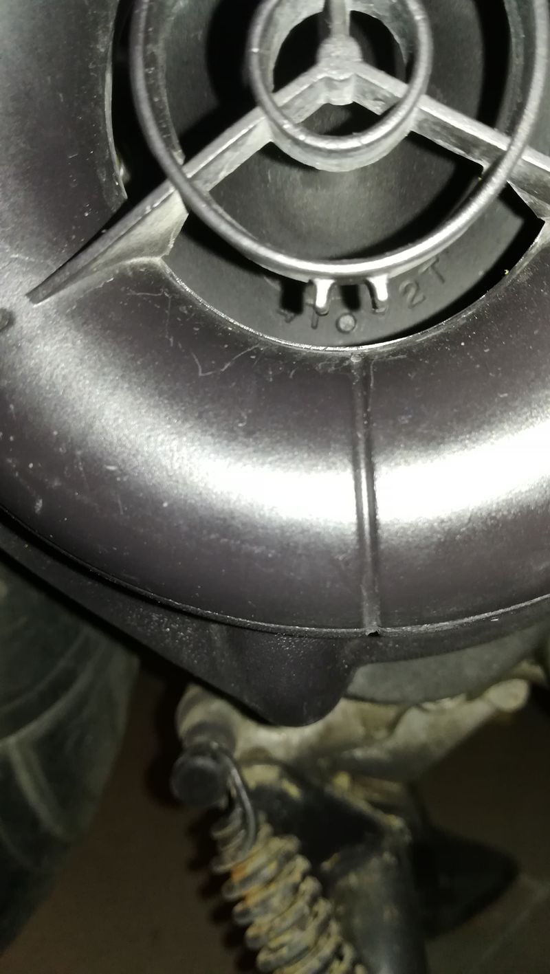

before a few days I instal Big Bore Cylinder Kit (80ccm) by Malossi and alsow I instal Power Cam from same producer to my Vespa S50 4V 4T. I did it slowly ... no hurrying, each part of this "puzzle" was check before instal. Everything goes slightly, piston rings "clic" nice, tightening of all component on correct Nm, applycation of new bearing to camshaft was smooth ... and in my mind I telling "that will be nice tune up". After asembly I tryed to start engine. Rear wheel slowly spining and I could hear only starter but nothing more.
Starter works well, after a few attempts I smel gasoline so fuel supply should be OK too, carb is ok and all hoses are connected, spark plug is OK but dry. (should had be wet from gasoline after a few attempts to start???) What about ignition ... could it be that problem ?
Thanks for all opinions and replies.

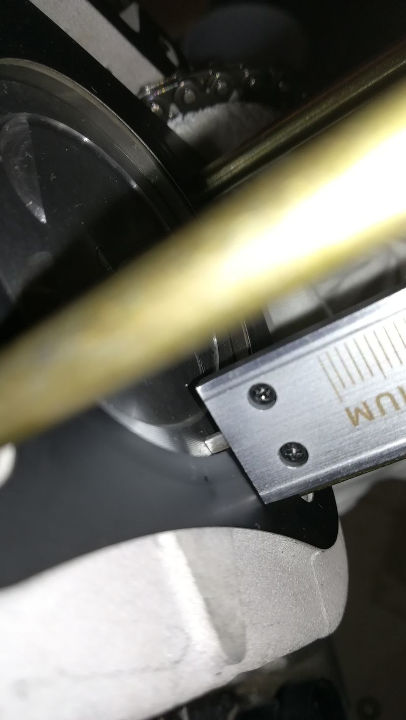

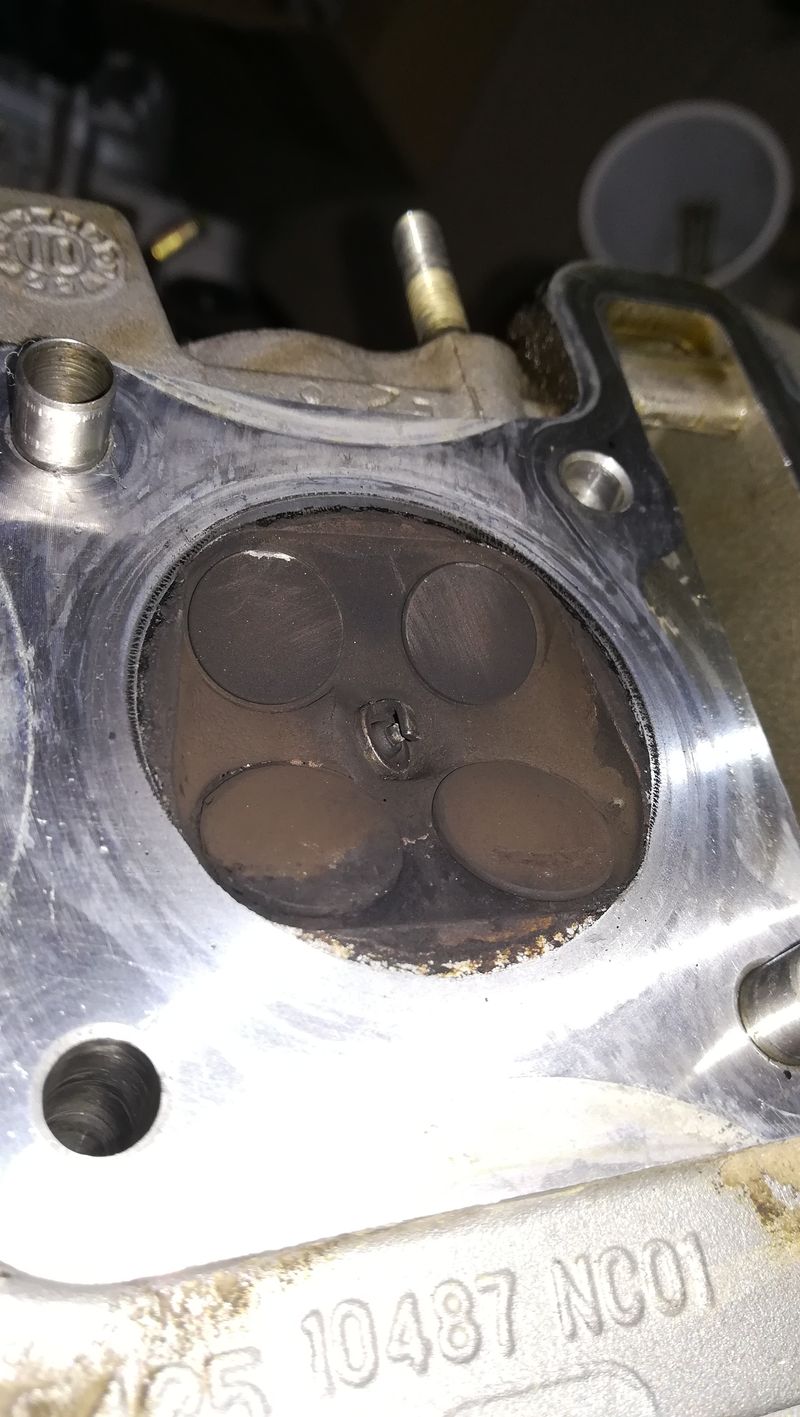

unfortunately ... it happened
will it be re-usable ?

Sure. It looks like you dodged a bullet. Have a really good look. That one valve only just touched and wiped a bit of carbon off. It also look like it did might not even have made a mark in the piston?
You need a thicker base gasket or a thicker head gasket. What do the instruction say?

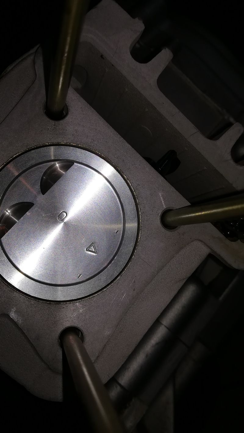

In the piston are two small imprints "like from children teeth" ... nothing deep. As you wrote on one of exhaust valves is probably wiped a bit of carbon off. Isn't necessarily to clean head and valves?

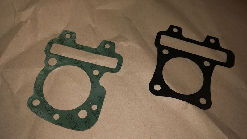

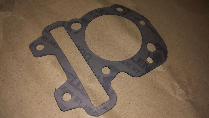

There were packed three gaskets. I used two of them (green waxed paper and black I think this is metal sheet ). Green gasket has thickness 0.8 mm and I used as base gasket and black one has thickness 0.5 mm and that I use as gasket of head. In box was one more gasket (gray) it is widest it has 1.00 mm. But I'm not sure from which material is made.
May I have to use the gray gasket as replace for base (green) gasket ?
Instruction manual didn't talks about which gasket should be placed on base or between cylinder and head ... in fact there isn't mentioned anything about gasket at all. There is used word "assembling".
So what I should do now?

Difficult doing this at arms length. Is the kit one that can be used for both two valve and 4 valve engines? Maybe the 4 valve engine requires the use of all the gaskets so tow at the bottom.
Edit OK found this
WARNING !!! Into the kit you will fi nd two cylinder base gaskets with different thickness:
- 0,40 mm: to be used in 2 or 4-valve engines
- 0,80 mm: to be used in 3-valve engines
The piston with 3 valve housings is fully compatible with 2, 3 and 4-valve engines.
If your kit is Art. 3117771
http://storage.malossistore.com/files/montaggio/pdm/7317771.pdf
Arrow on piston is facing the exhaust/bottom of the engine. (sorry if this is an insult)
I can't find the instructions on line. (See edit above)
If you have the piston the correct way around and you still get interference then use both gaskets together at the bottom.

Piston is instaled correctly. You can see arrow on the bottom at the first attachet picture.
OK I try to use at first only the thicker gasket and if it will looks still to low I add a second gasket and check how it looks.
