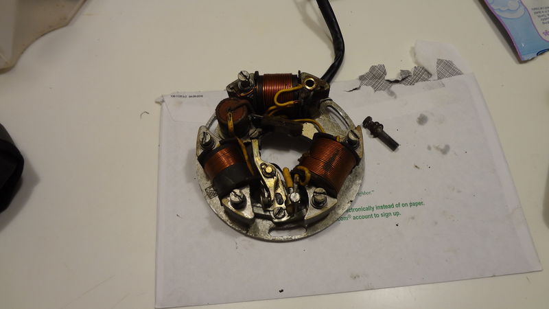

My stator is in bad shape and has a few bad solder points so I need to take it out. The three bolts that mount it to the crankcase are stuck, I've already kind of stripped two of the heads. I can't use heat since they're so close to the wires. What do I do!?

The impact screwdriver did the trick! I picked up a Craftsman driver with a few bits from Lowe's for $15, got the bolt out with 2 whacks. For anyone reading this thread who has the same issue, GET AN IMPACT DRIVER. What an amazing tool.
