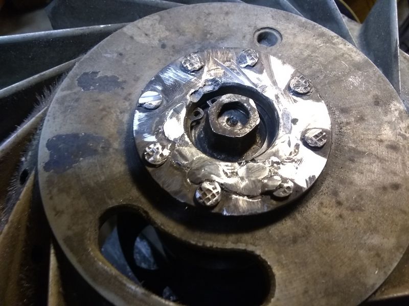

Eric had a nice extractor which I was loathe to ruin, so we just used a big nut & piece of threaded rod which we ground a cone on the business end of to center on the crank. I think I can cut the nut off to save the flywheel which appears to be in good condition. Still need to check the magnets.

Nice job gentlmen! I'd say if you keep the grinding centralized, itll probably stay close to balanced. I tried to minimize the extra grinding and so far (two years) theres no flywheel/ electrical issues.

Successful recovery after testing the magnets with BIG wrenches easily gripping this thing tightly from below. Should be good for another 100, 000 miles anyway. The inside looks like new. And the big nut and screw can be used again too. Thanks for the idea, Jonathon.
weapons at the ready
we have separation
we have separation
test mounted on an old crank
not much damage other than surface and the retaining ring fits properly
