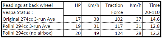

WAIT FOR IT...
Here's the numbers:
(PS the dyno still runs on Windows '98 OS !)
@fudmucker avatar
Posts: 2137
@fudmucker avatar
Posts: 2137
So, in round figures, I increased the engine capacity by 7.3%, gained 2 HP (12%) and 15Kgf (15%) more torque, all at lower RPM / speeds.
Acceleration 20km/h to 110km/h is down from 14.6s to 12.8s
For interest sake, we ran a single test with the airbox disconnected.
That single change resulted in another 1HP (=18% up) and 7Kgf (=22% up) more torque from stock.
The OEM airbox is clearly limiting airflow in the higher RPM range.
I'm now looking for another airbox from an insurance write-off to do some experimenting...
NB: OEM exhaust is fitted in all the above results

I'm a little curious why they measure time from 20-110, rather than 0-110?
@fudmucker avatar
Posts: 2137
@fudmucker avatar
Posts: 2137
berto wrote:
Fudmucker wrote:
Here's the numbers:
It is a CVT transmission, which has a slip factor to begin with.
With a Clutch, you can apply power + torque immediately.
Once the inertia is overcome, the motor shows a comparable curve.

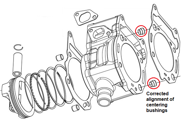

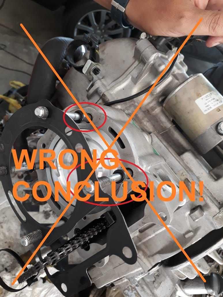

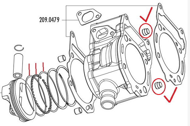

Fudmucker wrote:
MV, you have hit the nail on the head...
EDIT: OMIT totally incorrect, unwarranted, unjustified, unreasonable observation totally indicative of haste and enthusiasm overcoming reason and intellect
The kit is fitted, the motor is back in Sunny and we watered up, oiled up and gassed up yesterday evening. This morning I get to ride it in it's new configuration. I will run in for 500kms before I put it on the dyno again.
Just for interests sake, when we examined the existing factory cylinder at the engineering works, the technician pointed out that the original cross honing marks in the cylinder were still visible - after 42 000kms on the motor!
PS: Getting those three rings into one slot in the Polini piston is a serious pain in the posterior! It took longer to get them in that to reassemble the motor.
Oh dear God, I wish I'd looked at this earlier 😅😅😅
I've been trying to stuff O ring in there for two hours
Posts: 9647
Posts: 9647
The same information is in the instructions.
