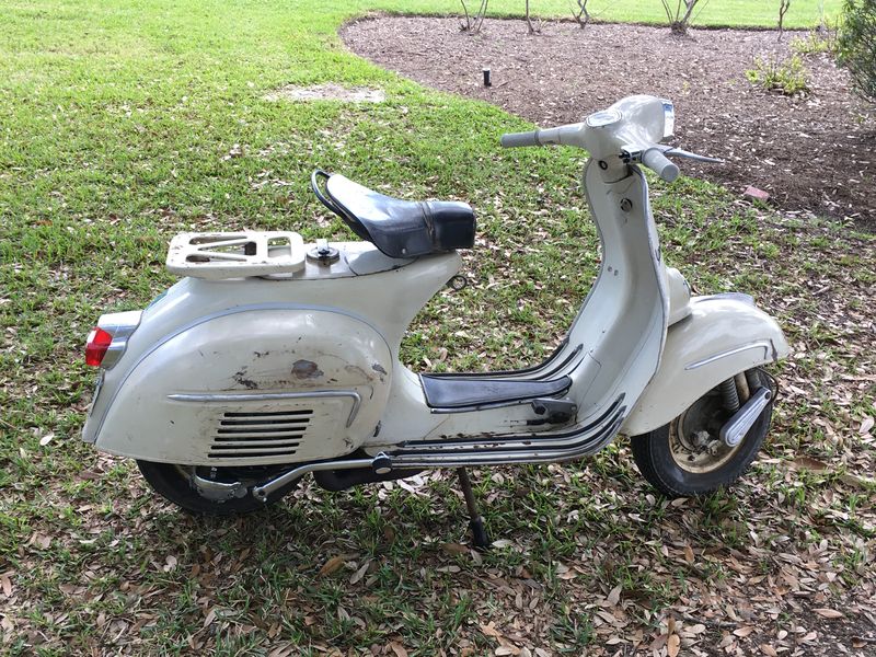

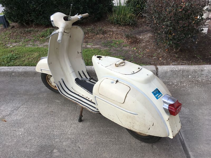

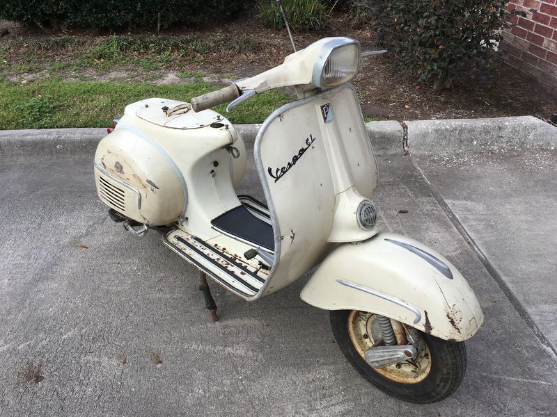

Lot of winter projects/finds popping up.
Figure I'd post one that I found last week.
Person I bought it from pulled it from his basement where it sat for ~35 years. Last road-worthy in '72. PO said he and his father found it at a sidewalk sale in non-running condition when he was 15. They pushed each other around on it a few times but never had it running. It went into the basement and sat as a future project. Life happened and they never got around to it. Motor is not locked, all levers and grips move freely.
rear rim on backwards
Blue rivets!!  Thanks rowdyc for the GL info.

Man another beautiful find! So good. Looking forward to seeing it done.
VNB VSC VMA VSX - o9c vmb vse
Posts: 9493
Posts: 9493
Wow
That's stellar! Keep us posted.
Posts: 10050
Posts: 10050
Well done!
Rare GL's and old Sprints, even a dead SS180 all over the place these days it seems.
I like those stylish but practical safety reflectors, hope you can find a proper mate!
External inline image provided by member with no explanatory text Laughing emoticon

Wow wow wow... What a find! GLs are so pretty. That one should clean up nicely! I'm terribly envious of these finds - I look just about every day here and there on various sites, and I've yet to see anything even remotely close to "barn find" status.

Wow, beautiful! Great find.

Lovely GL
Very nice find. I do hope that you keep it as original as possible. It is getting harder to locate little time capsules, like this GL. Such a good runner once you get it up and going. I had a similar one when I lived in San Francisco. I rode it all over the city. So fun. Enjoy.

Beautiful. Here's my '64 Motovespa 150S , in front, parked next to a GL at a local Carbs and Caffeine a few years ago.

Another great find, their really coming out of the woodwork lately.

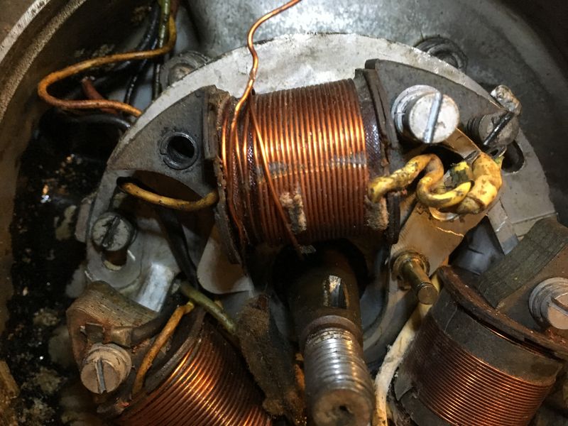

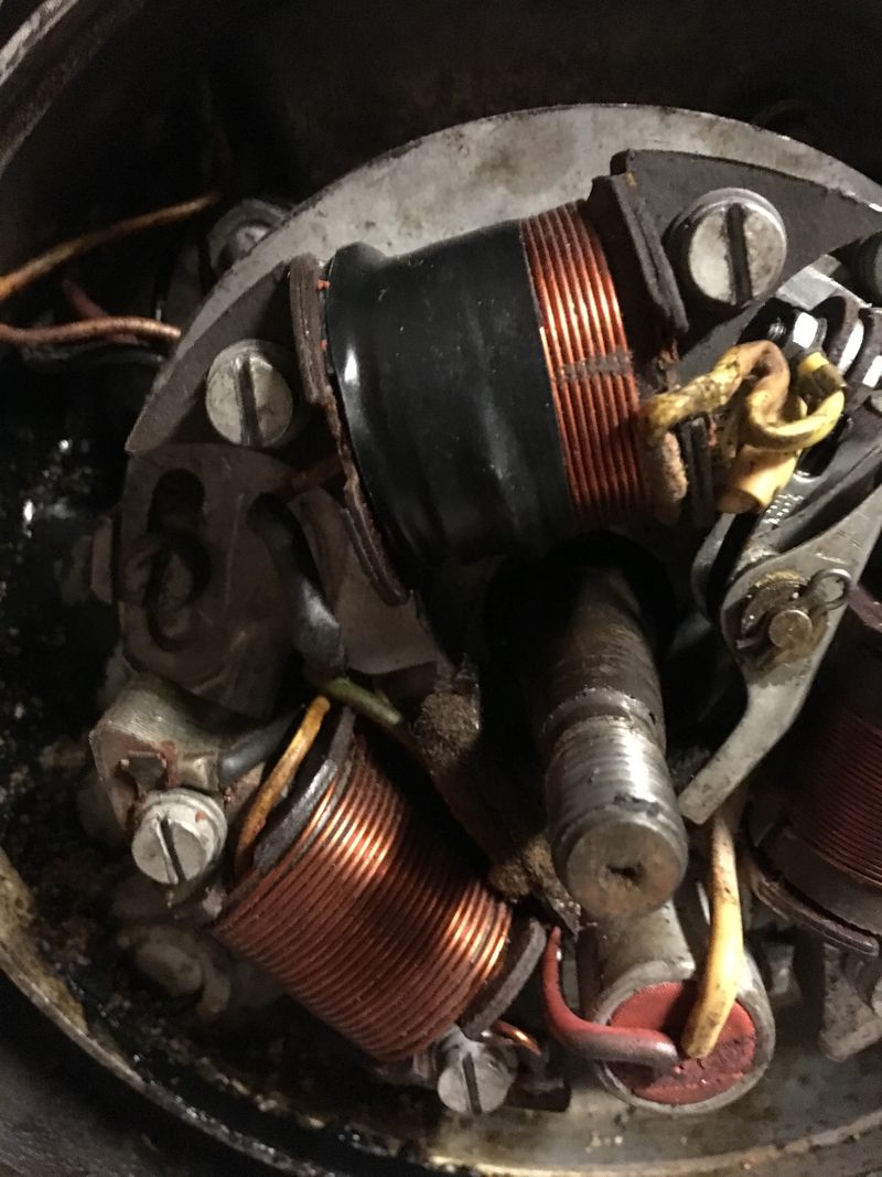

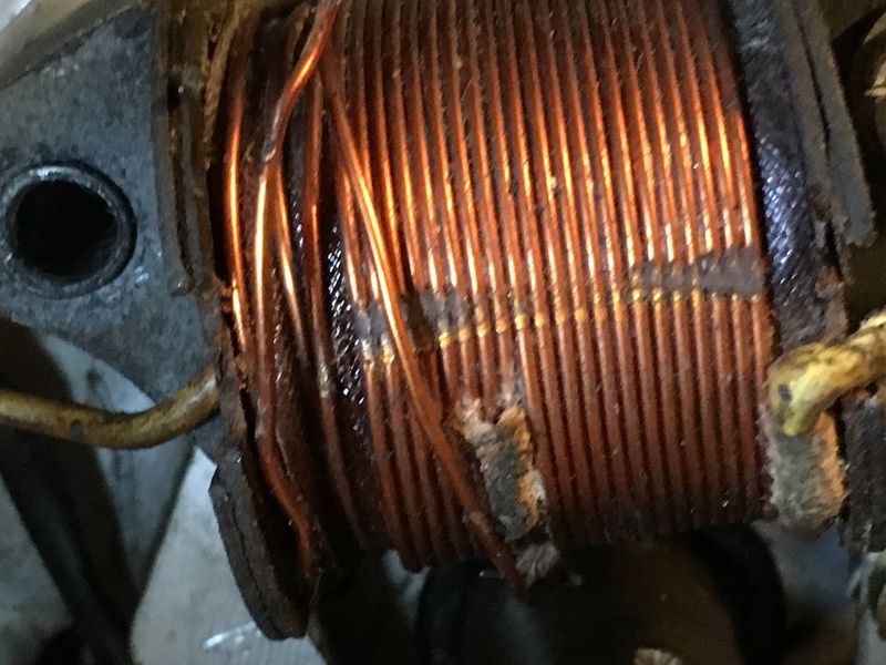

I think I know why it didn't run....
No spark so decided to investigate. Pulled the flywheel to find longer screws (possibly mixed up with the fan shroud screws) in the dust cover cut through the primary coil windings along with a sheared key.
New one on the way, but in the meantime, I figure I would join the loose ends and see what happens. Losing two turns on the primary coil can't make too much difference.... I hope.
Gapped the points, put it back together and we have spark!

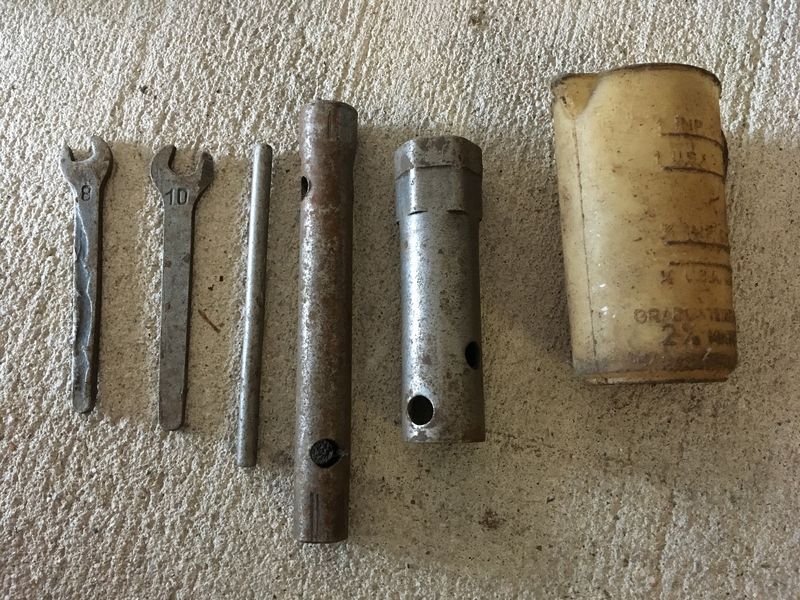

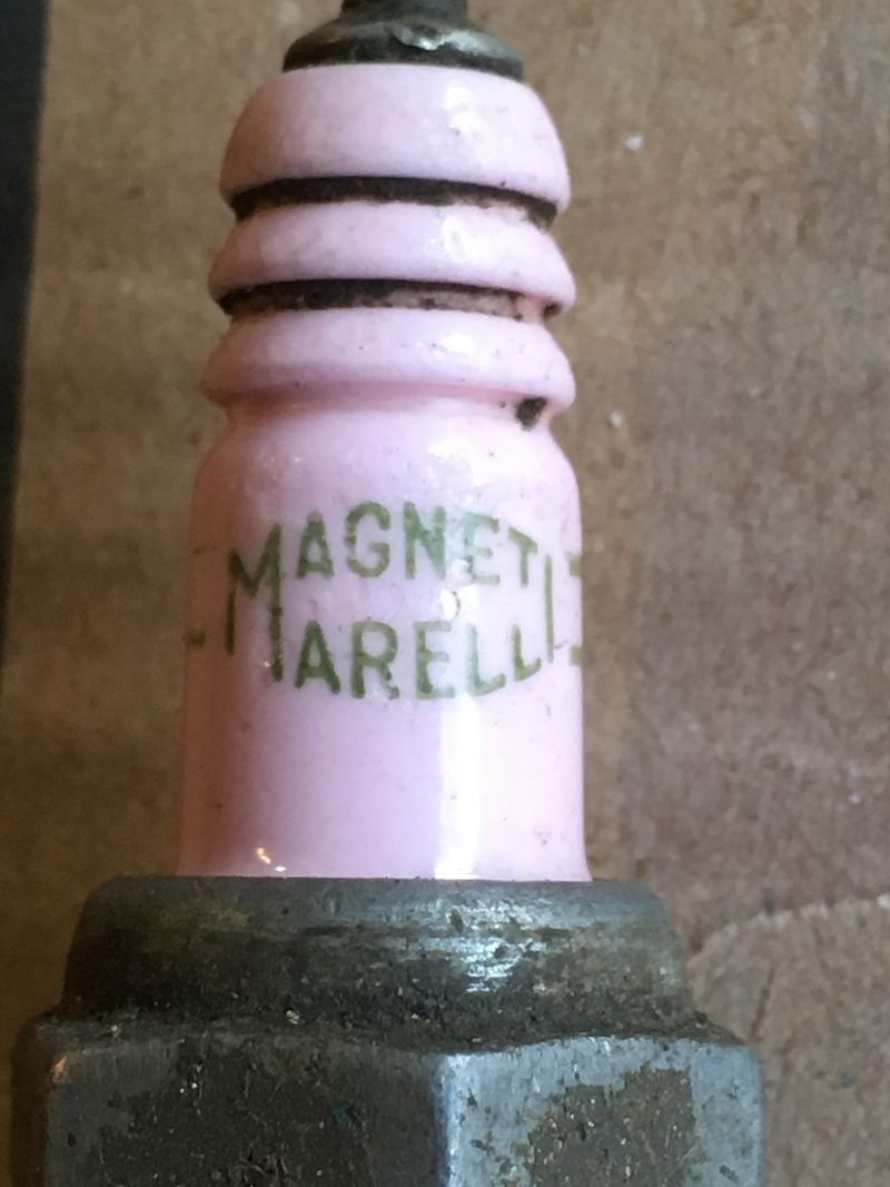

Found what looks to be original tools in the side box and an unknown-to-me brand of spark plug.
coil wires cut
coil wires cut
Temporary fix until new coil arrives
original tools perhaps?
pink ceramic with Magneti Marelli brand plug

That Marelli spark plug is original to the scoot for sure. Italian maker. Known for their Pink Plugs.

Those are the original Vespa tools that would have come in a roll for repair on your scooter, as described in the owner's manual included when your GL was purchased new. Nice find. If you want to keep that period correct look, rolls without tools can be found fairly easily. The tools are usually the missing component.

p.s. As you probably noticed, one of the flywheel fan screws is missing. You should replace it before you fire the engine up.
Yes, I did, thanks. I found two of the short screws in the fan shroud holes and put them all back into the flywheel so they don't cut anything else up inside!
Did not know that. Thanks for the insight. Figured it was Italian by the name. It will stay in the side box!
I will keep an eye out for the roll. Are we talking eBay or somewhere else?
The last time I saw the empty rolls (just the original tool holder with no tools) was on a Facebook group. I am sure if you ask for such a thing on one of the accessory pages you will get some responses. I am sort of looking myself, although I have not put any real energy into it just yet.

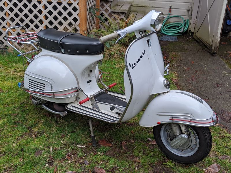

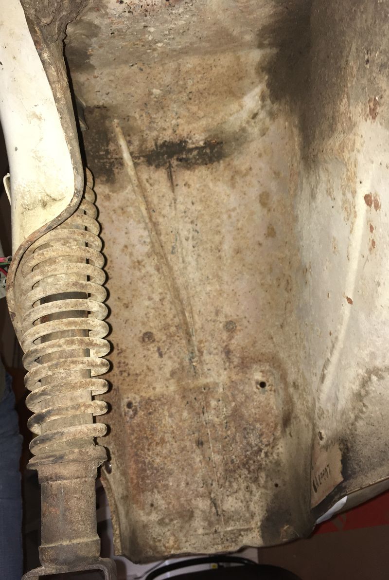

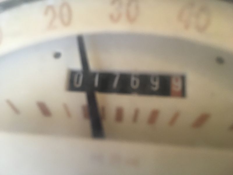

Slow progress....
While waiting for parts, I attended to some of the aesthetic duties. It cleaned up okay. Need to put some elbow grease in it to get a shine.
New rubber bits here and there. Found a touch up paint job and a little bondo on the right cover and front fender. Pretty good paint match, it doesn't bother me. Banged out most of the easy, larger dents and straightened the trim best I could. I am torn on the leg shield... if I fix it, I will have to replace the trim... still deciding.
Couldn't find a matching reflector, Voodoo, so I removed the lone one for now until I can find a partner.

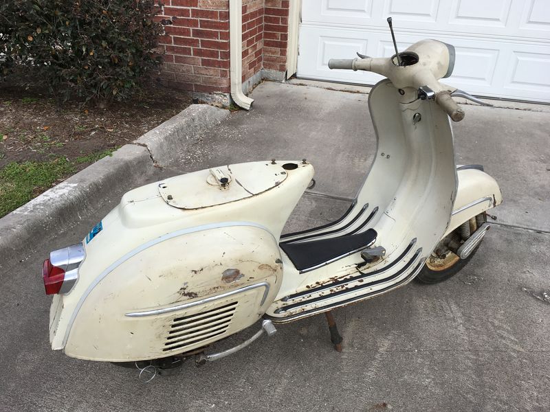

There was a bit of play in the headset. Found the steering bearings were shot! No cage left in the lower, steering stop bent, top bearing missing bearings. Replaced both bearings and was able to bend the stop back decently. Shifter cables and front brake cable changed along with servicing the front hub. I think they might be the original made-in-France Michelins on the scoot. Or were all the early ones Ceat? Speedo shows 1800 clicks but the speedo cable is broken so who knows...
Curvy
Curvy
22mph standing still

wow I'd be proud

That is amazing.
OG paint looks soooo good.

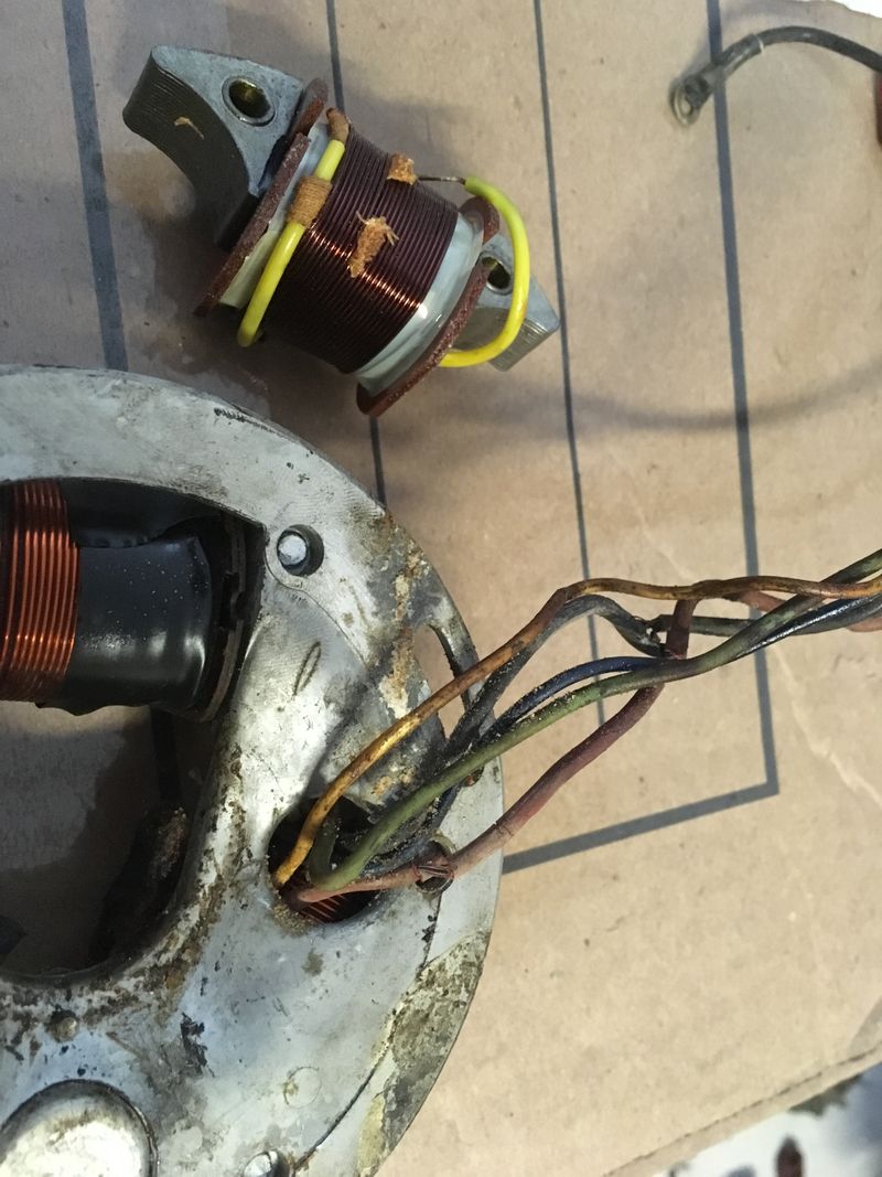

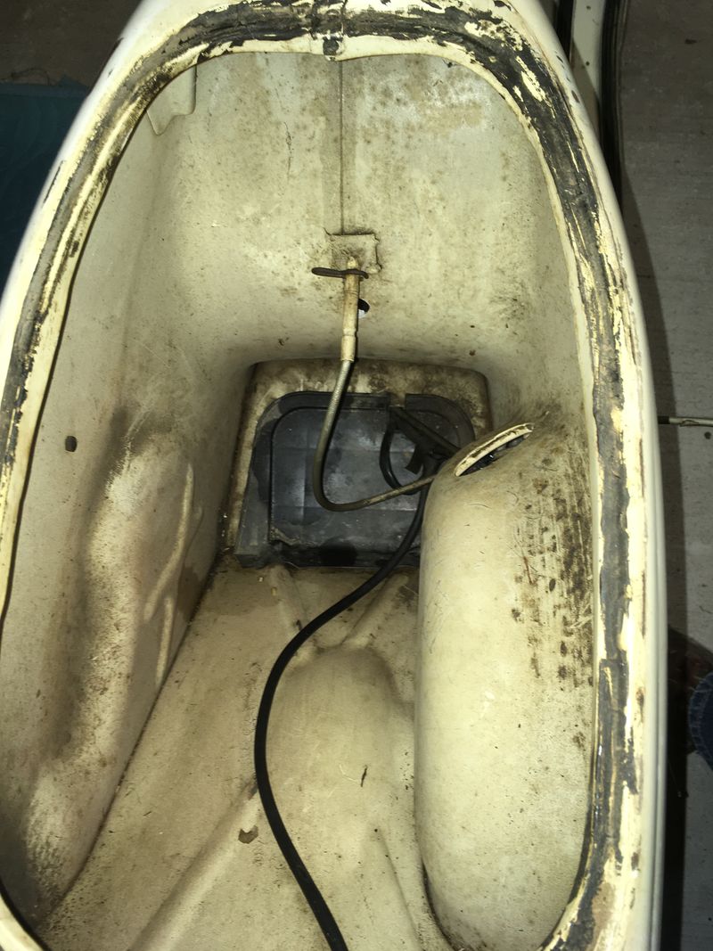

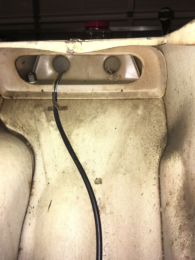

So about ready to tackle the bad coil and uncovered more issues. To be expected for wiring that is over 50 years old. Solder time!!
crumbly wiring
crumbly wiring

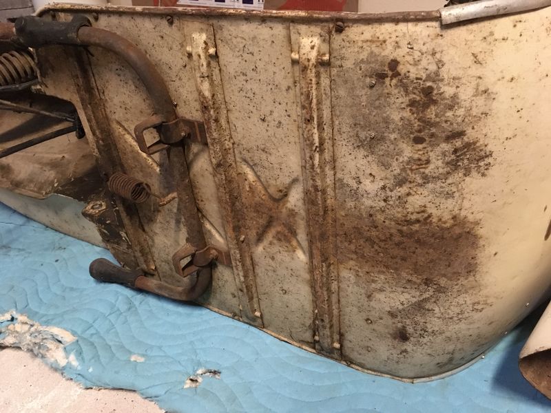

Hiatus

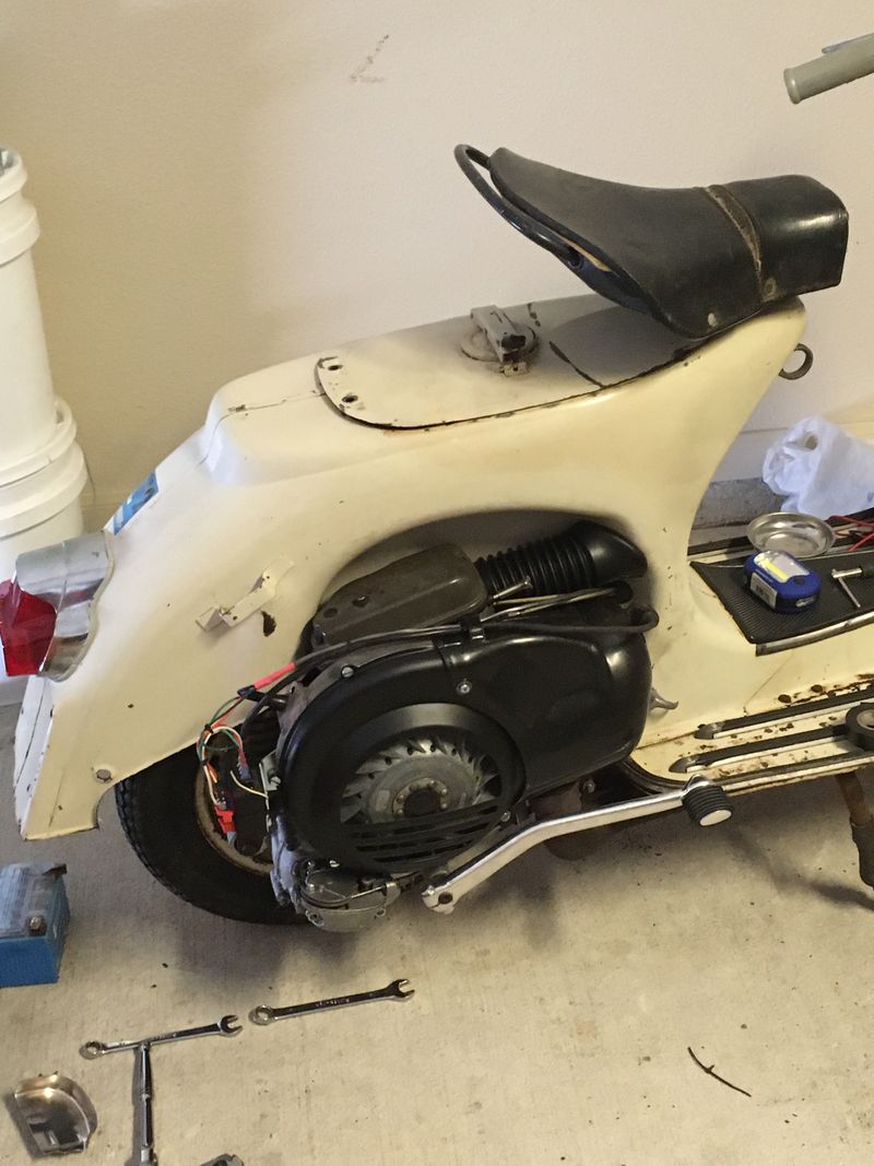

Gab25 and Tierny, great tips and suggestions. I will definitely go that route. Great looking GS Gab25!

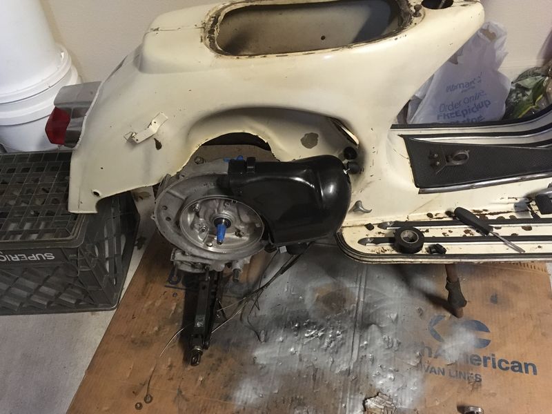

Been awhile since I got to mess with the GL.
Soldered new wires to the stator and put on the new coil and I got a bright-blue spark. Finally got it to start but it wouldn't idle. Had to keep blipping the throttle to keep it running. Found little to no oil in the gearbox. I am guessing a leaky crank seal. Time to pull the engine.
video link here

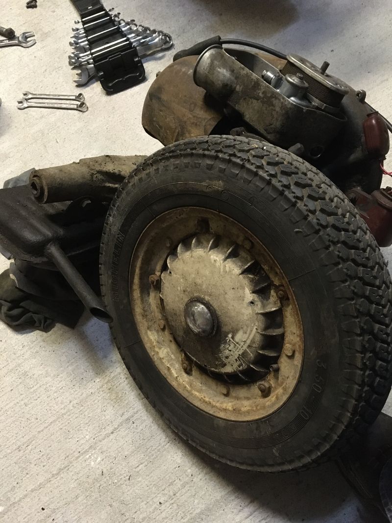

lump pulled
lump pulled

Wow that's cleaning up great! What are you going to do with the lump?

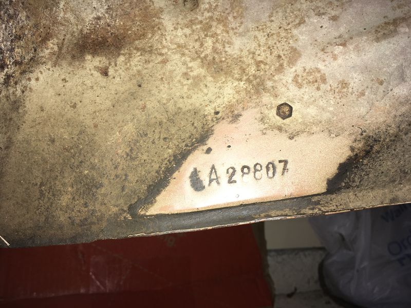

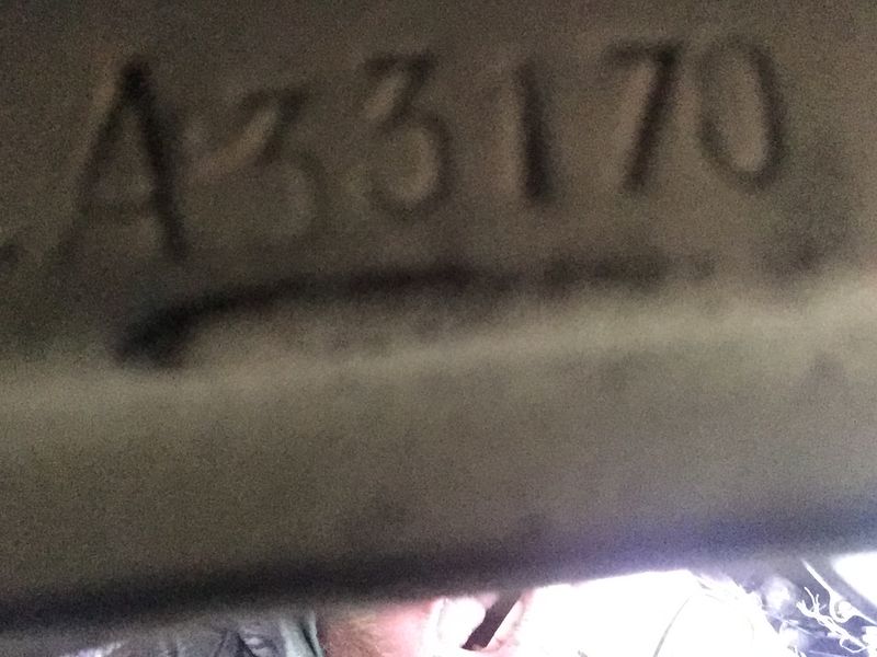

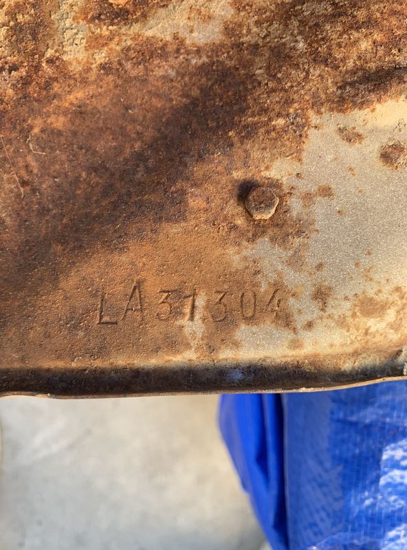

I'm curious... does your GL have a number stamped on the inside of the frame in the rear wheel well, left side? Found this stamped on mine. It's not the frame number. Wondering what it is.

Plans for the lump are full rebuild. No mods, as of now... it's a 2-port and I know the options and potential are limited without some work. Just clean and make it run well, replace the consumables. In the meantime, I do have a proxy engine that I am planning to put in to get it ride-able so I can work out any other issues that present themselves.
SoCalGuy, I do have a number there and it is different than yours... batch number perhaps? Encrypted date code? Expiration date? No idea.
Posts: 9493
Posts: 9493
Those are 2020 lottery numbers boys. Get your tickets now!
@hibbert avatar
Vespa
Posts: 1877
Location: California
@hibbert avatar
Vespa
Posts: 1877
My 63 GL has one too

whodatschrome wrote:
I have no shame when it comes to the pre P series scooters. I would just swap in a stock P200 engine right off the bat. My (very short) build thread would go something like this..."So i scored a GL yesterday!!! As soon as i got it home i swapping in a 200 engine, and fired it up just before dark! I'm planning on leaving for a 400 mile highway ride tomorrow morning, so i didn't have time to take any pics. Cheers!"
Sort of took whodatschrome's suggestion.
While the original motor is being rebuilt... wanted to ride it around and enjoy it a bit and see what else needed attention.
Only spare I had was what you see in the pics. I am worried I will be sorely disappointed when I put the original motor back in and try it after it is rebuilt.
With this lump, it is a blast to ride!
I am surprised by the weight of the proxy lump and how much the scoot wants to lean and turn right. Much more right-biased CG than any of my other rides.
Tried to keep as much original as possible. Brakes rebuilt, wiring and bulbs sorted to 12V with 'correct' brake switch. New steering bearings. Cleaned out the tank. All rubber replaced. New speedo inner cable and rebuild of speedo so it is correct within ~3mph. Worm gear for odometer drive (running off the speedo) was out of its tracks. All lights (sans speedo light, can't find the small festoon locally) work along with the horn. Having a ton of fun just riding it the way it is. Local locksmith was able to make a key for the side glove box. That was amazing. It didn't have the steering lock in it so I had to replace that. I will start tearing the 150 motor apart eventually.
I should change the kick start lever
and fan cover if I am leaving this motor in for a while...
I should change the kick start lever and fan cover if I am leaving this motor in for a while...
