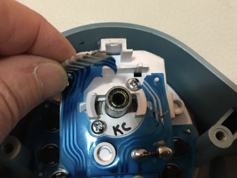

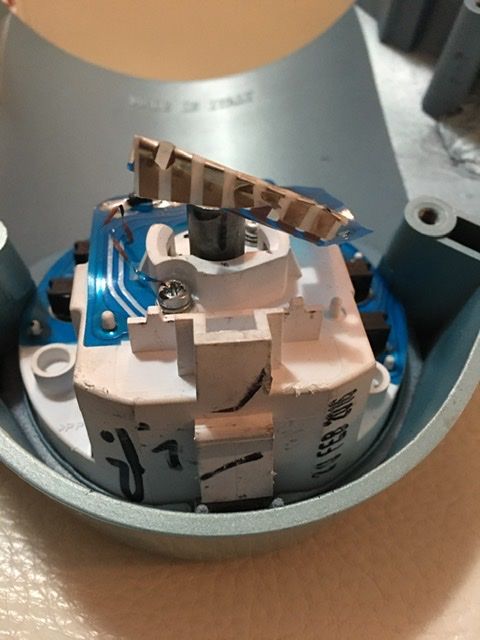

I was removing my headset cover to replace my speedo cable and in doing so broke the circuit board on the speedometer Crying or Very sad emoticon Crying or Very sad emoticon Crying or Very sad emoticon
Short of buying a new speedometer ( I'm thinking SIP digital ) can I get a circuit board separately from the speedo ? Or can I repair it myself??
Thanks in advance

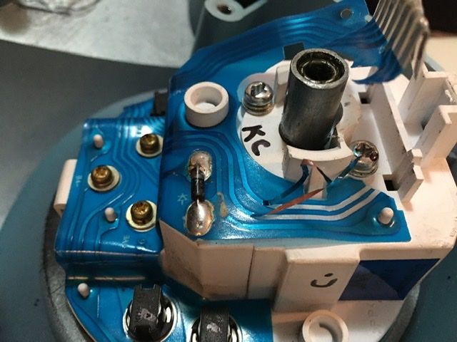

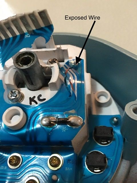

I'm about 99% sure that you can't buy that printed circuit board anywhere. You might be able to find a used damaged speedo to get one from, or like me, i just soldered in a couple jumper wires on my speedo. You do have to be super careful from now on to unclip that speedo connector though.

Repair it. Easy. Use the tails of any old resistors to bridge where the tracks maybe broken. The base is just plastic so use epoxy or...

That's what I would do.

It was never sold as a spare, so no you can’t find it anywhere. And I doubt that anyone would ruin a speedo to sell just the circuit board. If it’s not fooked way too much, it’s repairable. I’ve done more than 20 of them over the years…
