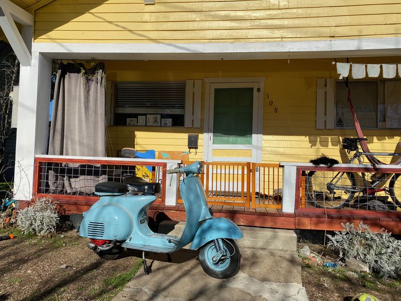

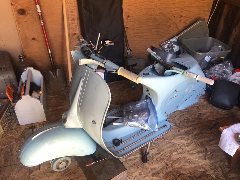

Hey all I just picked up a 62 Allstate cruise air. The previous owner took it apart to have it painted and 12 years later never got to it. It's in great shape and has all the parts.
It's even current on the registration! I am new to this. I asked a friend who has experience and he suggested to re assemble it put some marble mystery oil in the spark plug hole and see if I can fire it up. Thoughts? I have a couple books (how to repair and maintain your large frame Vespa and another I forget. ) do you all have any sources for reassembly procedure? What would you do?
Thanks
Carlos[img][/img]

Hi and welcome.
Is the engine in one piece? Has the engine been rebuilt or serviced? Do you plan to paint the body?
P.S. We like pictures.

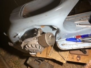

Thanks! The Vespa was in Santa Cruz. Engine is in one piece. I posted pics but they didn't post. Here goes again! I also have two books. Yea I get lost in these threads they are addicting![/img]

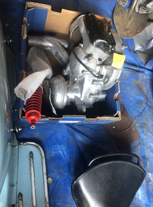

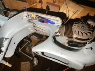

Here is the engine super clean and ran when it was taken off the frame[/img]

Random Internet Guy opinions follow:
The first thing to decide is if you will rebuild the motor. If it spins, has compression, and you are confident the seals/bearings are good, then you might as well fill it with oil and try to start it. If you can find a friend with an engine stand that will be hella easier than mounting it in the frame.
On the other hand, you didn't say how mechanically inclined you are, so apologies if this is condescending. These motors are really simple, so if you WANT to dig in and learn to work on them this is a great time to split the case and overhaul it. It looks clean, so you won't be getting grease and grime everywhere.
I would recommend against painting your first scoot. The prep is key and takes forever and then some. It sounds like that's what hamstrung the last owner. Plus you'll scratch it all to hell putting it back together for the first time. I think the blue looks nice and will polish up fine. It's not a particularly rare scoot, so painting it isn't going to increase its value.
So is it a 3 speed? It looks like you have the split headset which is somewhat rare. Hopefully you have all of the pieces to that.
P.S. If you intend to ride this, I recommend investigating the fork/shock upgrade. The front suspension on that bike is flat out dangerous. "Keeping it original" isn't worth it in this case.

Thanks man! All great advice. Yes the headset is complete! I am mechanically inclined but have little experience. I had a 64 gl150 in college and it always needed something so I learned a bit but I have a steep curve for sure but I'm looking forward to it! Yea I will try to get an engine lift or jack or something to try and fire it up before mounting it.

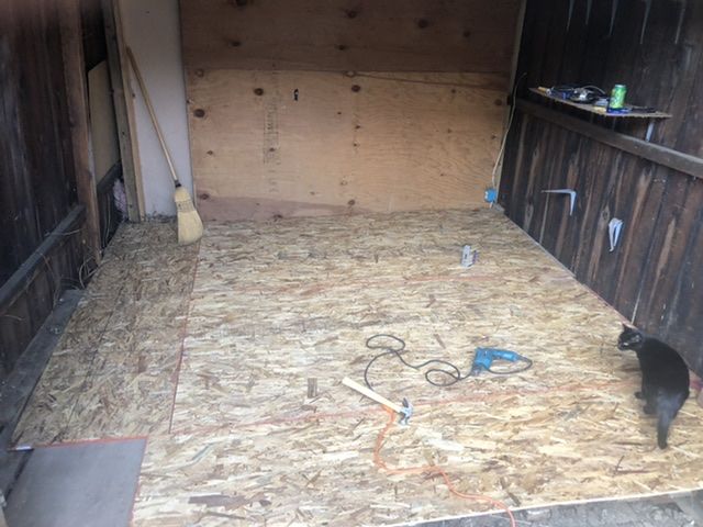

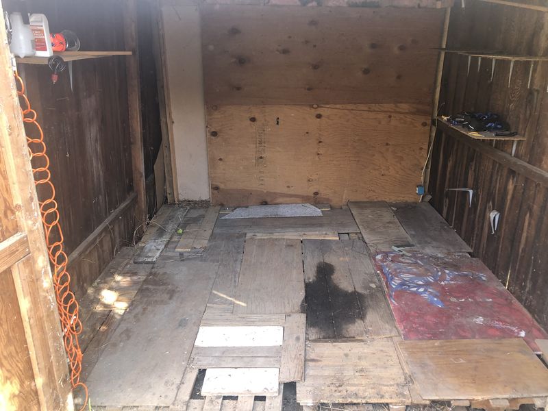

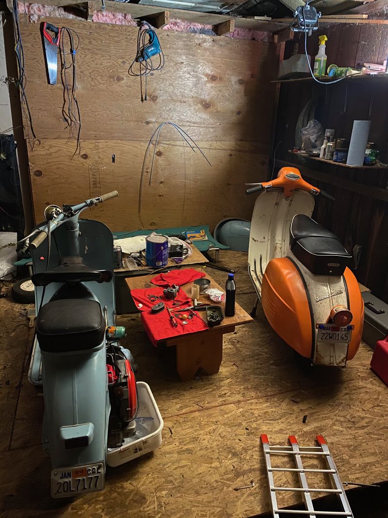

Looks like I have to put in a plywood floor. First things first!
Posts: 10050
Posts: 10050
Hmmmm... Well OK, looks good, but I'd maybe get a decent FIRE EXTINGUISHER too ?

Well day one was on the shop! And yes a fire extinguisher is on the list!

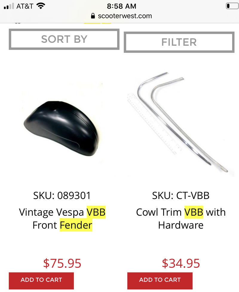

So I forgot it is missing the front fender if anyone knows of one available please let me know. Otherwise I was gonna get this one from scooter west. 75 bucks. Thoughts?

That allstate did not have cowl trims and that same fender is cheaper here: http://www.scootermercato.com/Scooter-Parts/Fenders/89301

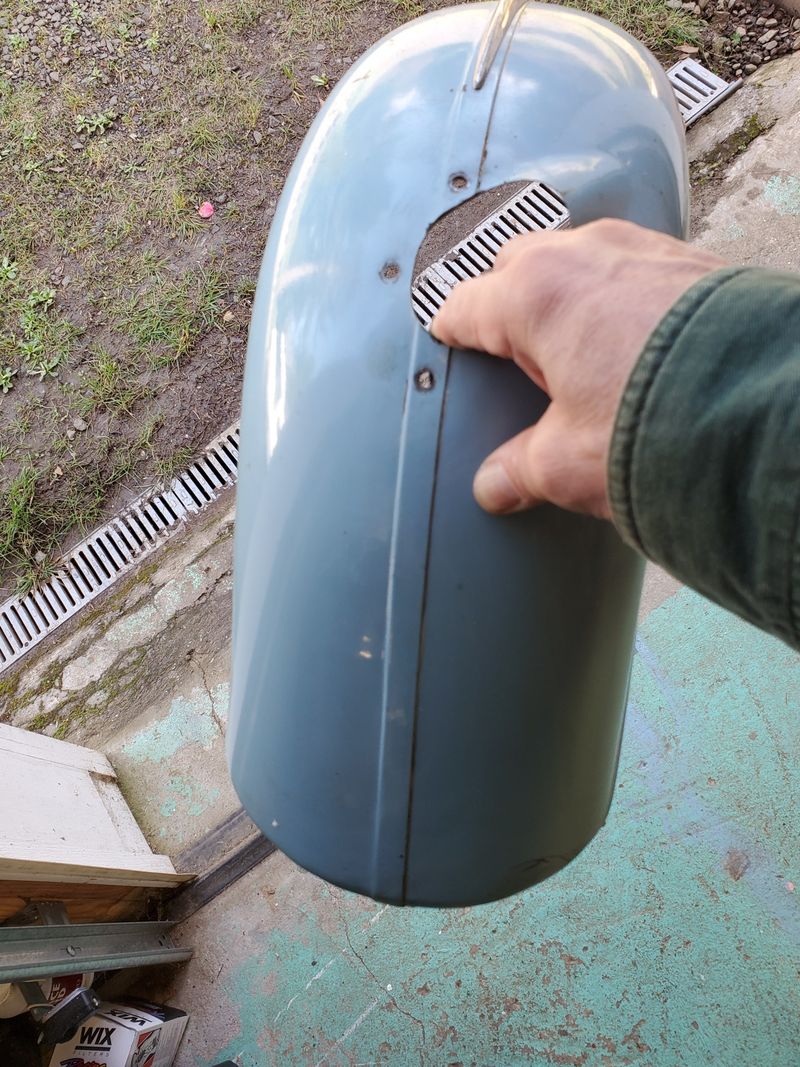

Didn't that year's Allstate have the seamless fender?
From my limited understanding, the early blue Allstates (late 50's) had seamless fenders and the last batch (early 60's) had a fender with a seam in the middle and crease on the sides but no trim.

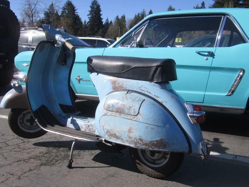

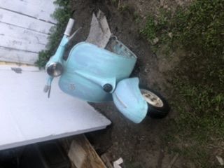

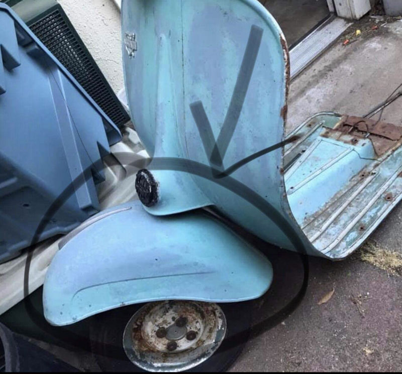

Found this. It's a 62 and appears to have a seam. Not sure if I will drive 2 hrs for this one or get the one off scooter mercato. Upside is I can get the speedo off this one
@rowdyc avatar
Posts: 1347
@rowdyc avatar
Posts: 1347
I'll drive the two hours and get it. Those original speedo's are getting expensive and the repops can be a hit or a miss with quality and usage. May get lucky and he has something else you may want.
Good luck!

Seam
Mine has a seam and it's a 62. And if it was me, I'd get the used!
If you can get the entire front end assembly for a decent price and can use the parts I would get it. Might have a few nuts bolts and other parts you can use. When your done you can always sell the spares or horde the extra parts.

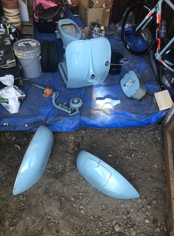

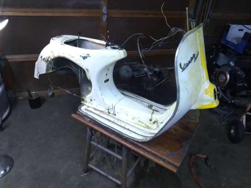

I got the used one has some great extra parts too. Cowels And tank and it has the whole front end intact. [/img]

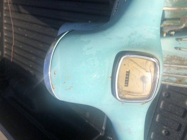

Also a cracked but original speedo

Wow, score CD - that's awesome!

Sweet score on the speedo.
I may be interested in the engine side cowl if your selling, and it isn't too roached. Also could use the headlight and headlight bezel if you're gonna part bits out.

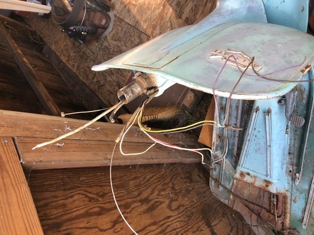

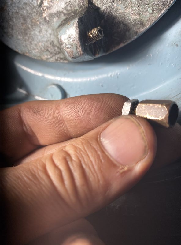

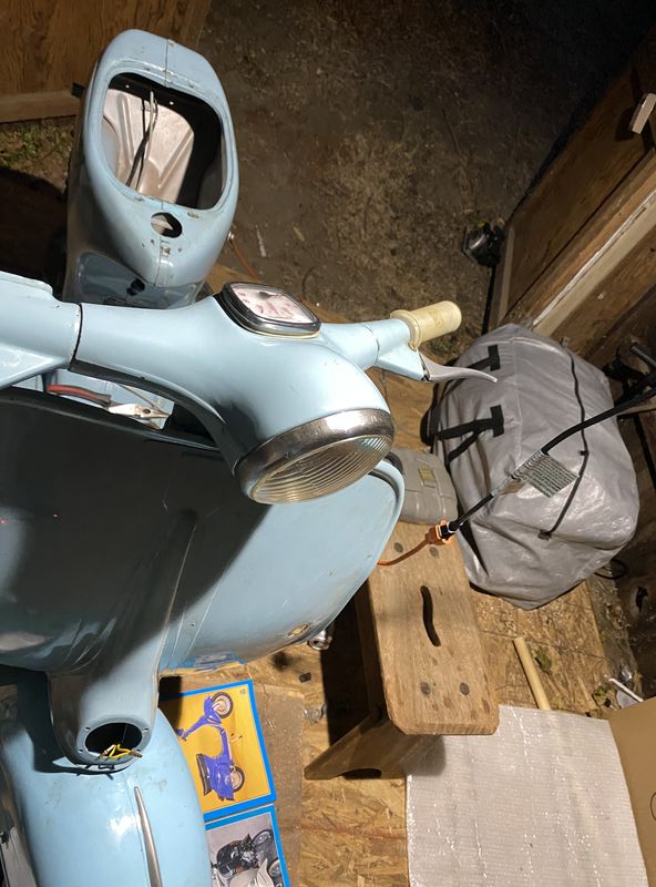

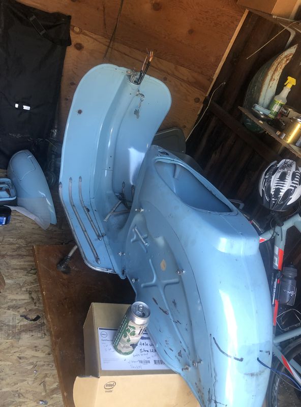

Got the headset off today, that took a while to figure out and I had to be rough with her, she was not wanting to come apart! This is from frankenvespa the parts scooter (getting the fender )

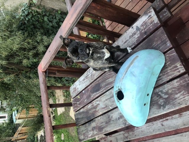

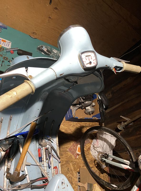

It was a tough battle but after a hard fought victory I have only minor injuries (hammered thumb and bruised foot from dropping the front end on it!) luckily my fender sustained no such injuries!!

That's awesome you don't see the 2 piece headsets often now you have two.

Good job on the fender!

philosophical question: do I paint the fender a similar color to the original 62 cruisaire blue ( can i find an exactish match) or paint it a different cool color?
