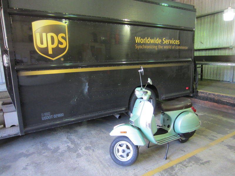

So I just wanted to add an update to this project. Unfortunately all the replacement pistons I'm finding are for low compression early model PX's so I reached out to Hot Rod Al for advice. He's going to help me fit an oversized smallframe Polini 57.8mm piston into this cylinder. I'm not sure what black magic it takes to make that work, but the thinner piston rings and rings closer to the top work better in higher revving engines. I wanted this project to be special and its definitely getting that way!
Hopefully in the next few days my piston will be delivered from SIP and i'll have more updates and pictures for you all.
2 new Meteor pistons look exactly like the one on the left. Old piston on the right.
1mm off the top.
1mm off the top.
