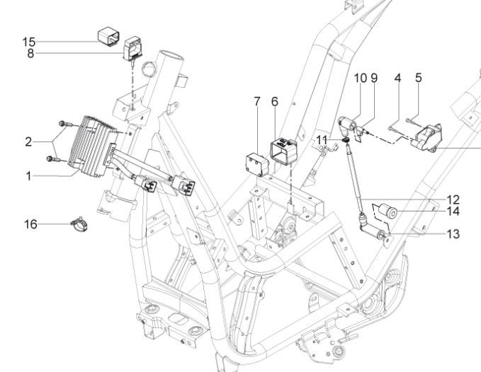

You're correct. Apparently the BV comes with a mechanical flasher, as I see from the electrical and parts drawings. (It's too cold to actually look at my scooter! Crying or Very sad emoticon ) Anyway, the flasher is located in front of the steering tube (#15 in the drawing).
I found lots of "LED turn signal flashers" on the 'net but there are many shapes and sizes. I couldn't tell which would fit the BV.
