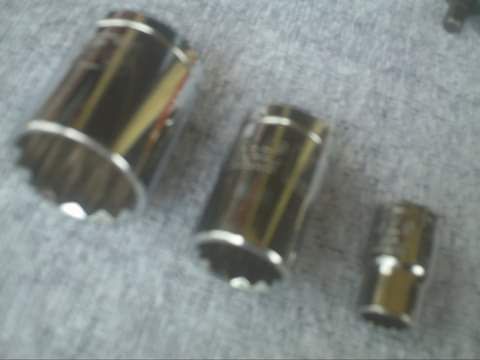

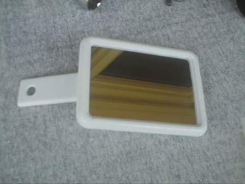

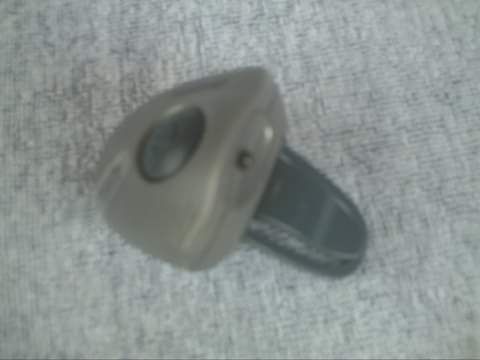

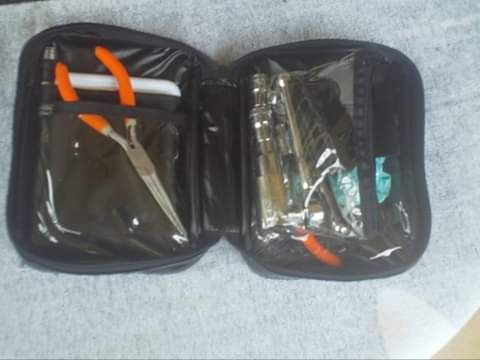

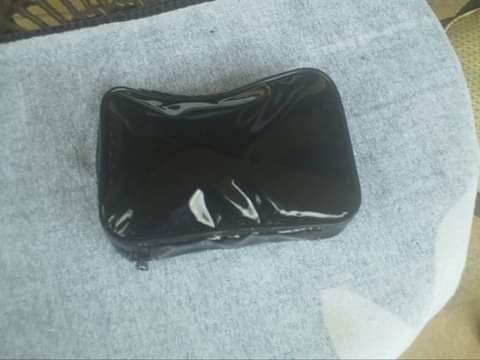

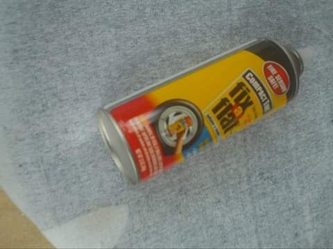

Nothing like The sensational minimalist tool kit.
Here's my newbie cursory kit from 10 years ago:
