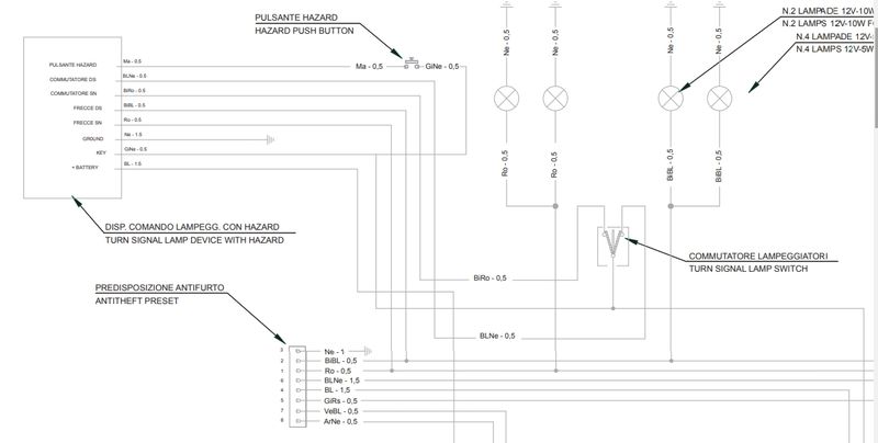

Smart warning control unit? That the flasher relay?
Posts: 45116
Posts: 45116
"Turn signal lamp device with hazard"

Is there a diagram to test flasher unit?
Posts: 45116
Posts: 45116
I don't understand what you mean...
gilera fuoco 500ie
Posts: 60
Location: Northampton uk
gilera fuoco 500ie
Posts: 60
I meant the flasher relay
Posts: 45116
Posts: 45116
What diagram do you want? I assume you've downloaded the wiring diagram...
https://manuals.wotmeworry.org.uk/Gilera/Gilera%20Fuoco%20-%20MP3%20500/

Thanks I think I have it sorted at least temporarily. It was the blue wire.put a tiny hole in side of relay and threaded wire through.just wound around pin as bit too fiddly to solder.ran to battery.not much room at back of bike to put relay anywhere else, may put some silicon around top of connection.
