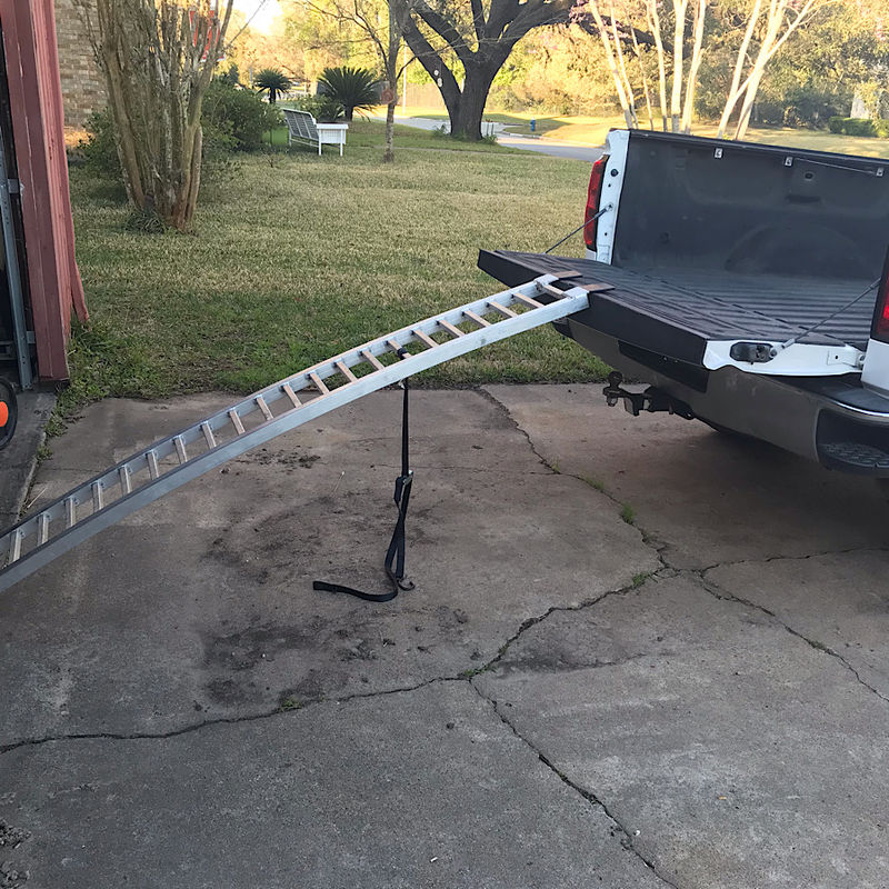

Hi Doug,
I no longer have a pickup, so I sold the ramps. Mine were a Harbor Freight ramp that folded in the middle, making it easy to store the ramp in the bed of the truck. That ramp was JUST wide enough to be able to walk the scoot up. It was also helpful to load in a spot where I could use the curb as a highpoint for loading (less steep).

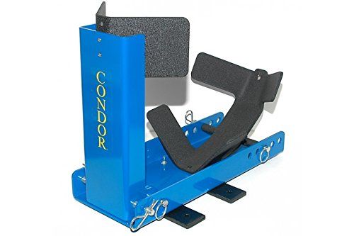

We haul our scoots in a cargo trailer. Captive chocks that hold the front wheel in place; straps run forward from the grips. Rear wheels strapped down to prevent "hopping" or side to side movement. We have towed thousands of miles with this method, with no issues.
The HF chocks are a knockoff of the Condor style; been using those for about 10 years now, with motorcycles and different size scoots. Can't beat 'em for the price.
https://www.harborfreight.com/1800-lb-capacity-motorcycle-standwheel-chock-61670.html
I've used that chock on its own in the back of a pickup, and with the cross-ways support removed and through-bolted down in the trailer.

Canyon dancers, Condor chock, channel, and rear wheel tie down. I have equipped a light trailer so it will handle two scooters. I load on a ramp which stows under the trailer. Has all worked fine so far.
CONDOR SCC-4000 Scooter Chock -

I used 4 12"x 2" boards with ramp kits on them laid out next to each other and road it into the bed. Think they were 10' long as the truck sat little higher than stock.

Guilty. I used to tie down the front, the back, and both wheels when I used one of those hitch mounted ramps that carried the bike across the back of the truck. Over time and hundreds of miles I began to think this was overkill. If I use that carrier I strap the handlebars and the wheels to stop any side to side and all up and down motion. I use no straps on the rear. In fact, straps on the rear will harm the paint. Nowadays I use Canyon Dancers and the bed of my truck. Totally effective over hundreds of miles. One strap for each handlebar works fine.
I'm interested to know more about how you get the machine up and in to the truck bed .
I'm planning on going to a few rally's this summer . Need to decide if I'm better off with a U-Haul rental or getting my Vespa up into the truck bed.
Toyota Tacoma Pre Runner , it's pretty high.
I have looked at several types of loading ramps but wonder how you break down the ramps and stow them in the bed. ?
Do you have the triple wide ramps and just ride up and pray you don't topple over and can stop ok. ??
Thanks. Doug
DandyDoug
Here's the ramp I use. Just a single and it's quite easy to guide the bike up. Just measured it, it's about 80" from the base to the extensions that rest on the tailgate and has a slight bow. It's longer than my bed but so is the bike. I use one strap to secure it so it doesn't slide out before I get where I'm going. Canyon Dancers with bar end weights removed and a couple straps to the tie down points at the front of the bed and I'm secure.

I use 2 methods for hauling w my truck.
1. A condor chock mounted to plywood that rests in the slots of the bed liner. Soft loops & straps to each corner of the bed. I use a ramp to get the scoot in/out of the bed. Here in NC it's not hard to find some incline to help take some angle out of the ramp
2. VersaHaul
3. Combo

The Condor scooter chock I use holds the scooter in place. The canyon dancers are used just to prevent too much swaying. I've seen some people just use the chock but I prefer a little cross strapping and I strap the front tire to the chock so a big bump can't accidentally dislodge it.
