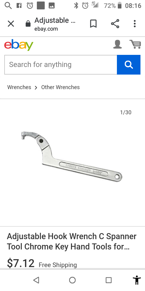

So I'm in the market for a new suspension c spanner for the GTS 250.
I have come across this one on Amazon but I am not sure what size to get.
Could somebody please measure the one that comes with a brand new Vespa and let me know.

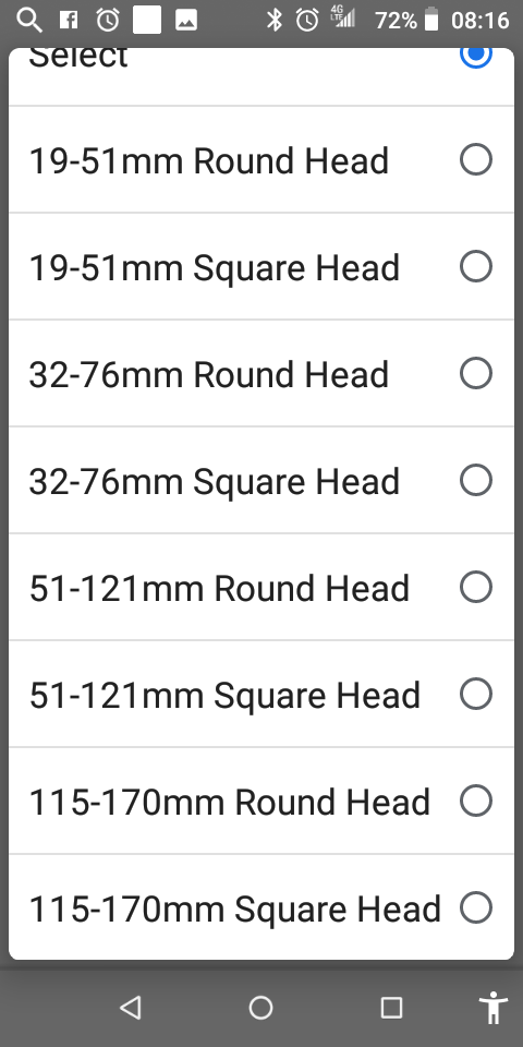

Open, go through and close three doors to get to garage.
Find $1.50 plastic calipers.
Measure shock ring. ~50mm
Open, go through and close three doors to get back to laptop.
Write this post.
This indicates you want the 32-76mm adjustable.
Write this post.
<Alt><S>
Square or round head?

S.Ro wrote:
Write this post.
<Alt><S>
Thanks Jim. The one in the picture is round.
Posts: 45640
Posts: 45640
I'd buy square, but round would still work!
Before you buy though, remember there is not much room for the tool around the shock ring - even the OEM tool is a fiddle to fit and use.
