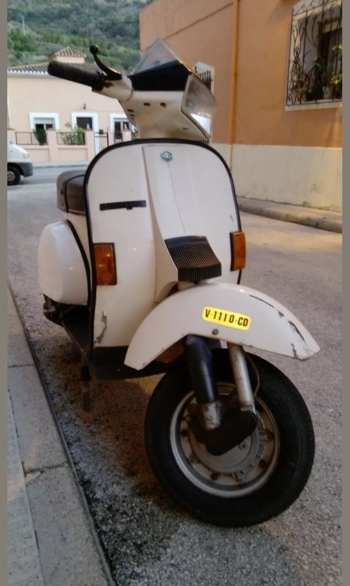

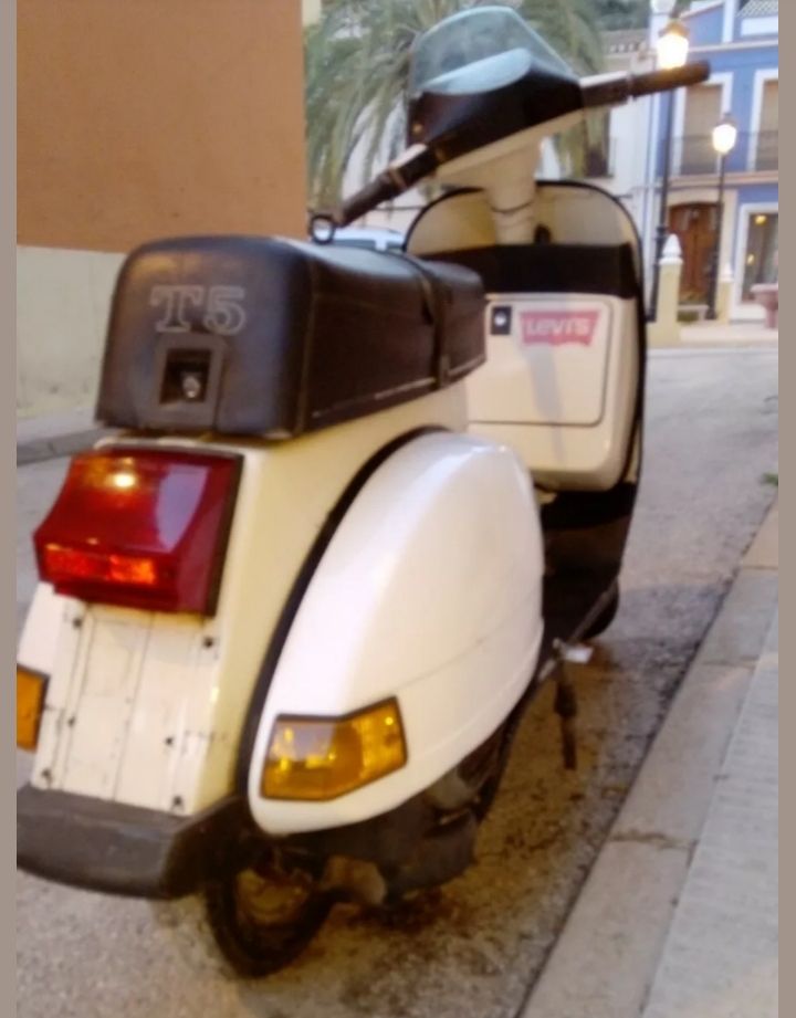

I have taken a huge leap of faith and purchased this from a chap in Spain, based solely on the images shown (plus some words about missing components)
I dont intend a full blown restoration which will in effect make it a custom scooter. I'm intending to leave the paintwork and is with some patch tidying so the vehicle wears its age with pride.
Engine strip and rebuild, stainless bolts all round and a general overhaul of the bike

Right on. That looks like it will be a blast.

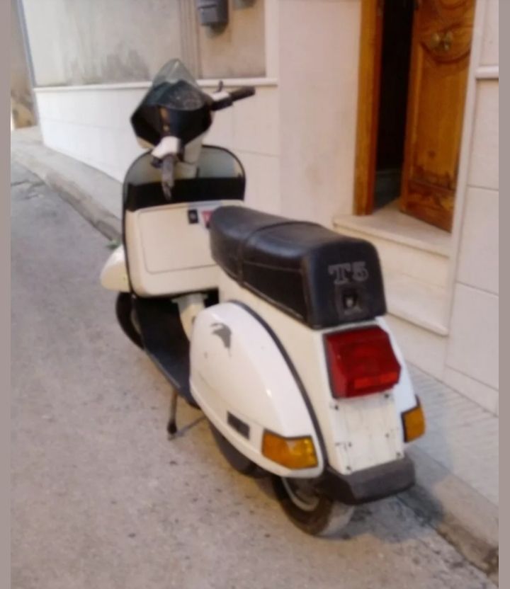

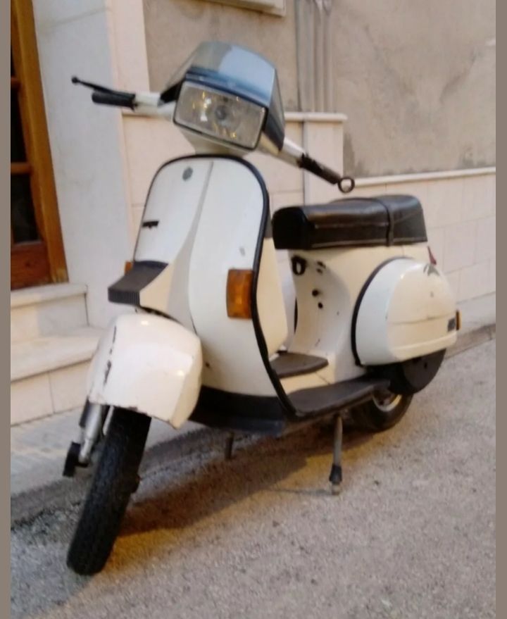

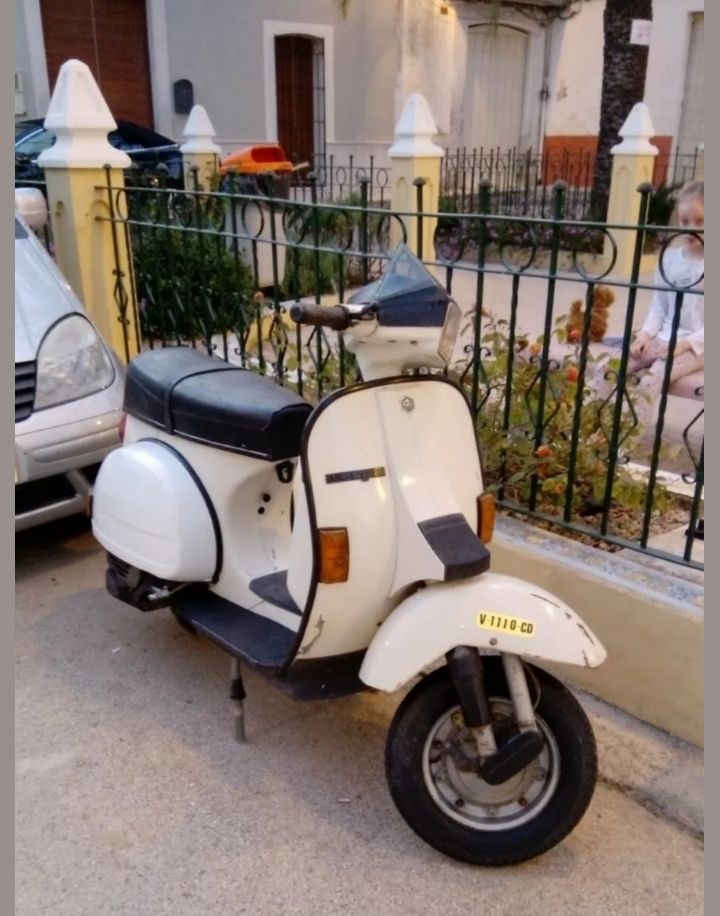

just adding a few more photos of what it currently looks like - before it lands from the courier

CONGRATS! Looks like a solid Scooter!

i would not touch a damn thing on that cosmetically. do the necessities like tires, tubes, cables, shocks, rubber, rebuild the motor and call it done.
a well sorted T5 is one of the best city bikes you'll ever ride.

GONGRATS!!! Another T5. You'll definitely love it. I reluctantly bought mine but I immediately changed my mind when I rode it. Although it's a P/PX series frame, it rides completely different...

awesome. jealous! Who knew they issued a levi's branded T5! ha.

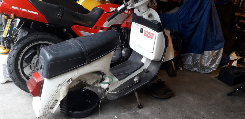

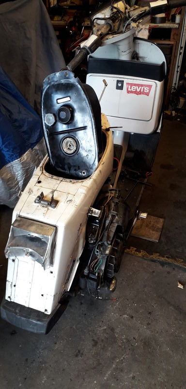

Taken the opportunity of the lockdown to do a couple of jobs on the T5
stripped and rebuilt the carb - although it wont idle without the choke on - i suspect a blocked idle jet or idle jet circuit.
swapped out the well dodgy and broken finned flywheel for a spare set i had - which will also lead me to rebuidling a couple of my other stators over the weekend.
took the headset off to see why the switches werent working.... to find out they were damaged and or not connected, so swapped out the lightswitch for one i bought for another scooter and didnt get to use.... still no joy. swapped out the regulator... houston we have lights and a horn
oh swapped out the petrol tank for one i had in my bits pile....... remembered why it was in the bits pile............ tap was leaking.
photos attached

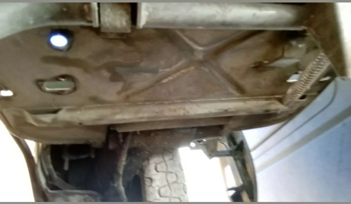

Loving the T5. The floor looks great from the underside. I'm always a bit concerned about water getting trapped under those fixed mats, but yours looks good. The benefits of a life spent in Spain!

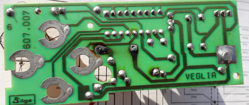

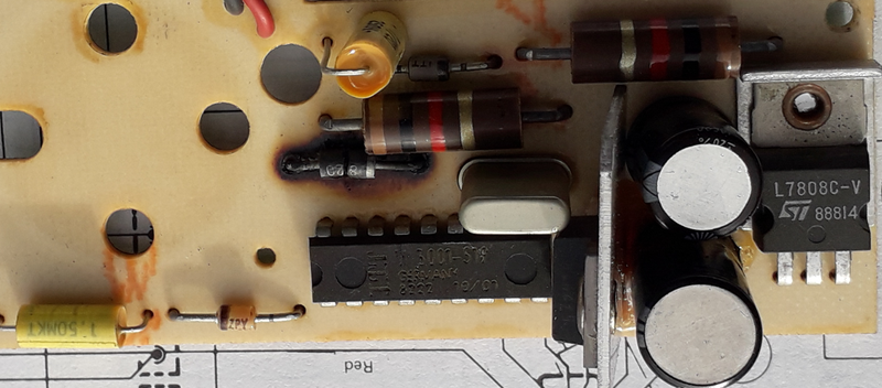

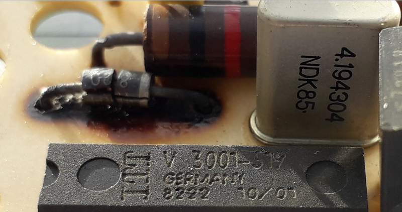

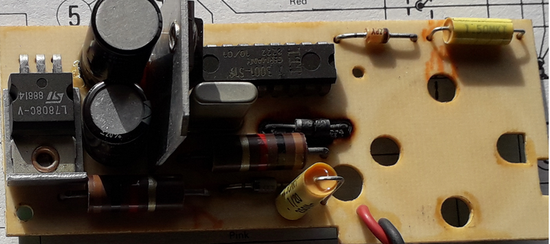

Took the dashboard apart on the T5 as the rev counter isnt working
NO SURPRISE THERE
noticed a blown diode - although on this particular bust speedo i can see the remnants of what i think is a switching diode
photos to follow

images as promised
has anyone on here tried to repair one of these?
am i correct that this is a switching diode that is blown?
is it worth the time to attempt to repair or is it likely to be beyond repair as the AC/DC breakdown will have been caused by an alternate component on the board failing and im looking at it repeating again the moment i attempt to feed the bikes voltage through it?

I have a brand new analog speedo. I'll take some pics for you. Also check the following thread and p.m. Frank N. Stein since he's a member here too...

Well it looks like i have found the root cause of why this thing and many others have fried.
there looks to be bridging in the solder across the voltage regulator which in turn feeds the voltage direct to the diode.
the transistor will be fried as well..... so its off to hunting spare electronic components from online stores.
should i manage to repair this one - i will be offering a repair service for them i think
it helps when you have an older brother who is an electronics expert - albeit in another country.... the wonders of modern technology eh?

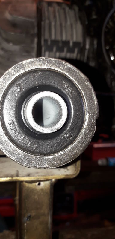

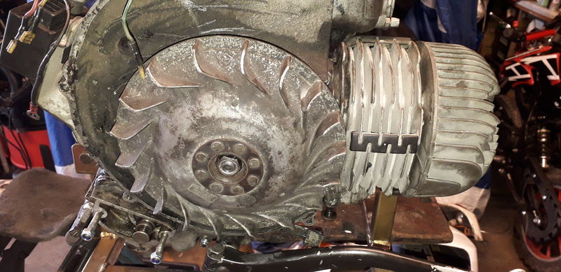

After i had pulled the engine out and rebuilt with new seals, bearings, rebuilt cush drive etc etc etc

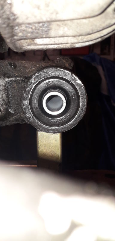

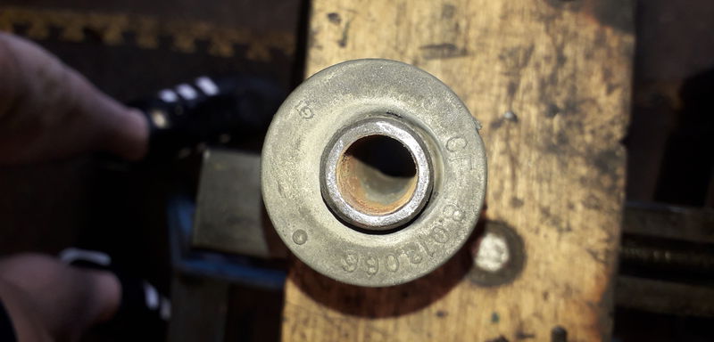

I found i needed to do something about the state of the silent blocks. I had a set of BGM 200 ones and wondered if these could be used, there appeared to be some similarities so i asked a question here
T5 Engine Mounts
Received some helpful advice and confirmation i could use the 200 silent blocks - albeit with some modifications.
Photos below
Photo of the perished engine mount
Kickstart side fitted with new modified BGM silent block

Rebuilt engine with new seals etc, didnt want to make this a pristine clean job as it was against the ethos of the bike
Paella burner sat with its new boots on ready for the engine to go back in...
