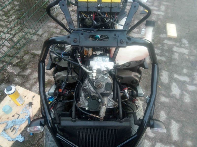

Front compensator valve

Plumbed in front compensator valve
