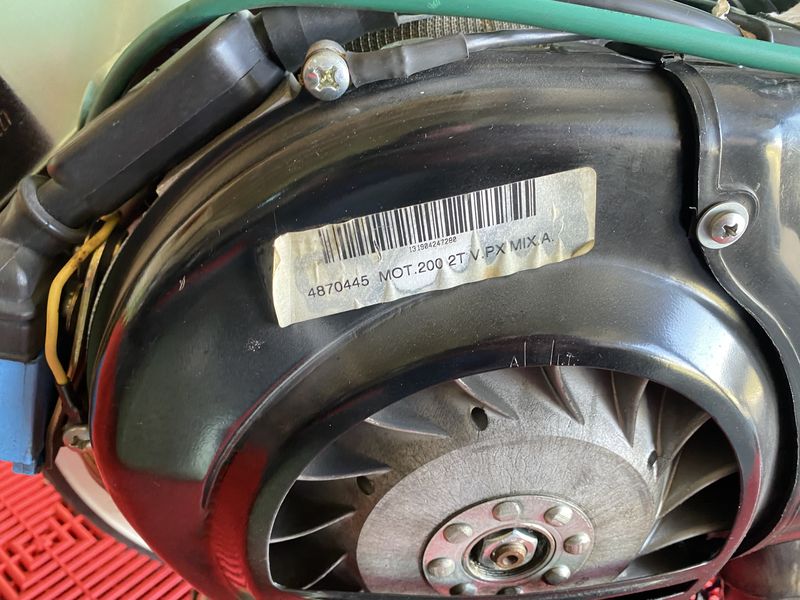

Hey everyone. A few months ago I bought a low Mike '05 PX150 series America. I've been tinkering with it since the weather is warming up, trying to get it tuned. The engine cover has this sticker on it. The bike had a bunch of misc mods on it. Curious if an engine swap was one of them?
Here's a pic of the engine.
parallelogramerist
Posts: 6160
parallelogramerist
Posts: 6160
That paper sticker came on all the '05 PX150's. Normally they just decompose off the shroud over time. That engine looks all stock from what I can see.
@safis avatar
Posts: 5297
@safis avatar
Posts: 5297
That's a PX200 motor. Part code (4870445) confirms that. Take a pic of the exhaust near the kickstart...

Definitely a 200 and I also see an aluminum cylinder so it's also kitted (Malossi, Pinasco, etc.). Very nice...

WTH! That's crazy. It explains why this thing isn't running right as I try and tune it. I assumed it was a stock '05 PX150 with an exhaust on it. It sat for years. I bought it from a millionaire collector from NYC who kept it at his beach house in the Hamptons. I replaced the fuel line, fuel tank, and fuel selector valve. Disassembled the carb and replaced the jets with jets that would work well with a 150 engine and a slip on exhaust. It has run like crap ever since. Acting very lean last fall when I bought it, so I parked it for the winter.
Guess I need to start over and very all the carb components.

Since there's the part code I mentioned on the flywheel cover, it's a complete PX200 crate motor that was put in. Piaggio used to sell them as spares. They are still some available here and go for 3,5k euro. You definitely got a deal there...
