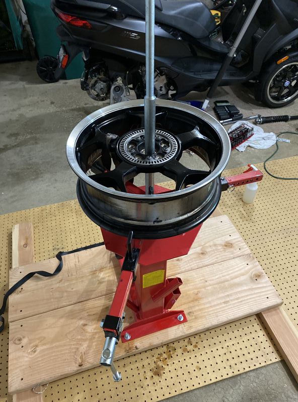

I finally decided to change my rear Tire on my MP3 500
Michelin City Grip 140/70-14 $85.98
Multi Tire changer for Motorcycle 4" to 16.5" $155.11
No-Mar Tire Changer bar/rod $160.65
Elbow grease $0
I was using the harbor freight Tire changer before
Finally decided to buy a better Tire changer and buy the No-Mar Tire changer...what a difference
Almost $320 investment but it's a one time cost that will save me money and time.
⚠️ Last edited by reticulum on UTC; edited 1 time
No-Mar Tire Changers $160.65
Elbow grease $0
You mean you got the No Mar tire removal/install bar for $160?
Because I got a deal on a used No Mar Tire changer and it was still $600 for the tire changer
I got their bar/rod only for $160. My tire changer is something different but I wanted the No-Mar bar... which I believe is the best tool to use if you don't want to damage your rim.
